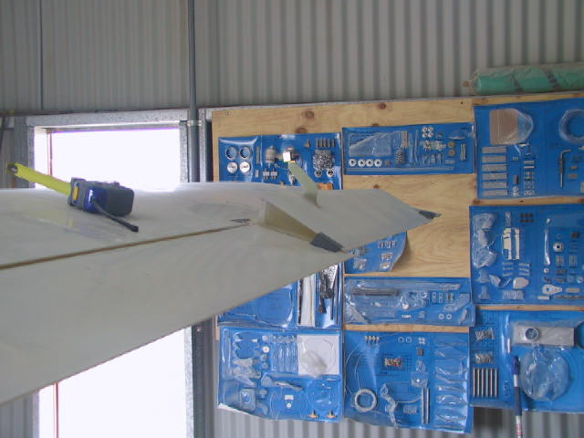

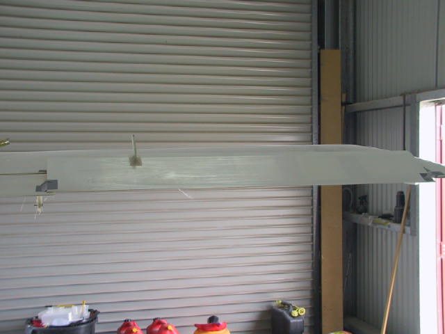

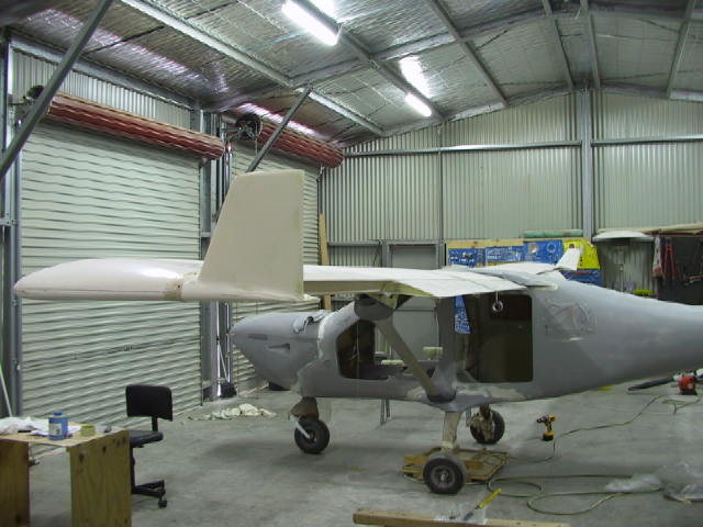

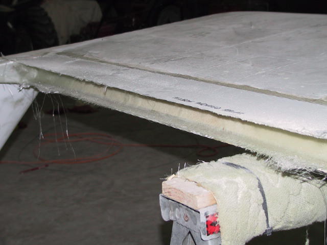

Wings are back on and am preparing to trim outer end of the flaps, with aileron taped in place.
Also establishes final position of cut-out for aileron control cable.
[ATTACH]262[/ATTACH]
[ATTACH]263[/ATTACH]

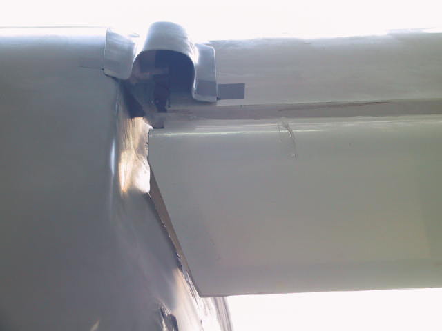

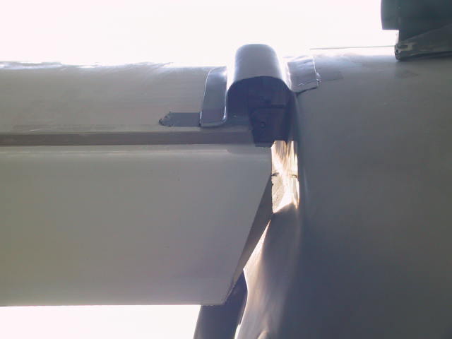

Also .. preparing to cut inner edge of flaps to clear fuselage
[ATTACH]264[/ATTACH]
[ATTACH]265[/ATTACH]
Flap positions before trimming.
[ATTACH]266[/ATTACH]
[ATTACH]267[/ATTACH]

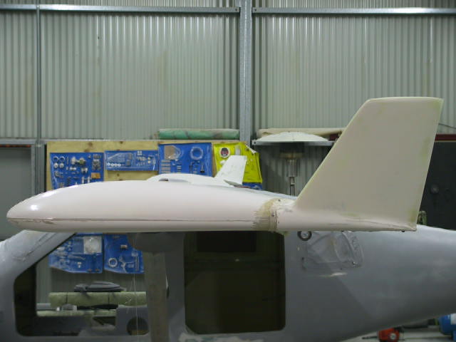

Flaps are shaped, trimmed, complete, and move thru their complete travel.
Wing root Fairings are bonded onto the fuselage. That is key as once I get that faired in tomorrow or Wed, then the fuselage undercoating can be completed and the fuse sent off for final painting ..... so a tentative "Yipee".
Have also bonded on those signature winglets ..... so that feels like progress.
Once I get the wing root fairings completed tomorrow, it is on with completing the ailerons.
Regards Geoff

The wing root fairing and undercarriage fairings are complete and have been undercoated today .... as has the area around the cowl .... see pics below, so with a little more fitting of door locks, the fuel and cable penetrations at the wing root, the cowl attachment screwsand a couple of rub backs next week,it is still on track for final painting of the fusealge on Sat 25th .... fingers crossed so that I haven't forgotten too much else.
Regards

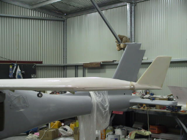

G'day Ross
That Bear is in charge of Security during the build ... but as you can see in this pic, the lazy bugger hasn't moved for a while. The bog and undercoat dust looks like snow on him.
Once the build is complete he is moving up to be security chief on the property and will then hopefully become a tax deduction.

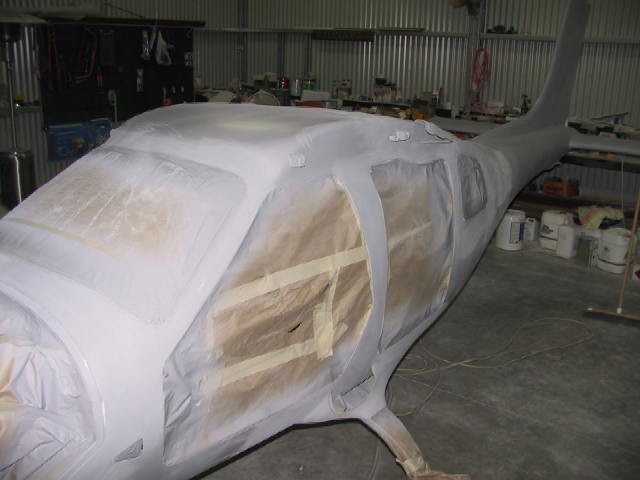

Over the weekend I glassed in the aileron attachment plates and have cut one back ready to attach the aileron hinges.
The rest of the fuselage has been given a rub back and a little touch up today, ready for final spraying on Saturday.
Regards Geoff

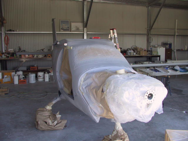

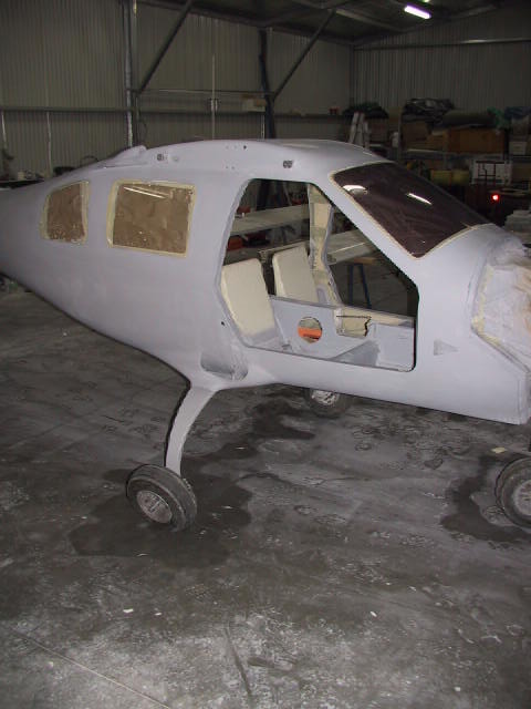

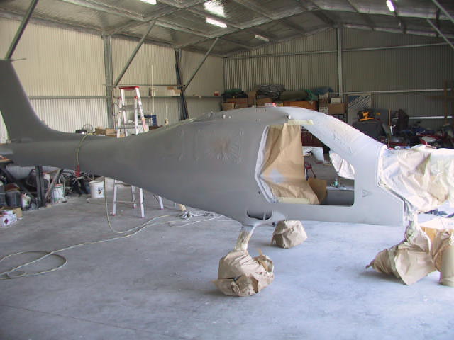

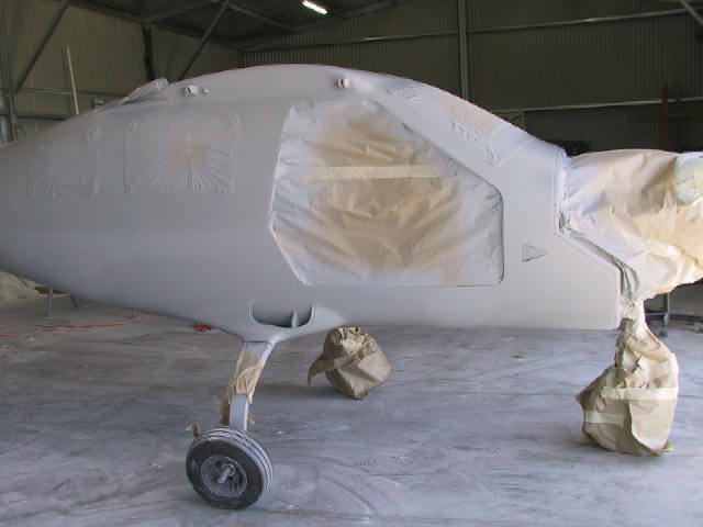

A disappointing last couple of days. One of the spray painters is crook so had to cancel the final spraying of the fuselage yesterday.
BUGGER.
They need 2 guys spraying to get the best possible job and keep it all wet thru-out the job, so have now booked the booth for Wednesday night ..... fingers crossed.
The bear is not happy ......... and neither am I.

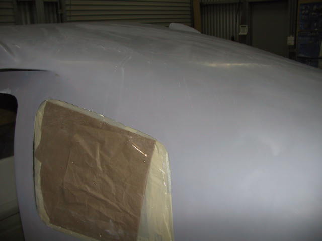

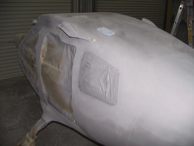

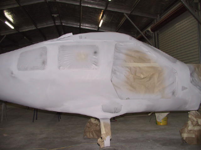

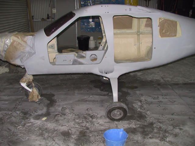

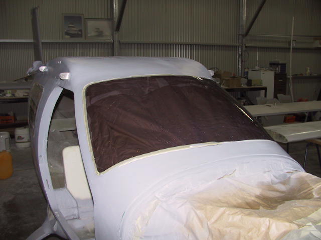

Used yesterday and today to do some more final rubbing back with real fine paper and to touch up around the door locks.
[ATTACH]284[/ATTACH]
[ATTACH]285[/ATTACH]

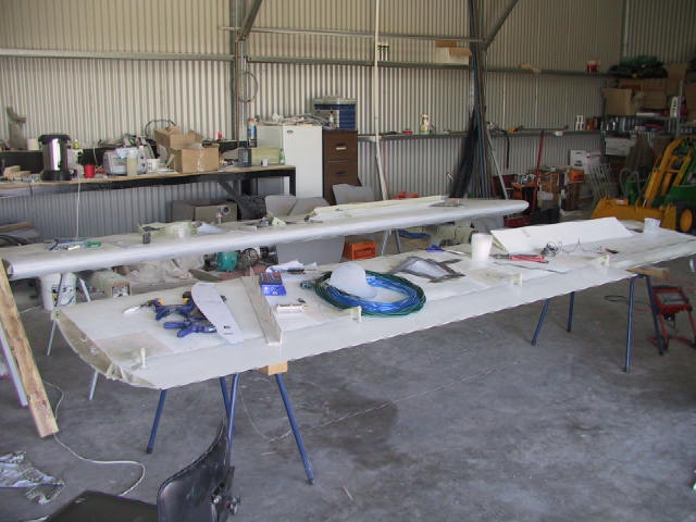

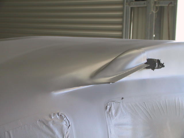

But have been able to make more progress on the wings ..... and finally found out the easy way to get the strobe wiring thru to the wingtips when there is no drawstring installed to the wingtips at the factory (not their fault - I didn't order it).
[ATTACH]286[/ATTACH]

Am now waiting for this morning's glassing to dry, so given the weather today I think I'll spend more time here, wash off the bog and gelcoat dustand listen to the cricket. I wonder when Ricky will declare?
Might move the wings over here this arvo.

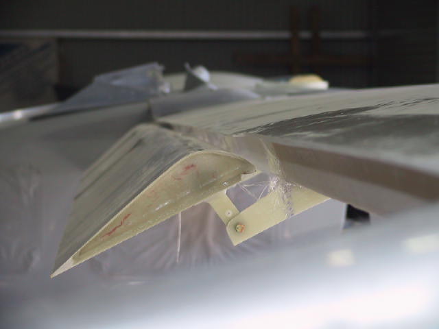

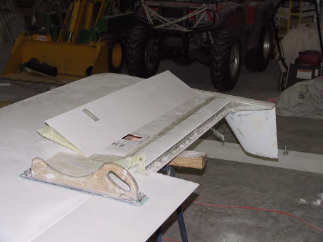

You inspired me, so spent this morning finalzing the Aileron attachment and glassed in the hinges before it got too hot, save for one bloody hinge leaf ..... see builder's tip No2 below.
Have also marked out the fuel filler and fuel drain positions and plan to drill the holes and attach those tomorrow.

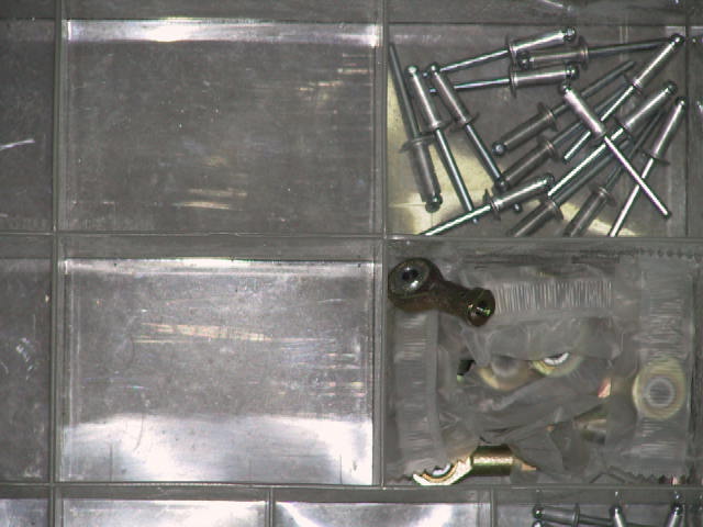

Now for Builder's Tip No 1 ................... get one of these .... and fill it up with plenty of Tom Petty and Steve Earle. You almost don't notice that your arms are dropping off while sanding.
[ATTACH]294[/ATTACH]
And Builder's Tip No 2 ..... don't let your grand kids into the shed because I can guarantee that they love to play with big rivets. Because I am 4 short to attach the last leaf on one aileron hinge. Get on your bike, Mr Postman, from Bundaberg.
I bet the kids had a great time with those 3/16 rivets. Can't wait to find out where they put them when I drive around the paddock in the landcruiser.

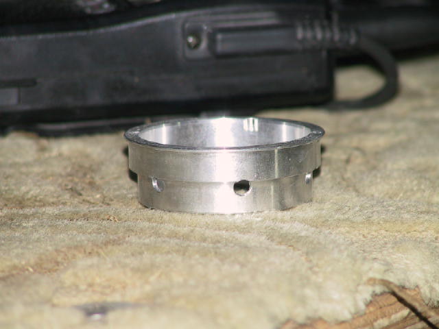

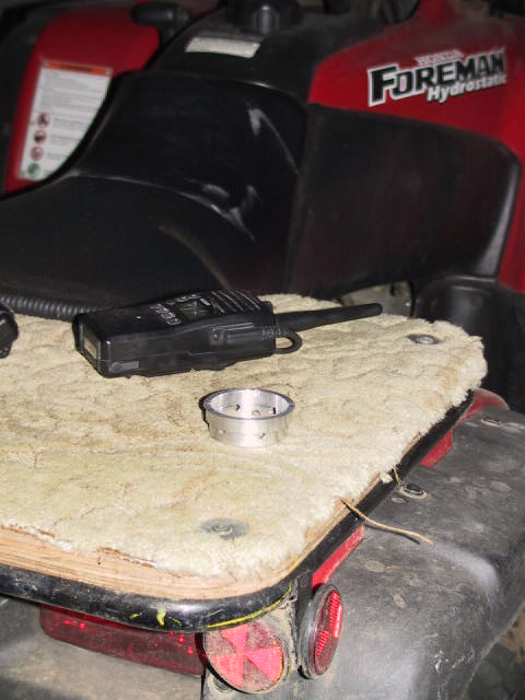

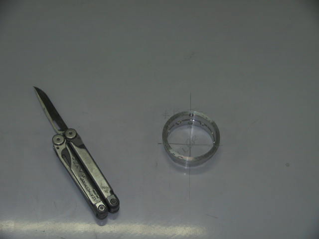

Below, FYI,are 2 pics ofone of myfillers.
Were yours stepped like this and to this degree?
The instructions say to open up the hole in the outer skin so that plenty of floc gets to the tank skin ... which is of obvious importance for sealing etc. It looks like the outer holes will be about 3/16" bigger dia than the inner.
Is your advice to keep the hole tight for the inner hole in the tank skin or the outer hole as well?
Except for the hole in the filler to which the tank breather pipe is attached, I assume that the rest of the holes in the pic are for keying the floc in and around the filler.
In all of my previous activities I have been concentrating on getting fuel tanks not to leak, and here I am about to drill 2 whopping holes in each of my perfectly good 70 litre fuel tanks. Goes against the grain a little.

The problem with the fillers is that there's no "void" between the two skins. Looking at the filler, it looks like the difference between the outer skin is about 10mm, however there is only a gap between of probably a mm or 2. Therefore the "step" in the filler is next to useless.
Cut a tight hole, throw in some flock and throw it in. The holes in the filler are supposed to be so you can squeeze some flock in them so that they are held in secure. They probably aren't really needed and you will find that you probably can't actually use them.
Check and re-check5 times before you drill the hole...
Once you've drilled the hole, stick your (or the grand kids) hand in and feel around. I think in their wisdom the tank manufacturers put a hole in the tank where the filler is supposed to go, however when the tank it put into the wing skin there is no way to know where the hole is, so when it's drilled, feel around and there might be a hole. If so, try filling this with flock, otherwise when the tank is full you might end up with fuel between the skin and the tank... I hope that makes sense.
FUEL DRAINER - If you haven't done this, please take note because nearly everyone drills through both skins!!!!
There is little if any void betweek the tank and the wing skin, contrary to the instructions. Drill a pilot hole with the appropriate sized holesaw but don't go more than a mm or 2 into the wing skin. You will need to use your dremel or similar to carefully dig out the wing skin without penetrating the tank skin. Very carefully is the key to this operation. You could use a cylinder shaped die-bit and use it ina vertial fashion. If you use a wholesaw you'll probably just drill a 2 inch hole straight into the tank and you'll have to fill it all in later. Very messy. Don't do this! Don't become a statistic!

I should add that Clem's tips with regard to the drain holes are spot on.
When I initially put a pilot drill thru at those locations there was a distinct air space of 2 - 4 mm between the 2 skins, however there is actually foam between them in places (not everywhere and not where both my pilot drills went thru) and when you then put the hole sawto workto justpenetrate the outer skin, the foam holds the outer skin and it is difficult to feel when you have just cut thru the outer skin ..... but not touched the inner one.
I put tape around the outside of the hole saw to gauge it's depth and my result was just pure dumb luck. I had to then pry the outer skin piece away to break it away from the foam.
