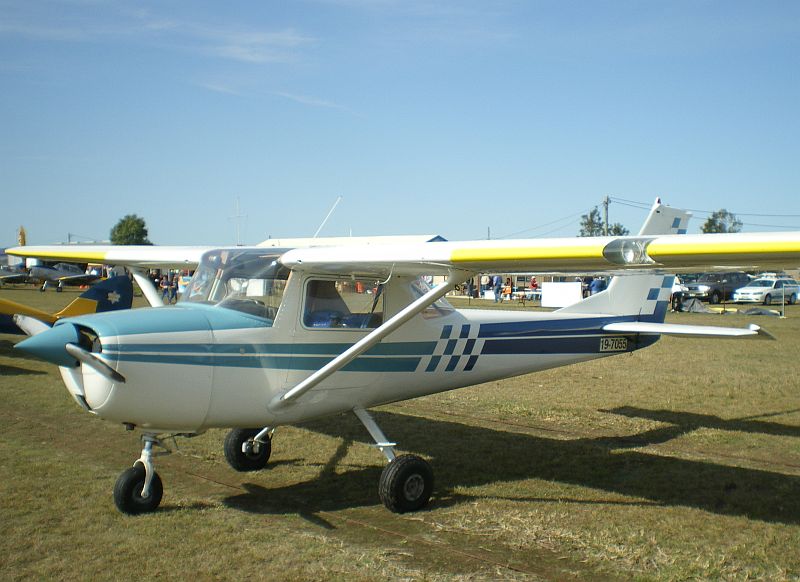

pete8862 Posted October 31, 2010 Posted October 31, 2010 Has anyone got any imformation on converting a Cessna 150 to RAA 19 rego I saw one at Watts Bridge & it made me think it might be an option? Pete
Spin Posted October 31, 2010 Posted October 31, 2010 This one? Looked like a nice aircraft. [ATTACH]12284.vB[/ATTACH] [ATTACH=CONFIG]19196[/ATTACH] I suspect it's one of those questions that you really don't want to ask:laugh:, I haven't got a POH with me, but internet references say between 447 and 504kg empty weight, which leaves uh, shall we say very little for pilot and a few drops of fuel at the current RA mauw.
pete8862 Posted October 31, 2010 Author Posted October 31, 2010 I have a photo of the same plane that i just got the rego no. from, is there any way to find out who owns it & talk to them?
dazza 38 Posted October 31, 2010 Posted October 31, 2010 Spin got it covered, i would buy a Texas T/W, converted one,if we got a decent weight Limit.At barnstormers ATM, there heaps of 150/152 a/c forsale. $20 to 40K with good times remaining.Cheaper than here, even if it cost 5 to 10 K to get it here and assembled.
Guest Crezzi Posted October 31, 2010 Posted October 31, 2010 I have a photo of the same plane that i just got the rego no. from, is there any way to find out who owns it & talk to them? Unless somebody on here puts you in contact, you'd have to ask the RAAus office - there's no online reference. Interesting that its 19 category - isn't that for kit builds ? John
pete8862 Posted October 31, 2010 Author Posted October 31, 2010 I checked that no. & it says that its a RAVEN HIGHWING??? Pete
Spin Posted October 31, 2010 Posted October 31, 2010 Sometimes google is your friend, but no ownership info comes up when I search. For myself, I would be a little wary of bringing this up with RA Aus, unless there is more weight than a seat and seatbelt that you can strip out of a 150, I can't see how they can register one at 544kg, all that will happen is the current owner is likely to get a please explain when re-registration comes around. I imagine trying to reverse to a GA registration would be a nightmare:black_eye:. Unfortunately there seem to be a few funnies lurking on the register - potentially very expensive ornaments for your shed unless/until we get a higher weight limit.
Bill Hamilton Posted October 31, 2010 Posted October 31, 2010 Folks, That's a C-152, not a 150 in the pic. I couldn't quite see the rego. in the pic, is it really 19-, that's RAOz Experimental?? The short answer is weight, as has already been mentioned. Amongst other slight impediments, you can't just declare a certified aircraft "experimental", and certainly ( unless you can show compliance with the 51% rule) not Experimental Amateur Built. Anybody thinking of buying an old 150 or 152 (or any strutted Cessna) beware of the high likelyhood of severe corrosion in the main spar leaves between the root attach fitting and the strut attach point. There is NO RELIABLE was of determining the corrosion, short of deskinning the wings and dismantling the spar section. Removing the tanks and visual/tapping doesn't cut it. I have seen a number, it's been really ugly, but nothing enough cubic $$$$$ can't fix, about AUD$8-10,000 per half wing. Cheers, Bill Hamilton
FlyingVizsla Posted October 31, 2010 Posted October 31, 2010 Found a picture of the same plane from a different angle at Aeroplane Images - Festival of Flight 2010/19-7055 Supposed to be from the Festival of Flight 2010. There are 115 other images of various aircraft. There is on C150M on the RAA register under 24-7267. Interesting. 7055 looks like it has 2 seats - I thought RAA C150's could only have one. Sue
dunlopdangler Posted October 31, 2010 Posted October 31, 2010 same plane was at Dalby during recent gliding championships and I watched it get fueled up at the avgas bowser..
Bill Hamilton Posted October 31, 2010 Posted October 31, 2010 Destiny, "home built/51%/amateur built" are all "Experimental", there is a great variety of what fits in the "Experimental" cat. Whether it is VH- or 19- Experimental, don't confuse it with the long since superseded VH- Amateur Built "Cof A", ( CAO 101.28?) which more or less disappeared in 1998, apart from some grandfathered "work in progress". When we put the 19- in place it was the AUF equivalent of VH- exerimental amateur built, to AUF weight limits. In my opinion, if somebody has a C-152 registered 19-, somebody else has made a mistake, it wouldbn't be the first one. Regards,
nong Posted October 31, 2010 Posted October 31, 2010 Sorry Bill , it's a one-fifty. Look at the cowl shape, circa 1966-68.
RetiredRacer Posted October 31, 2010 Posted October 31, 2010 I know a little bit about this plane, and I'll emphasize "little bit". The guy who owns the 152 bought it registered RAA. It is my understanding the aircraft was completely disassembled, and then re-assembled (years of work). It was re-built with the purpose of keeping it light, And being completely re-built, it met the 51% rule, and was no more a factory built aircraft. With the completely re-design and re-structure to "legally" meet the RAA requirements, it was no longer a Cessna, so hence the name change.

FlyingVizsla Posted November 1, 2010 Posted November 1, 2010 Gosh! I am nearly inspired to take a spanner to my C152. Regarding discussions about weight etc. I looked up my 152 book. Empty weight is 1112 lb or 504kg. Then you can start tossing out one seat 11 pounds, harness 1.6, control wheel 4.1, wheel spats & fairings 17, landing light 1.8, (we're down to 488kg) and still not get enough to allow for a pilot, oil and fuel. Ditch the 246 pound Lycoming for a 140 lb Rotax and we have 442kg. I might need a severe diet. But it would be lovely if I could make the transition. Sue

Bill Hamilton Posted November 1, 2010 Posted November 1, 2010 Folks, Have we decided that it started off as a 150 or a 152, I don't recall any 150 with a swept tail?? There still seems to be a divergence of opinion, but I an still voting for 152 --- tail, at least. If it's cobbled together, the cowls could well be 150. I still can't see how you could hollow it out to get under 544kg and still have any disposable load. Cheers, Bill Hamilton PS: A good mate of mine has a geenuuuiiine C-150, he and I can't fly it together, under the max. gross, even with no fuel in the tanks, we are over max.
