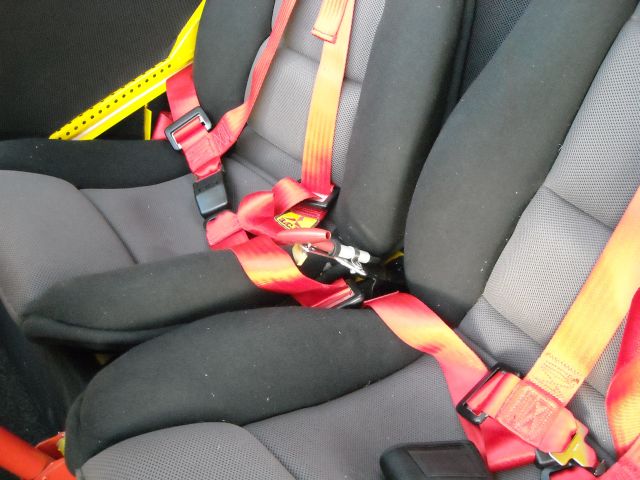

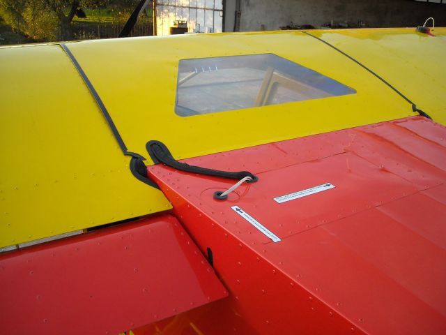

Kyle Communications Posted February 20, 2011 Author Posted February 20, 2011 Hi Steve Massimo sent me some pics of his although its a 475kg one. And I noted it looks like the extra baggage space was removed. The extra baggage space isnt a be all and end all for me...the mrs was asking about them and would feel more comfortable if we had one in it. I gather Reg has not fitted any yet?..the factory fits them on European versions and there is a law change there this year about compulsory use of themas in Massimo's message below which may eventually come here. The softpack for our versions would need to be the 600kg ones as I think over there they are only allowed 450KG MTOW that would be me and about 35litrs of fuel :(...glad ours is at least 544 Mark
Kyle Communications Posted February 20, 2011 Author Posted February 20, 2011 Hi All I asked Massimo if I could post the pictures of his factory install of the Lightspeed 501 softpack ballistic chute in his factory built Savannah so here they are for reference for anyone interested
