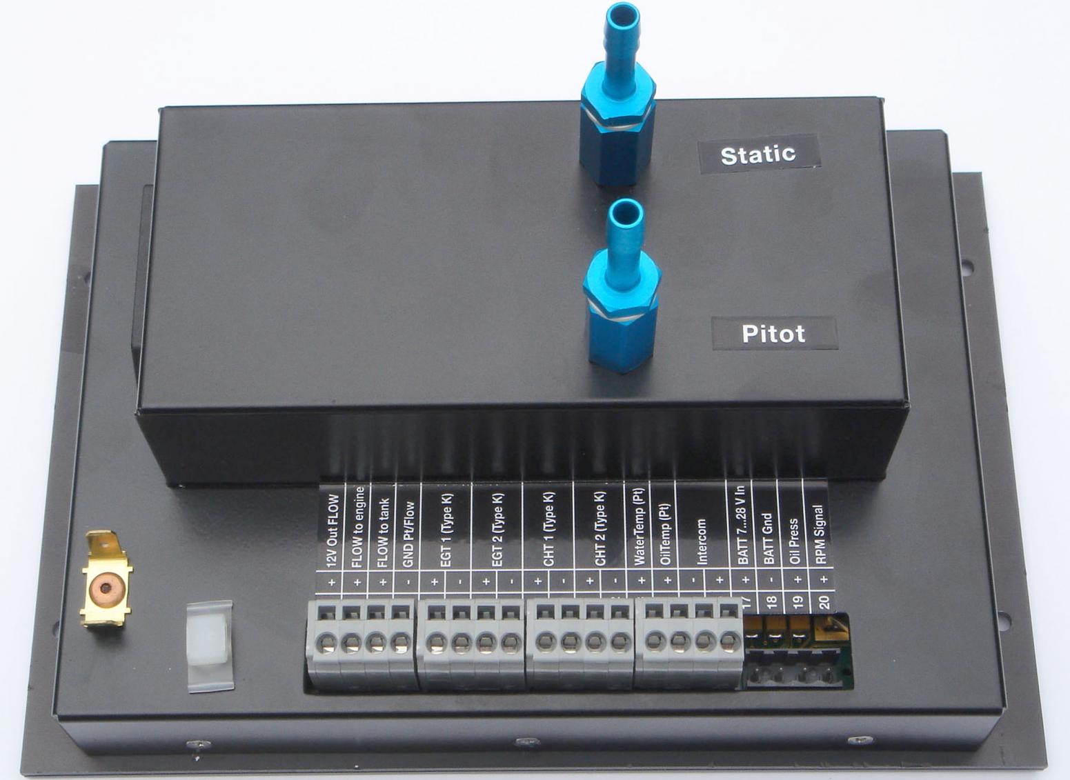

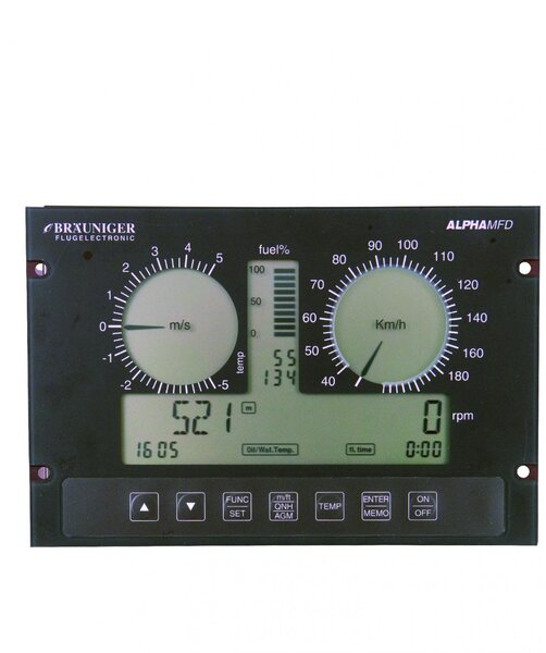

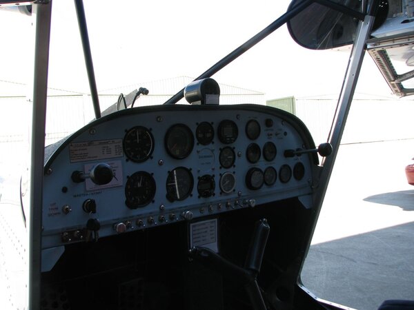

Kyle Communications Posted September 4, 2010 Posted September 4, 2010 Hi 80K Pic attached of a pretty standard Sav panel I think its pretty crowded. Mine will be a bit different. I am going to use a Brauniger Alpha MFD panel Bräuniger Flugelectronic (Products :: AlphaMFD :: Operation) it has everything in it and updates extremely fast. Some of the more expensive have a lag in their display. The only other gear I will have is a ball, fuel pressure and manifold pressure...a gps of course and a manual compass. This will save around 4 or 5kg in weight at least with wiring and instruments Mark

Kyle Communications Posted September 8, 2010 Posted September 8, 2010 The Brauniger Alpha MFD I have got does Airspeed Altitude Vertical Speed RPM Fuel highly accurate I am told done by entering the amount of fuel you put into tanks and it lets you know how much you have by computing what is left by using its fuel flow sensor 2 x CHT 2 x EGT Oil pressure Oil Temp and or water temp Time (real time plus date) (Engine hour meter that can not be changed by user) ( Flight time or engine running time per flight) Battery monitoring Backup internal battery in case of power failure while flying for up to 1 hr The unit only draws 35ma total High Voltage protection for ALPHAMFD To avoid damages by high voltage causing by defective voltage regulators the Alpha- MFD has since 2002 an integrated voltage protection circuit. In case of a defect voltage regulator the external fuse will fail and the ALPHAMFD is supplied by the 9 volt back-up battery – battery display is blinking now. After repair, please replace the defect fuse ( 150 … 200 mA ) Mine is the C version which measures from 24 to 130 knots Another reason I bought this unit is it connects to your intercom and all parameters it measures you can input a max and min value and when it reaches this value it will sound a alarm in your headset then also that unit of measurement will flash on your display so you know exactly what maybe going wrong before its too late and you should get no surprises you also must input the VNE in for the aircraft and the stall speed you wish to have as your minimum Mark
