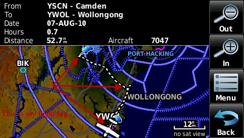

Ok, some pictures:

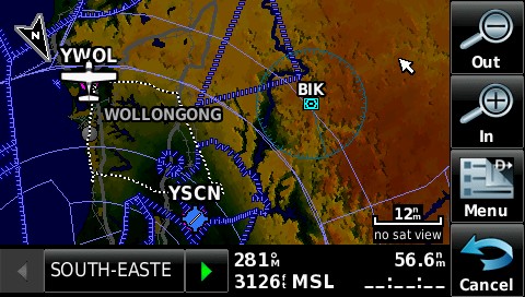

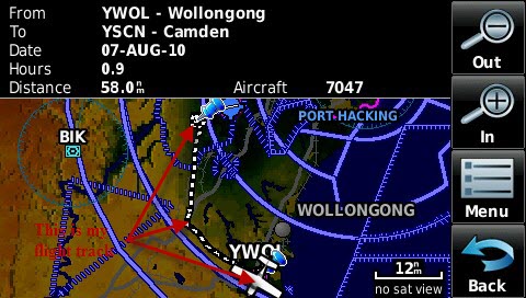

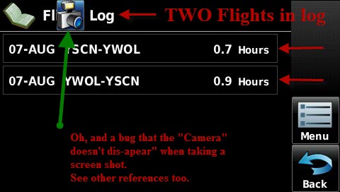

It shows the flights on the GPS's screen. Two flights.
It also shows the the GPS knows there are two flights.

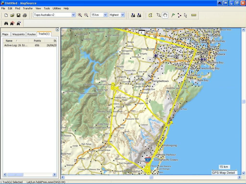

Yet, in Mapsource, the yellow track shown is what I get: A mish-mash of driving and flying.
