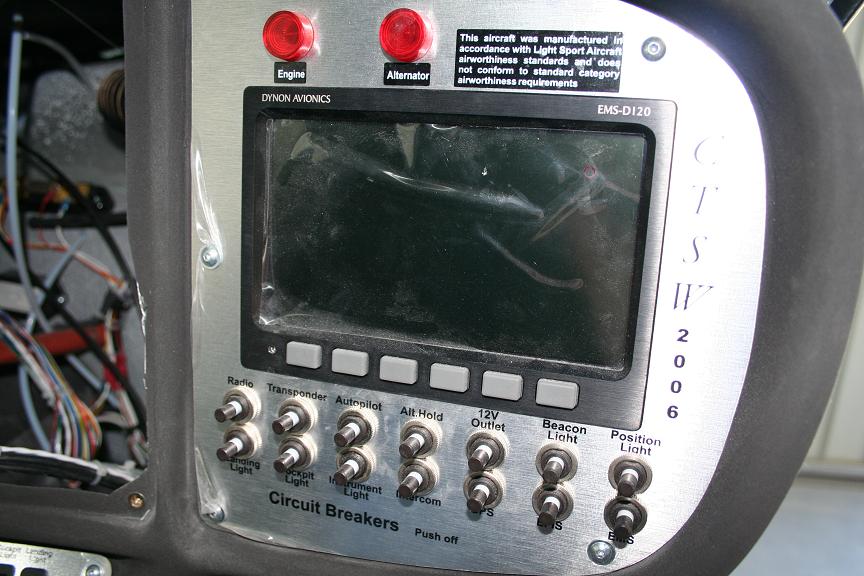

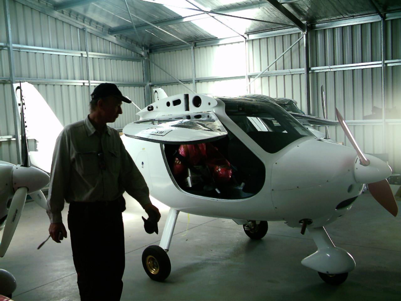

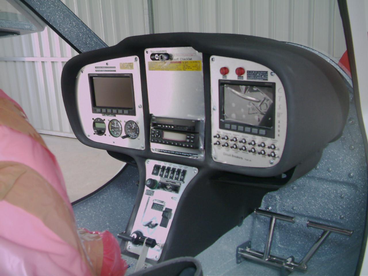

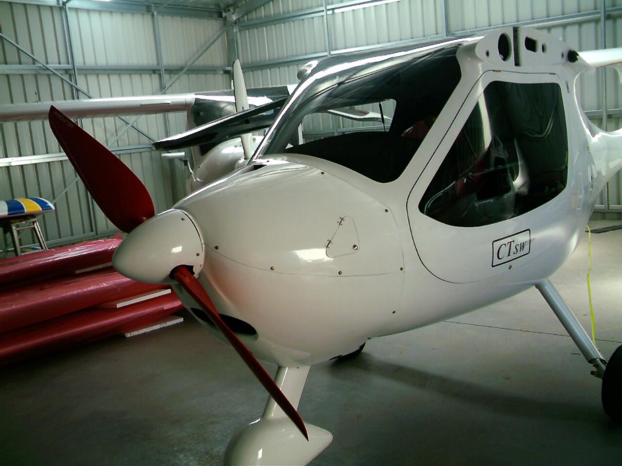

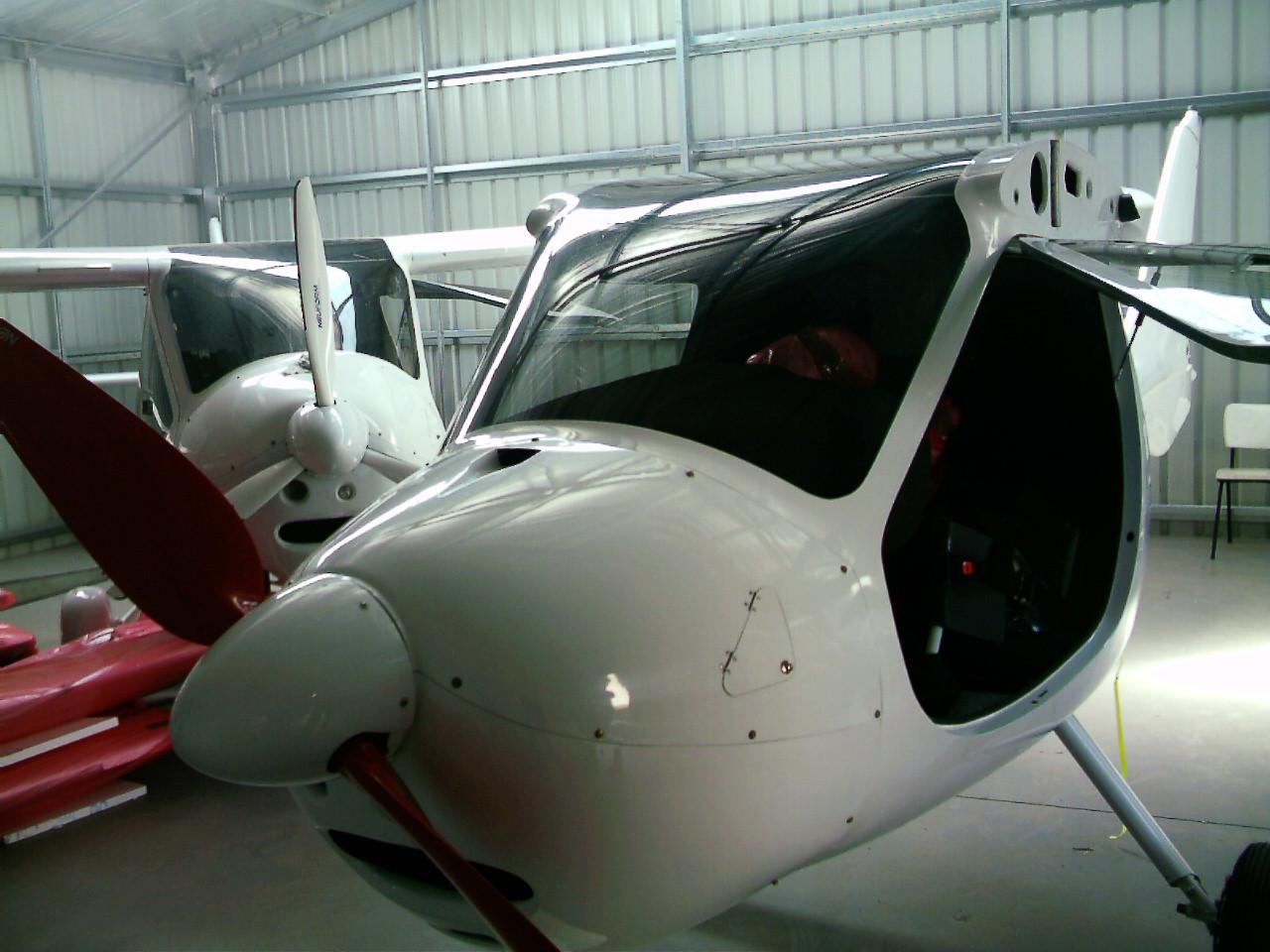

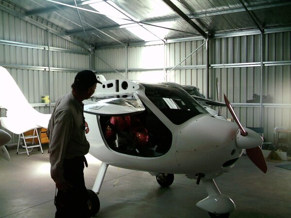

Guest AusDarren Posted January 25, 2007 Posted January 25, 2007 I have just received the phone call that Customs have released her and the transport company is trying to get a slot to have the container transported to Riddells Creek in Melbourne tomorrow (Wed). I had an Afternoon off work, so why not go for a drive to Riddle to see the new beast. Airfields can be just so hard to find on the ground.. Its so much easier from the Heavens. Found a very busy field at Riddles creek, Lots of maintenance happening, even new hangers under construction; Friendly People, Great Facilities. Ahh but where was the CT Hiding.. Spoke to a few People.. Eventually someone Knew that it was At Kyneton. Back to the car.. and off to Kyneton Airport is easy to find.. Lots of new hangers.. bulders building some more.. asked the builders had they seen a container go by..?? And YES! hanger right at the end had 3 very nice looking CT's inside.. So Ian I beat you to it *grin* here are a few photos Ian I think you should consider a GPS for the panel.. you really need to work on those position reports.. *chuckle* Regards, AusDarren;)

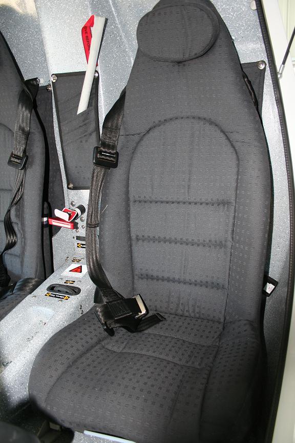

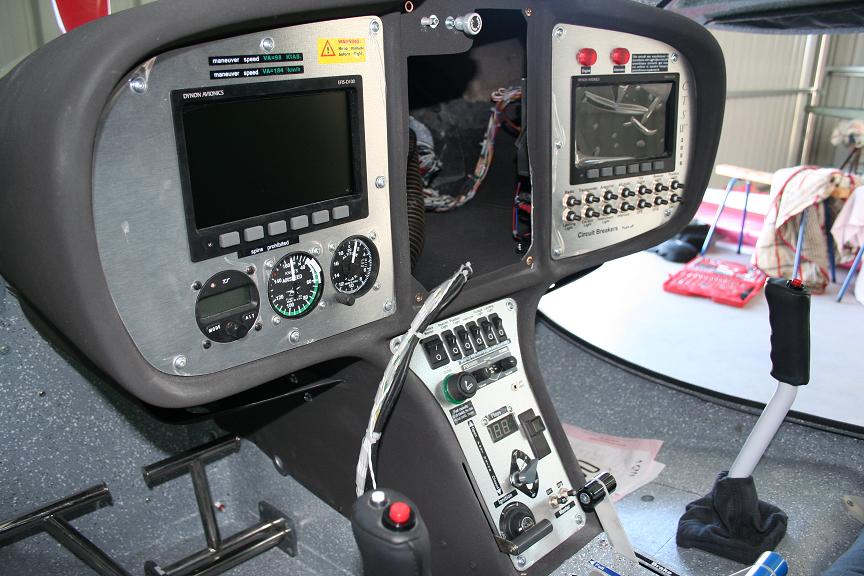

Admin Posted January 25, 2007 Author Posted January 25, 2007 YOU MONGREL - Wow Darren, what can I say but a HUGE sincere thank you for that ;) So that is what she looks like and seems there is just enough room in the panel for the new Avmap to go in. There was some conjecture on whether the new high back seats with the headrests were going to be leather or not - do you see if they were? You have made the pain of being up here in Port Mac so much more
Guest AusDarren Posted January 25, 2007 Posted January 25, 2007 the seats did seem much higher than others I have seen I'm afraid I didn't notice if they were leather they were partially covered. Was the only one with a two blade prop :-) I'll have to have another peek once all the wrappings are off and the wings on.. I'm just very envious.. Regards, AusDarren
PaulN Posted January 25, 2007 Posted January 25, 2007 There was some conjecture on whether the new high back seats with the headrests were going to be leather or not - do you see if they were? I dunno, I think the orange plastic look suits her just fine Ian. Isn't this your style? Paul

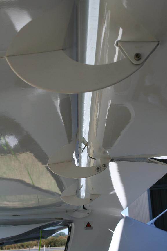

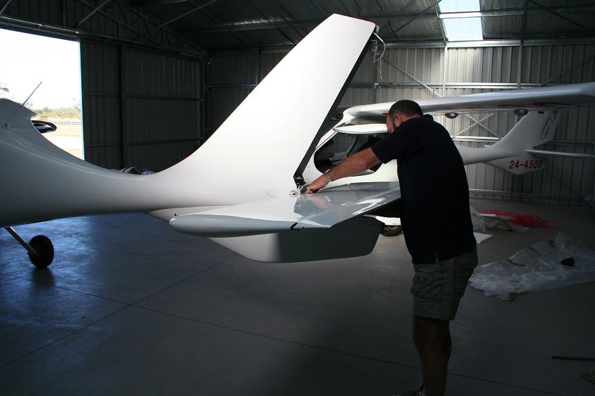

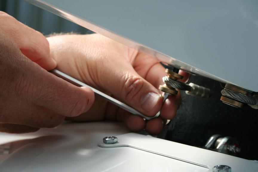

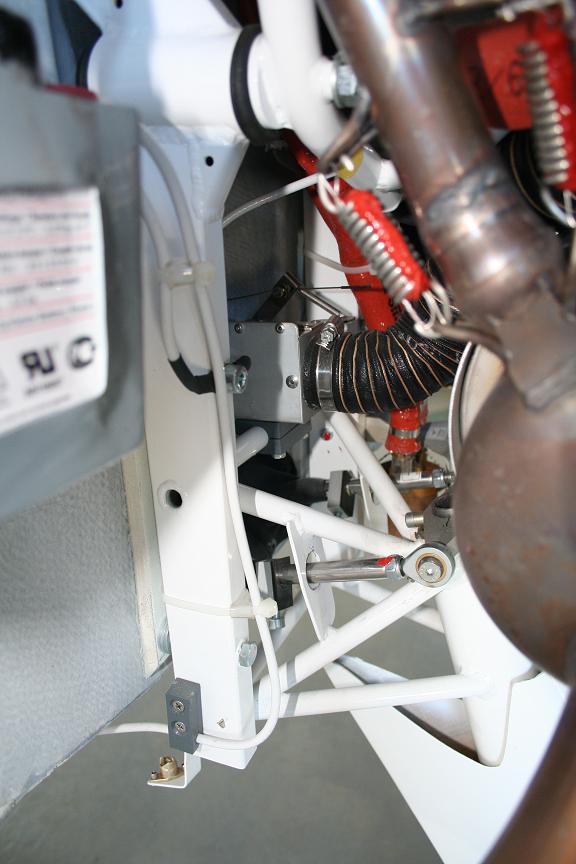

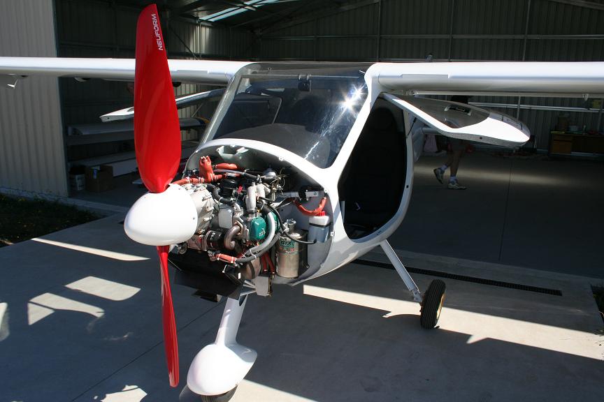

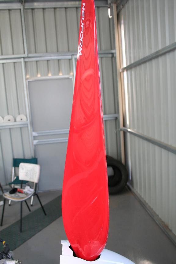

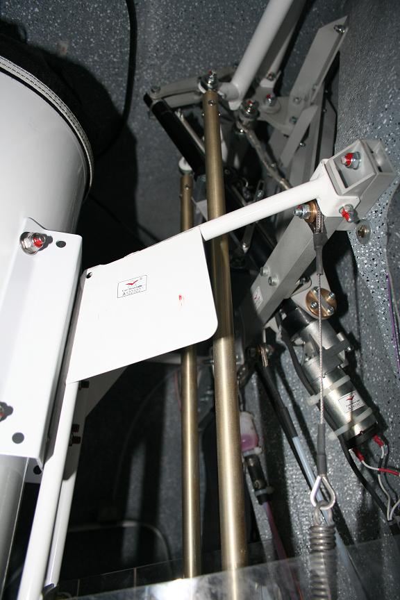

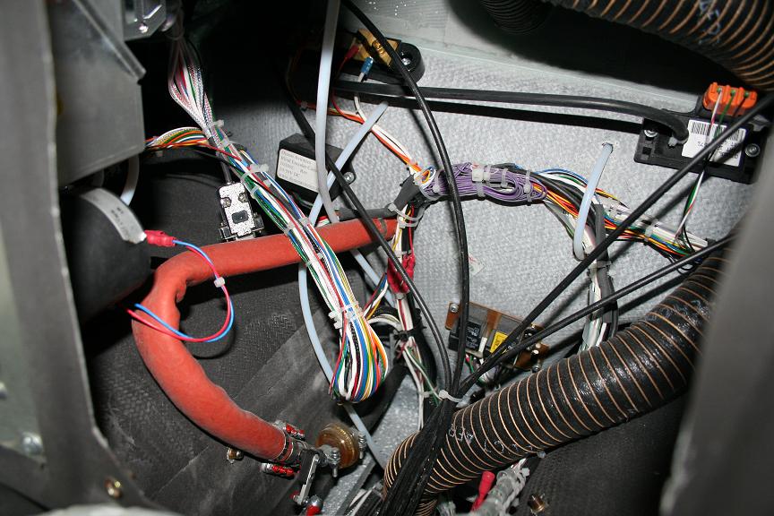

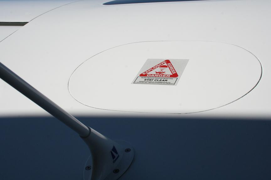

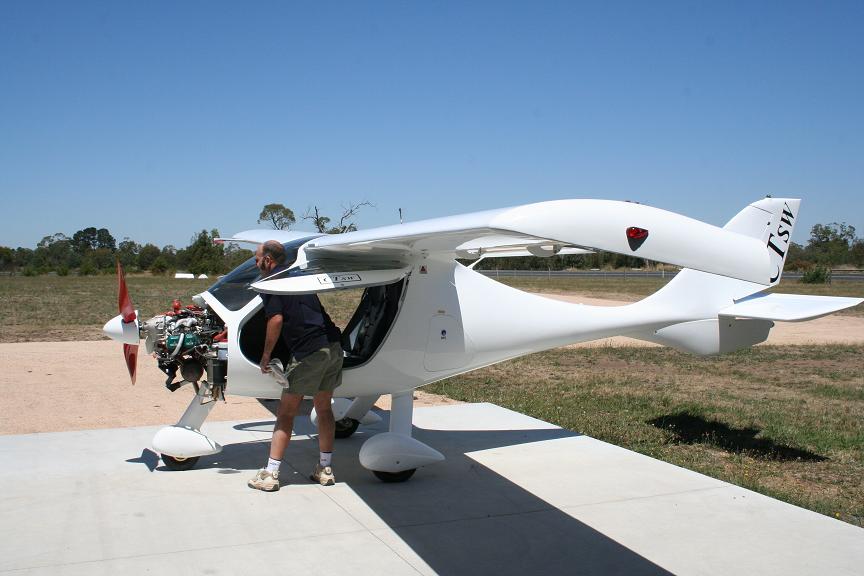

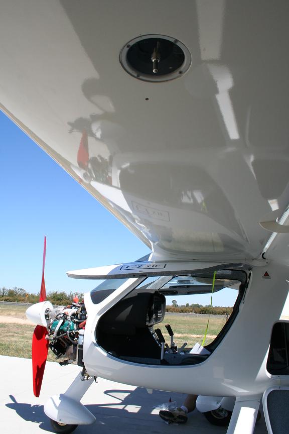

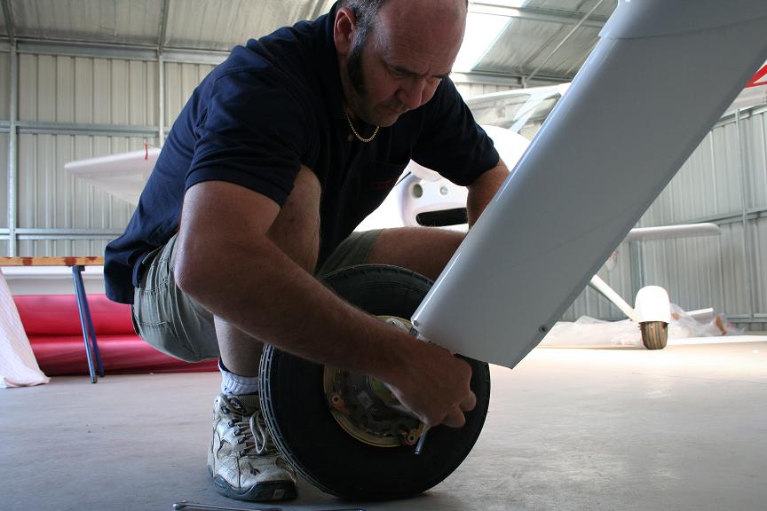

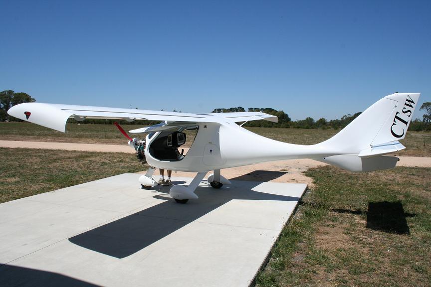

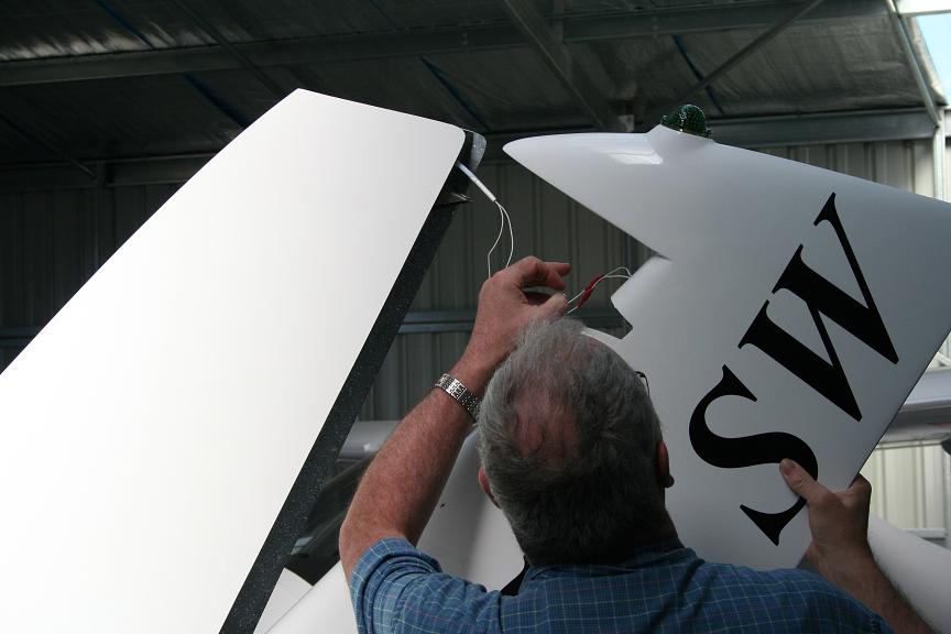

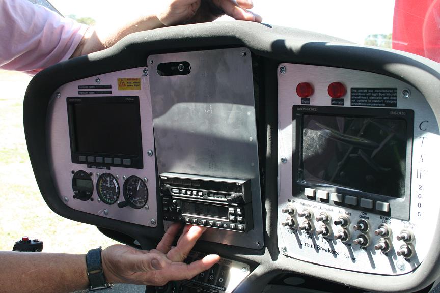

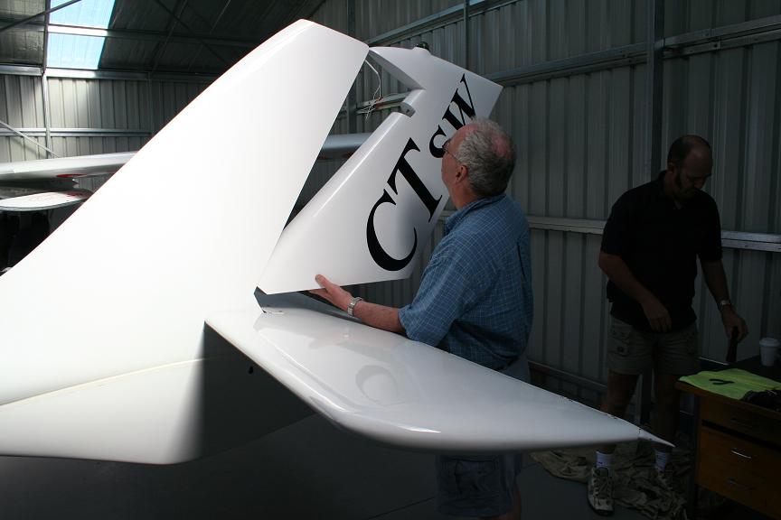

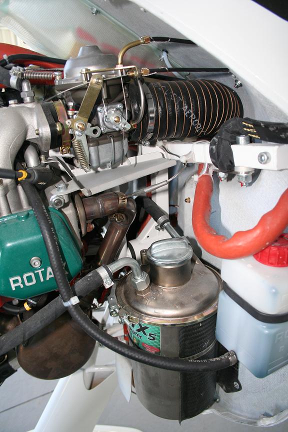

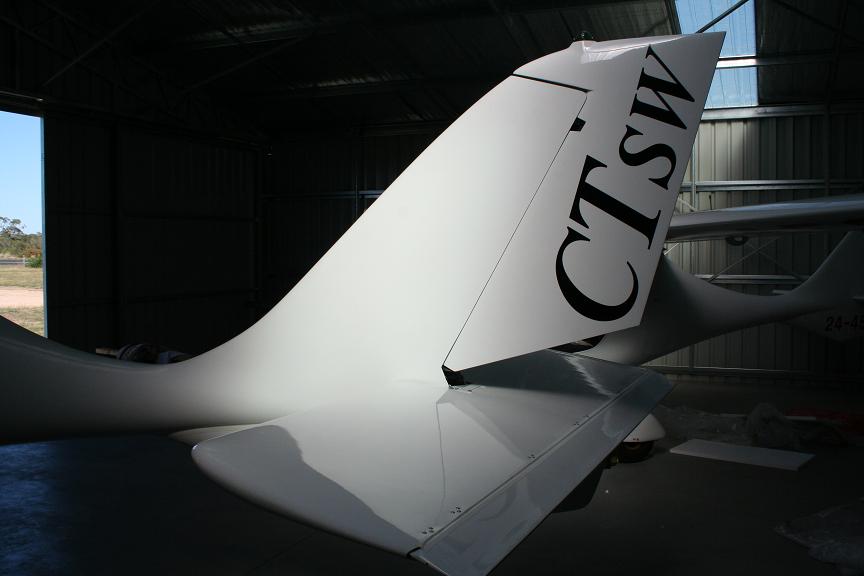

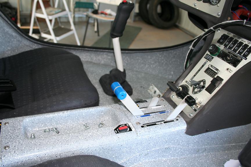

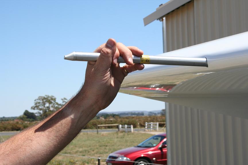

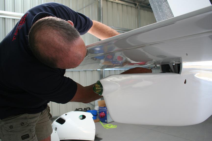

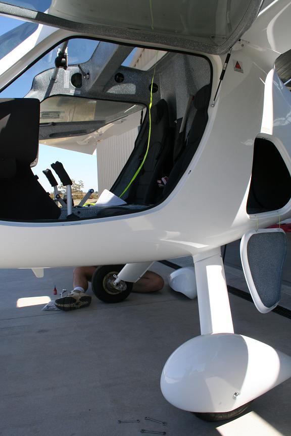

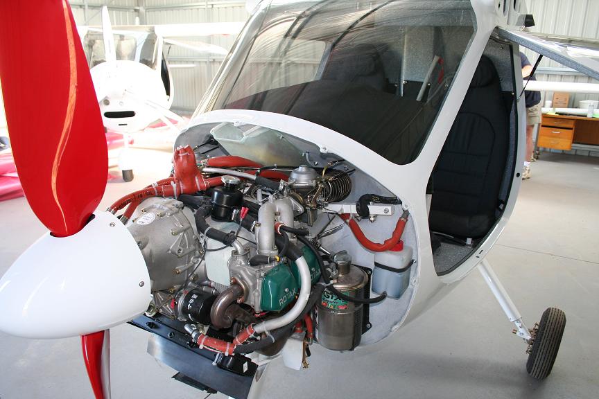

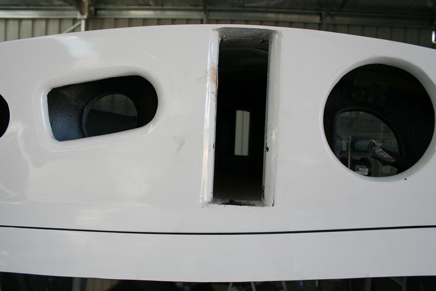

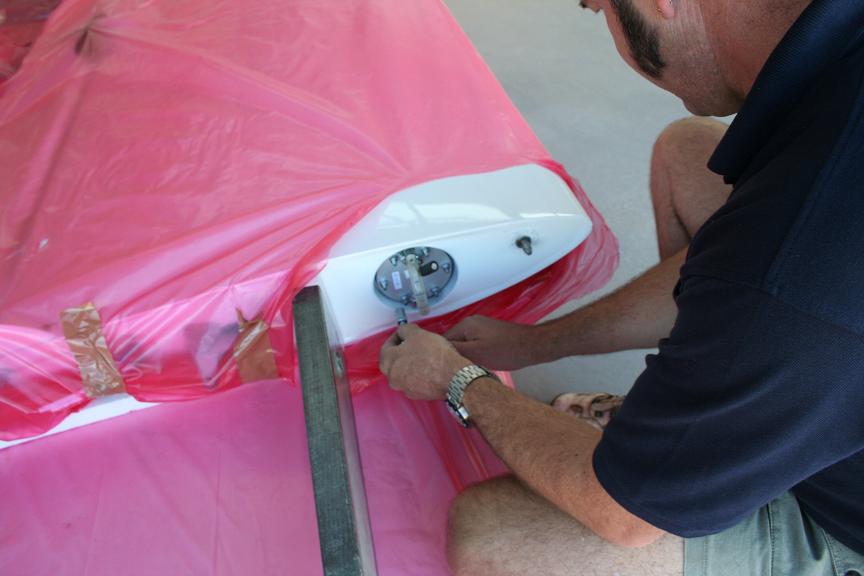

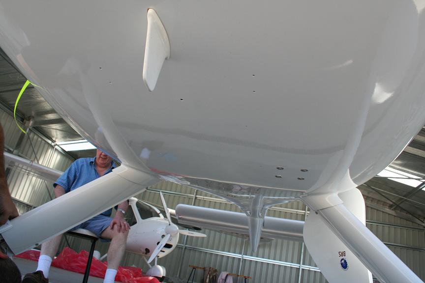

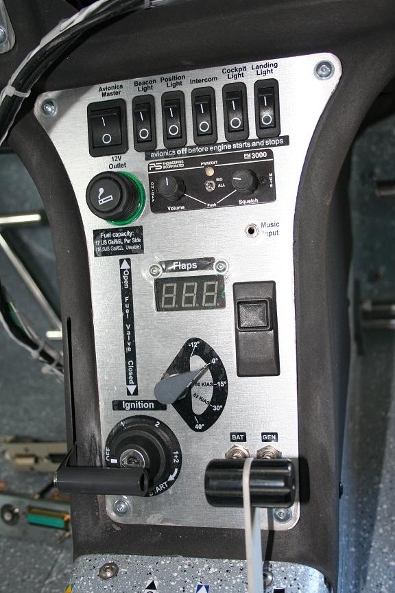

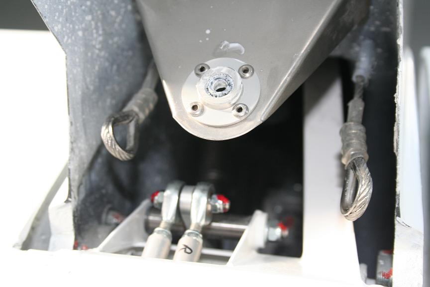

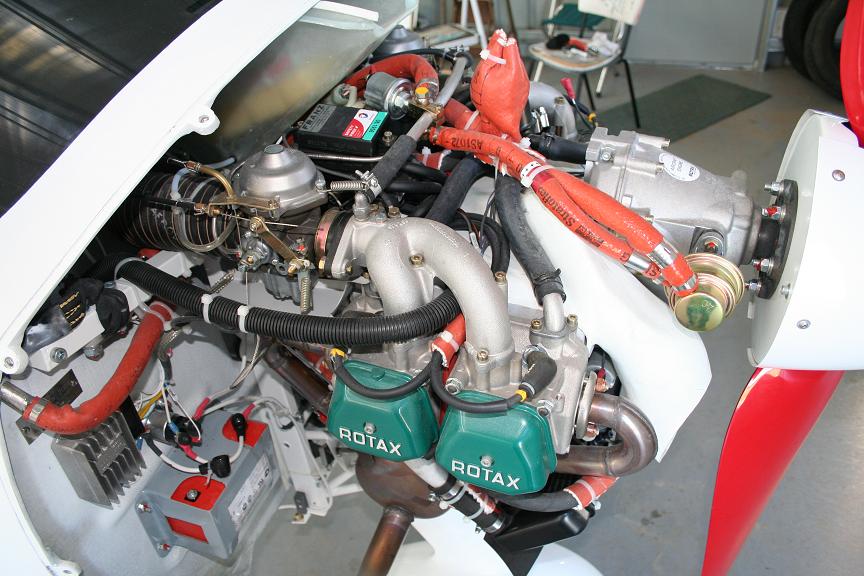

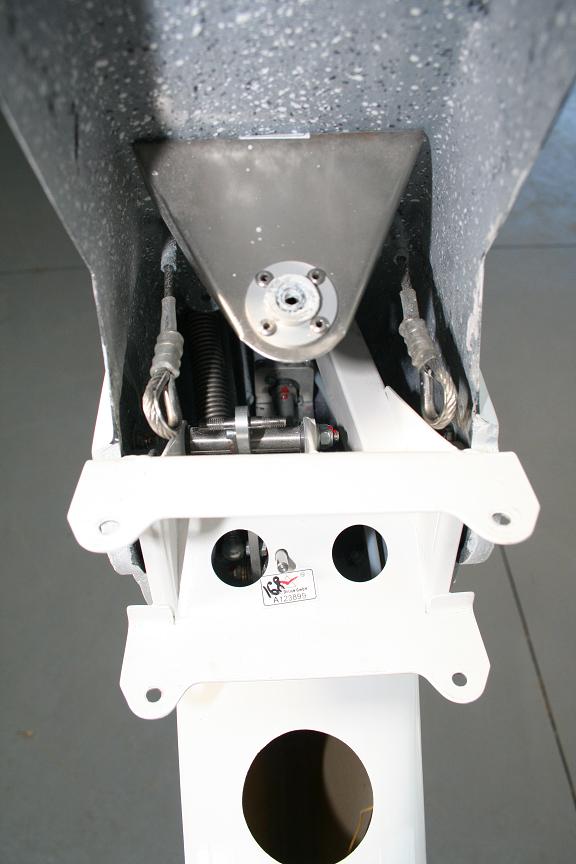

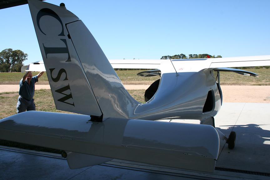

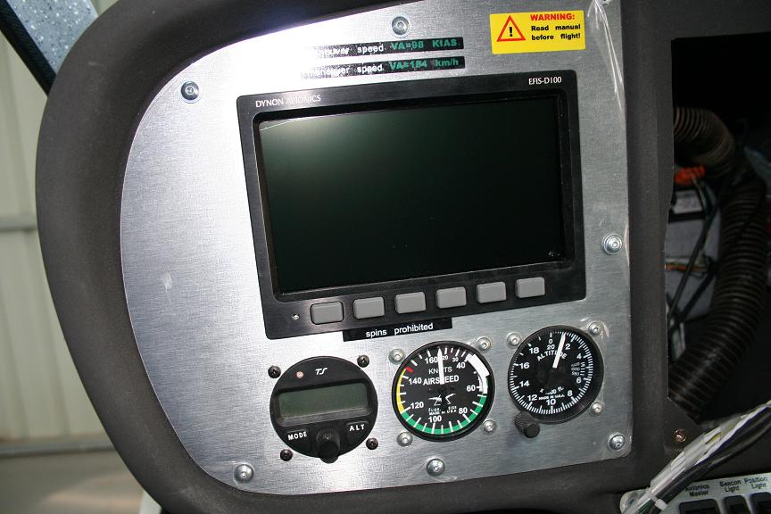

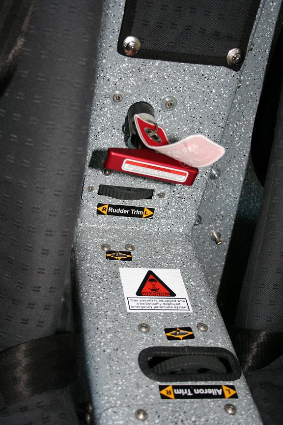

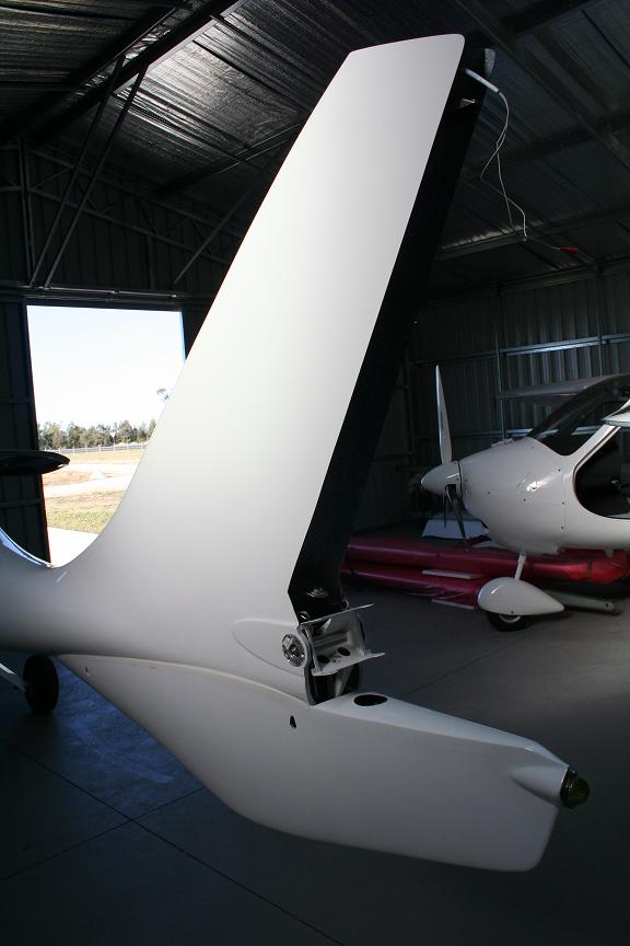

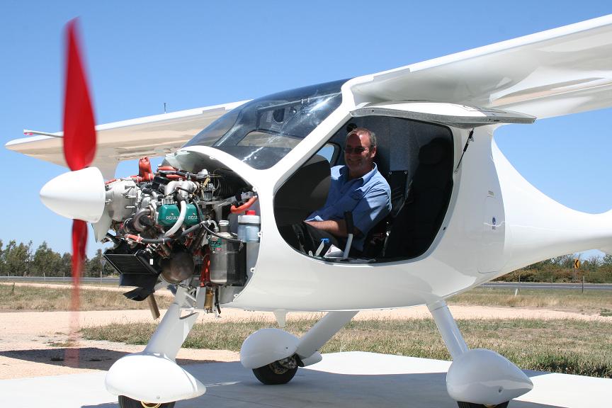

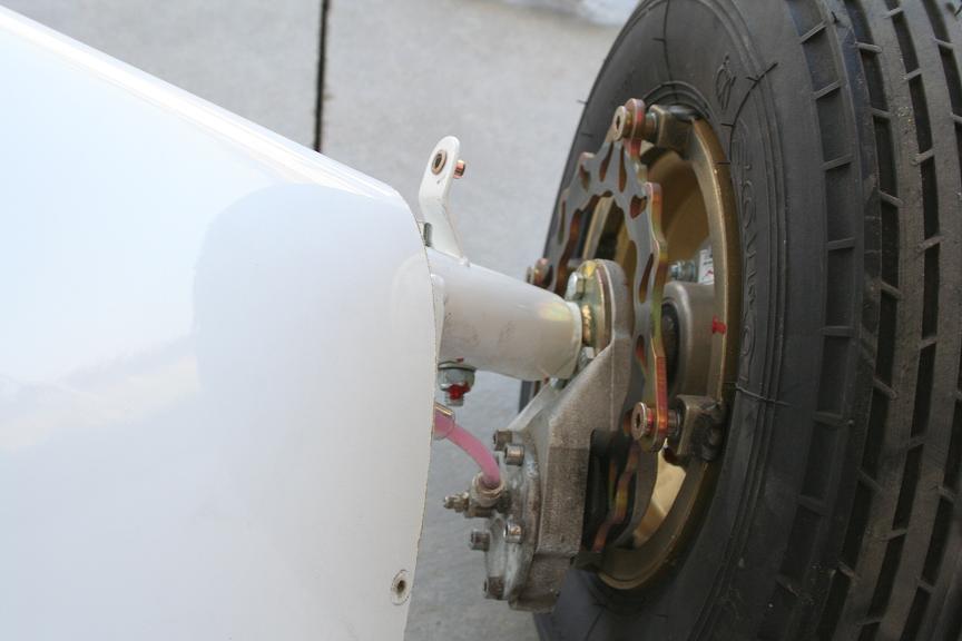

Admin Posted February 3, 2007 Author Posted February 3, 2007 Well, I finally got to see my new CTsw in the flesh yesterday and helped Shaun from Sports Aircraft Australia perform her final assembly. It was a good chance to see the actual workings of the CTsw. The Avmap GPS is still to be fitted which Stan, the avionics guy, is making up a new centre panel to house the GPS, the Garmin transponder and Garmin radio. To make it fit he will have to rotate the carby heat and cabin heater block 90 degrees to mount it vertical as the Avmap has a whopping 7inch display. Today the LAME will check her over and hopefully pass her as airworthy. The colour scheme and numbers will be attached tomorrow (Monday) and then they have take a picture of her with the rego numbers being 24-4848 and send it off to the RA-Aus for my CTsw to finally be registered and ready for her final test flight. When the Avionics are completed the keys will be handed over Here are some pictures of her final assembly yesterday - there are a lot The tail section as she came out of the container ready for assembly [ATTACH]1296[/ATTACH] The mounting brackets for the rudder and elevator [ATTACH]1297[/ATTACH] Attaching the elevator [ATTACH]1298[/ATTACH] Attaching the elevator to the bottom bracket [ATTACH]1299[/ATTACH] The Rotax 912 engine ready for final inspection [ATTACH]1300[/ATTACH] They pack the engine in nicely in the CTsw [ATTACH]1301[/ATTACH] The engine attachment to the firewall - very strongly done [ATTACH]1302[/ATTACH] The left side of the Rotax [ATTACH]1303[/ATTACH] The wing mounting holes [ATTACH]1304[/ATTACH] Ready to mount the rudder [ATTACH]1305[/ATTACH] Look at the twist on the Neuform prop [ATTACH]1306[/ATTACH] Checking the brakes and wheel attachment [ATTACH]1307[/ATTACH] The BRS Ballistic Parachute deployment handle, the rudder trim and the aileron trim [ATTACH]1308[/ATTACH] The throttle etc quadrant and elevator trim [ATTACH]1309[/ATTACH] The CTsw has enormous room and even has a centre console [ATTACH]1310[/ATTACH] The centre panel looking a bit dirty and dusty from her long trip from Germany [ATTACH]1311[/ATTACH] The Dynon EMS D120 Engine Management System [ATTACH]1312[/ATTACH] Behind the panel where the radios and GPS goes [ATTACH]1313[/ATTACH] The Dynon EFIS D100 Flight Management System [ATTACH]1314[/ATTACH] The panel so far inc the Autopilot - the white button on the stick turns the AP on and off [ATTACH]1315[/ATTACH] These high back seats are so comfortable [ATTACH]1316[/ATTACH] The lower area behind the cockpit rear wall [ATTACH]1317[/ATTACH] The BRS Ballistic Parachute [ATTACH]1318[/ATTACH] Inside the fuselage before the fabric wall gets attached [ATTACH]1319[/ATTACH] The top part of the aileron and flap workings [ATTACH]1320[/ATTACH] Attaching the rudder [ATTACH]1321[/ATTACH] Rudder part 2 [ATTACH]1322[/ATTACH] The tail is complete [ATTACH]1323[/ATTACH] Well almost - the rudder cables (we need them) [ATTACH]1324[/ATTACH] Now the wings - fuel tank check first [ATTACH]1325[/ATTACH] Everything ready for the wings [ATTACH]1326[/ATTACH] Put some grease in first [ATTACH]1327[/ATTACH] YES - the wings are on [ATTACH]1328[/ATTACH] The fuel gauges [ATTACH]1329[/ATTACH] The ballistic chute opening [ATTACH]1330[/ATTACH] Now we're talking - looking nice [ATTACH]1331[/ATTACH] Oops - still some more to do [ATTACH]1332[/ATTACH] Panel try out [ATTACH]1333[/ATTACH] Brakes!!! - ready for the spats [ATTACH]1334[/ATTACH] One on - one to go [ATTACH]1335[/ATTACH] Nice and slippery underneath [ATTACH]1336[/ATTACH] The OAT and remote compass area [ATTACH]1337[/ATTACH] Nothing spared here - even LED lights [ATTACH]1338[/ATTACH] Flaps and ailerons [ATTACH]1339[/ATTACH] Watch your head - even has angle of attack in the Dynons [ATTACH]1340[/ATTACH] Are we ready yet??? [ATTACH]1341[/ATTACH] Final look over [ATTACH]1342[/ATTACH] HOORAY - SHE IS GOING!!! and check out that grin [ATTACH]1343[/ATTACH]
Guest pelorus32 Posted February 3, 2007 Posted February 3, 2007 Hi Ian, It's getting close!! What a great picture story. She looks really good. I noticed the LSA placard in the cockpit. Is she an LSA rego aircraft with 600kg MTOW or a UL with 544kg? Hope today is another great day. Regards Mike
Admin Posted February 3, 2007 Author Posted February 3, 2007 Mike I went for 544 as it is inevitable that we will be going to 600 so I thought I would just wait till then - just means that with me being 105kg (no comments :big_grin:) I just won't be able to take the full 130 litres of fuel if I take a passenger till we go to 600 - she comes in at a tad over 300kg so in rough figures 300+105+80 (pax)=485kg which means 60kg of fuel which is 80 litres. When we go to 600 and full fuel and pax still leaves me 18kg of luggage - these are rough figures In the words of a infamous Aussie - I'm EXCITED Meanwhile back at the ranch and having been away for so long the wife wants the iron fixed, the plinth boards put back on after the house was re-stumped, the cracks in the walls fixed, every room painted, the garden changed over to use less water, the garage cleaned out, the swings and trampoline moved, the cubby house painted, lawns mowed, new cupboard in the kitchen yadda yadda yadda ;)
