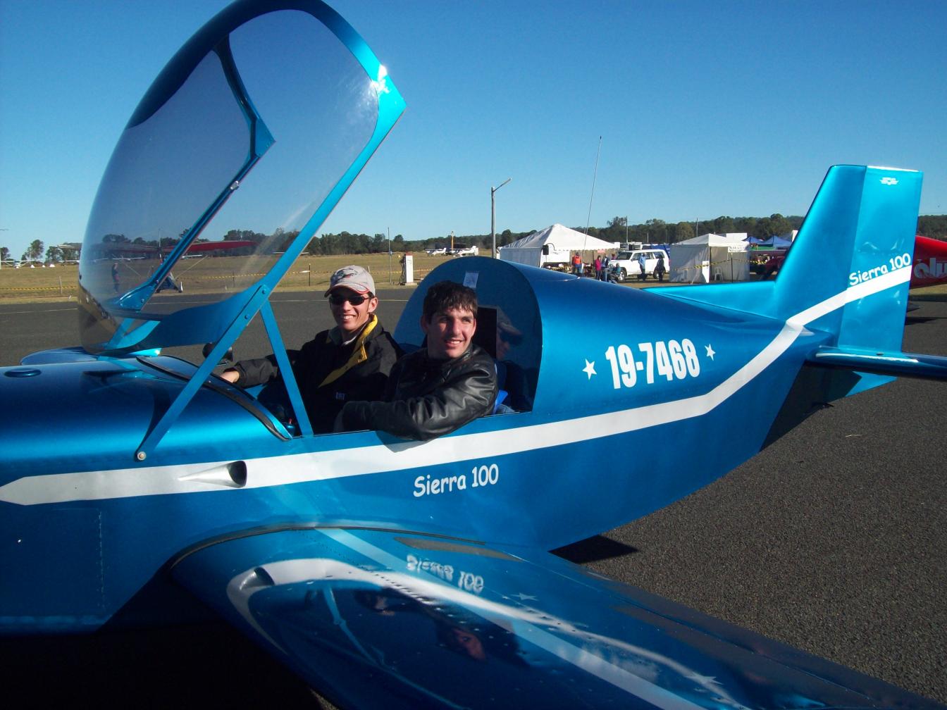

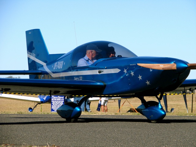

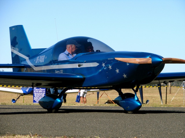

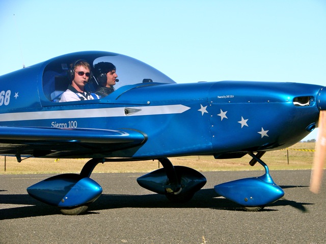

Ok, I'll stop now and just show you some photos of the Blue Sierra 100 -
