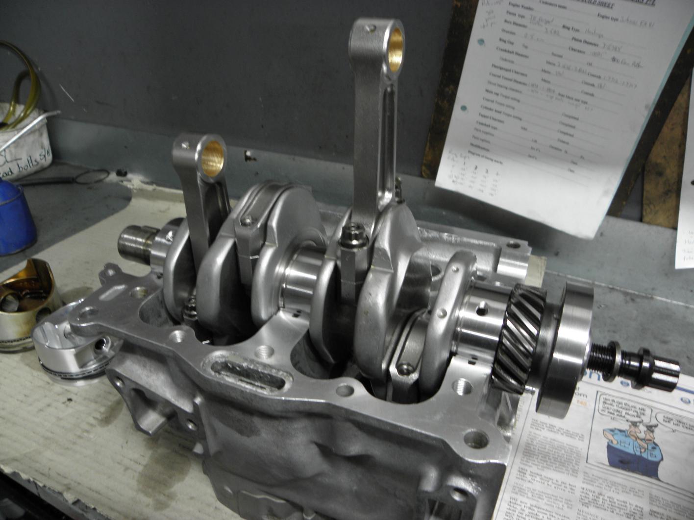

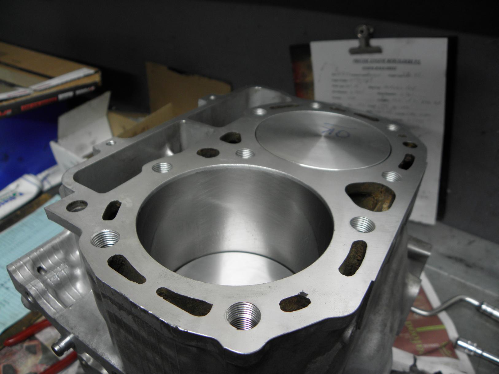

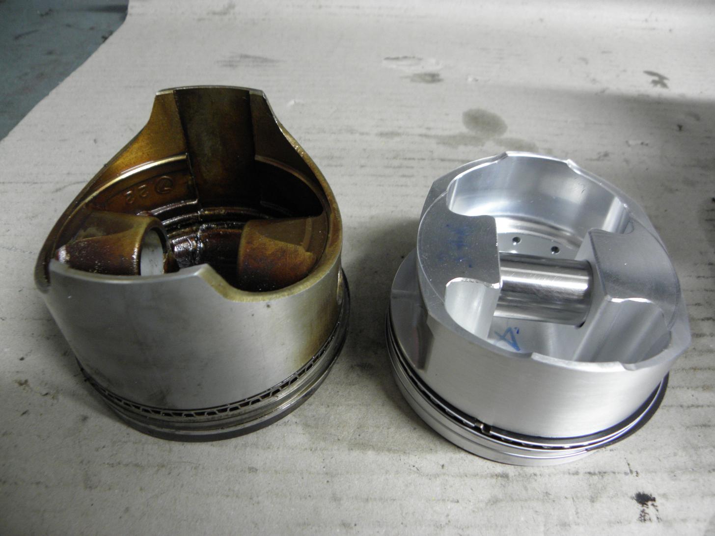

will kirkbride Posted October 13, 2010 Posted October 13, 2010 Subaru EA81 update Just an update on the progress of the Subaru engine for anyone interested. After strip down and measuring, the block halves were machined and line bored, including the camshaft and oil pump housing. All threads were helicoiled to improve reliability. Custom steel con rods with larger bolts , ended up the same weight as the originals. Forged pistons with narrow rings for less friction. weight of these were approx. 50 grams lighter than the Subaru cast pistons. Block was machined for zero deck height for the pistons. Rebore and honing of cylinders to .5mm oversize. Crankshaft was polished and measured. As there was no wear, journals were linished. Next step is to balance the rotating assembly after the redrive is finished. [ATTACH]12141.vB[/ATTACH][ATTACH]12142.vB[/ATTACH][ATTACH]12143.vB[/ATTACH]    Â

will kirkbride Posted November 1, 2010 Posted November 1, 2010 David. Have had a lot of experience with Subaru engines. Aftermarket parts are still available at reasonable prices. The only part hard to source is the oil pump if you should need a new one. My engine has custom pistons and con rods, however ,standard cast pistons in oversizes are still available. I will be posting new pics as I progress with the rebuild but feel free to ask any specific questions and I will do my best to help. cheers Â

will kirkbride Posted April 7, 2014 Posted April 7, 2014 Hi, I am rebuilding an EA 81 and would like to know more about the custom con rods and where they are available from. Cheers Ray. Hi there Ray. The rods were custom made by Phill at ARGO engineering in Morphet. They were the first of these rods to be made for on EA81 as I recall(the standard ones would probably be more that strong enough) but I wanted peace of mind. PM me if you want more details. Cheers Will Â
AirWolf Posted April 7, 2014 Posted April 7, 2014 Hi Will, Thanks for that info, I will chase up Argo and see if they still have the drawings. Were they made the same length as the standard rods or were they longer? My thoughts are if you are going to make new rods ,longer ones would enable you to have a shorter piston thus reducing the rod angle, just my thoughts. Thanks again Will, cheers, Ray. Â
will kirkbride Posted April 7, 2014 Posted April 7, 2014 Hi Will,Thanks for that info, I will chase up Argo and see if they still have the drawings. Were they made the same length as the standard rods or were they longer? My thoughts are if you are going to make new rods ,longer ones would enable you to have a shorter piston thus reducing the rod angle, just my thoughts. Thanks again Will, cheers, Ray. Ray, The rods were standard length. I doubt that making a long rod type engine would be much advantage because of the short stoke of this engine. The ring pack is quite compact as it is and if you want to use available pistons, it would not be a economical option. If you are serious about using this engine, there is a heap of information on the net. I have mine running now and am in the ground testing stage. So far it looks good. I am happy to share any info. Cheers Will Â
