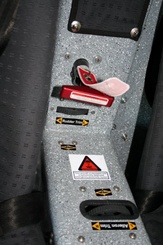

I remember when I bought the CT there were two BRS options - one that was just ok in terms of weight and speed and the other one was heavier but it went past VNE and just past 600kg so I went for the heavier one which weighed in at 21kg.
The reason why I went for that one is I registered the CT at 544kg not 600kg LSA even though the aircraft was certified at 600kg. This meant that my legal weight was 544kg + 21kg = 565kg as the weight of a BRS is not included in the registered MTOW as long as the registered MTOW + BRS doesn't exceed the certified weight - does that make sense.
So in this case the weight of the BRS had no impact on my MTOW
This is the handle (with safety pin in) between the two seats:
[ATTACH]10589.vB[/ATTACH]
