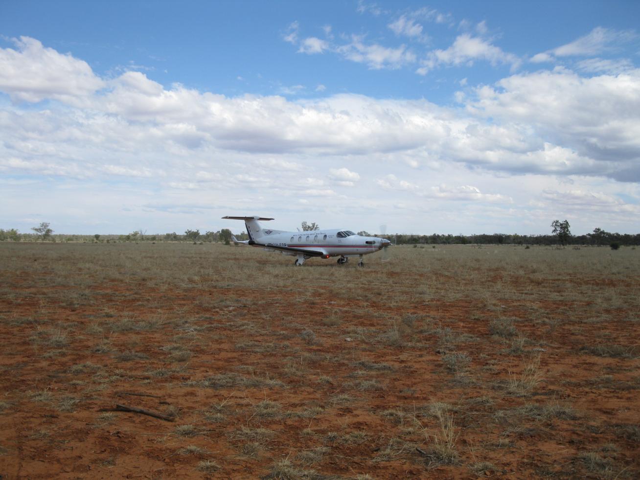

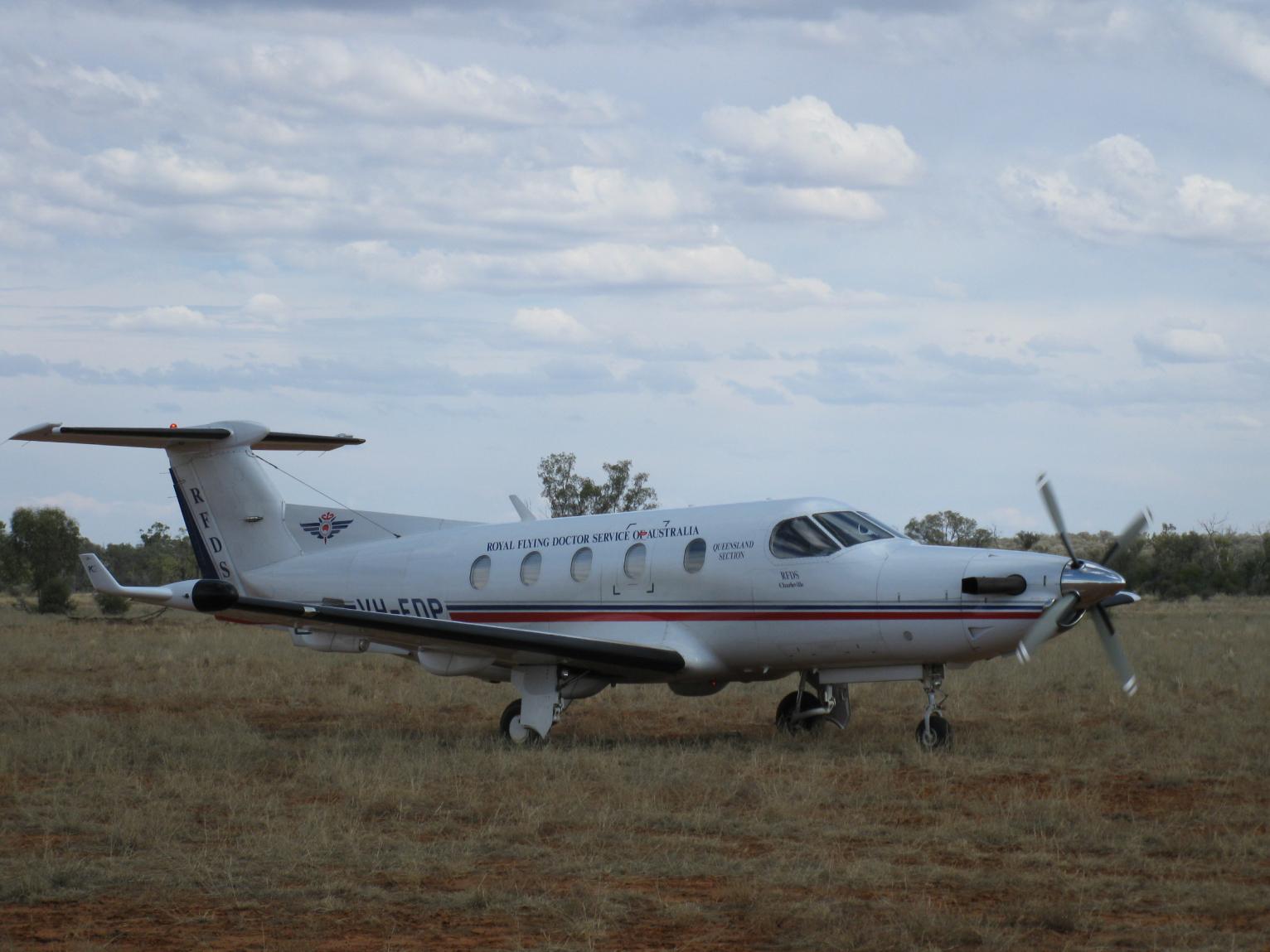

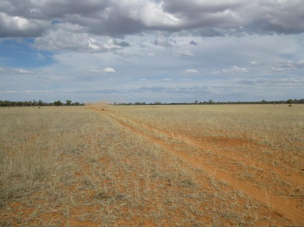

Here's a couple of pics from a job I went to in the middle of nowhere. The night version of this strip is a couple of vehicles at each end facing in 45 degrees.
This strip was just run over with a grader and slashed occasionally.
