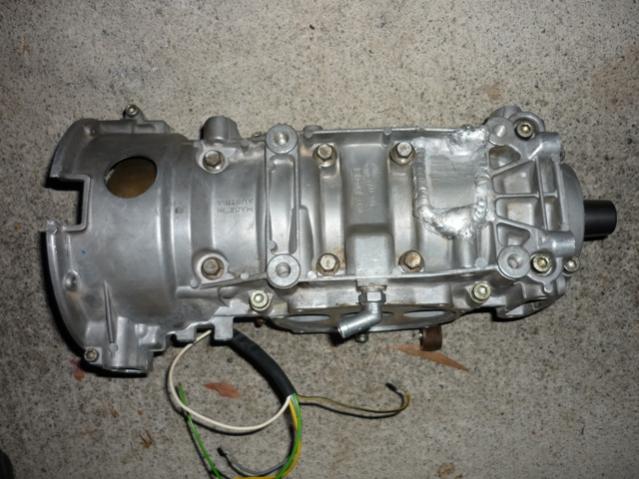

I picked my bottom end up from the workshop today - work is paid for and organised by the guy restoring the aircraft. The deal is I purchase the aircraft in fully restored condition. Problem is I have serious misgivings about this engine. Check out the welded repairs to the crankcase in these photos.
What do you think?
Pud
Guest terry
Pud, don't even consider accepting something like that on your plane. Sometimes it's better to wait for the right piece to turn up. The crankcase I have is from a 532 but can be ajusted to a 582 but I wasn't happy and my lame was in two minds as well so we decided to wait and go looking for one off a 582. We found one the next day and I paid 500.00 for it.
I could have haggled but I had the motor totally apart on the floor so was in a hurry. You could get one cheaper I'm sure. It also needs to be in good condition with little wear. Don't bother asking bert flood for a price, you will die laughing.
Regards Terry

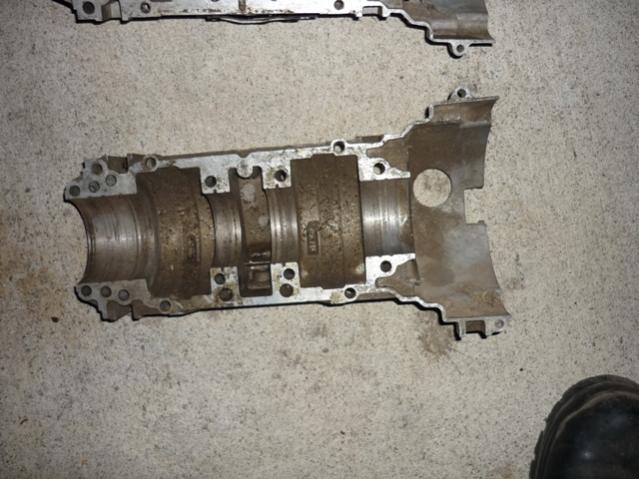

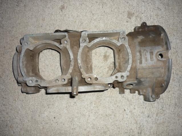

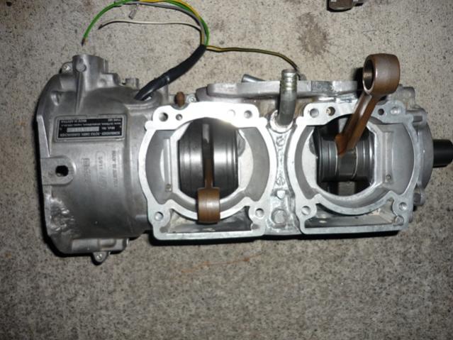

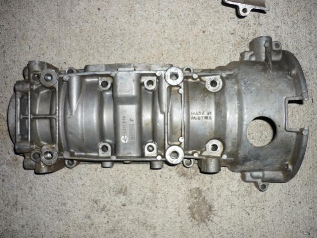

Yeh I hear what you are saying. I just wanted some other feedback so I could be sure it's not just me being unreasonable. I do have another crankcase that is in fair condition although one of the bearing housings has a slight score on it. Check the photos out below
Cheers,
Pud
Hey Pud,
I have just rebuilt a 582 and the cases looked like new! I'm just an amateur aviator but I don't realy like the look of your cases. best to be sure! Don
Guest terry
Hi Pud, I'm of the apinion that their not good enough either, I think others might have more expertise than me on this one. Ask around the traps particularly people that work on 582's. I'm thinking of that fellow in Q'land has a good reputation. I can't think of his name right now but it will come to me. Terry
Thanks for the feedback guys,
I had the discussion this morning with the guy paying for the engine overhaul, gave him my opinion in no uncertain terms and he agreed the crankcase is not satisfactory and will be changed.
