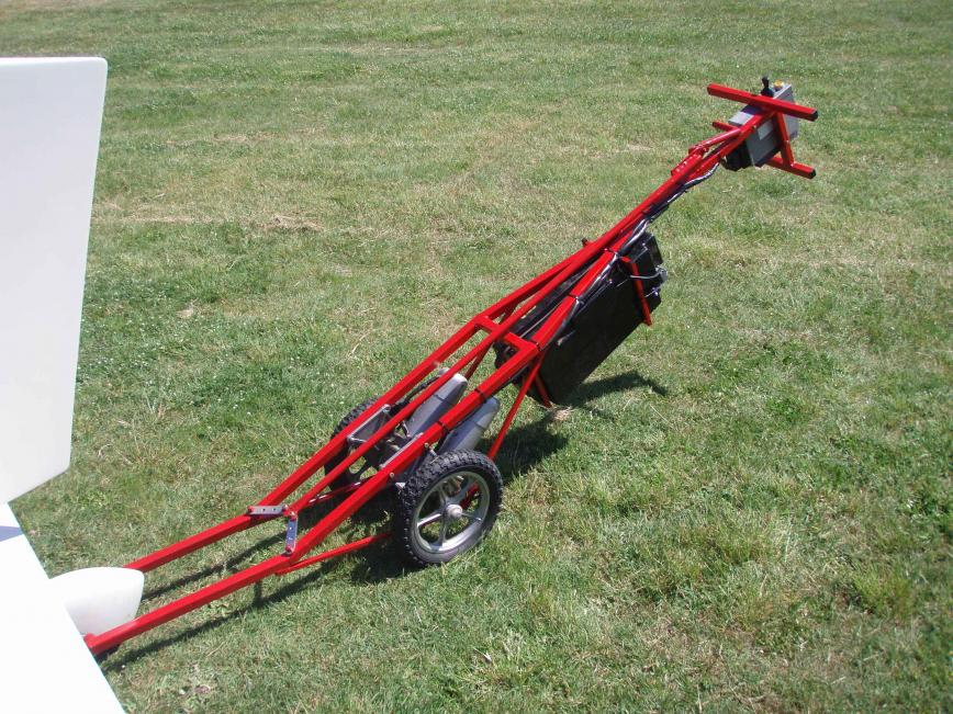

Guest Qwerty Posted October 31, 2009 Posted October 31, 2009 Hey guys, I made this. It seems to work OK. I will get Ian to sort out a video for you. Cheers Qwerty
dunlopdangler Posted October 31, 2009 Posted October 31, 2009 Well thought out there Qwerty, nice job
Guest Maj Millard Posted November 1, 2009 Posted November 1, 2009 Whose wheel chair did you steal Querty ??....................................................:gerg:.
Guest Qwerty Posted November 7, 2009 Posted November 7, 2009 Gday Maj I don't know whose wheel chair it was, I didn't ask, I just tipped the chair forward and she fell out, she was making a bit of a ruccus when I left with the chair but I didn't get a name, I wasn't really listening. Anyway, I think that I have finally worked out the video of my mate shifting my Jab with the tug. Cheers, Qwerty
