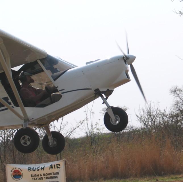

xair1159 Posted February 23, 2018 Posted February 23, 2018 Some ultralights use an instrument static port inside the cabin or fuselage and flying doors off can affect the ASI readings. If you have a proper wing mounted pitot / static set-up you are OK, if not just check ASI readings with and without doors before you perform a "firm" landing. Seeing your photos, very high AOA flight can give false ASI readings due to positioning error, i.e the pitot is not pointing directly into the airflow.
