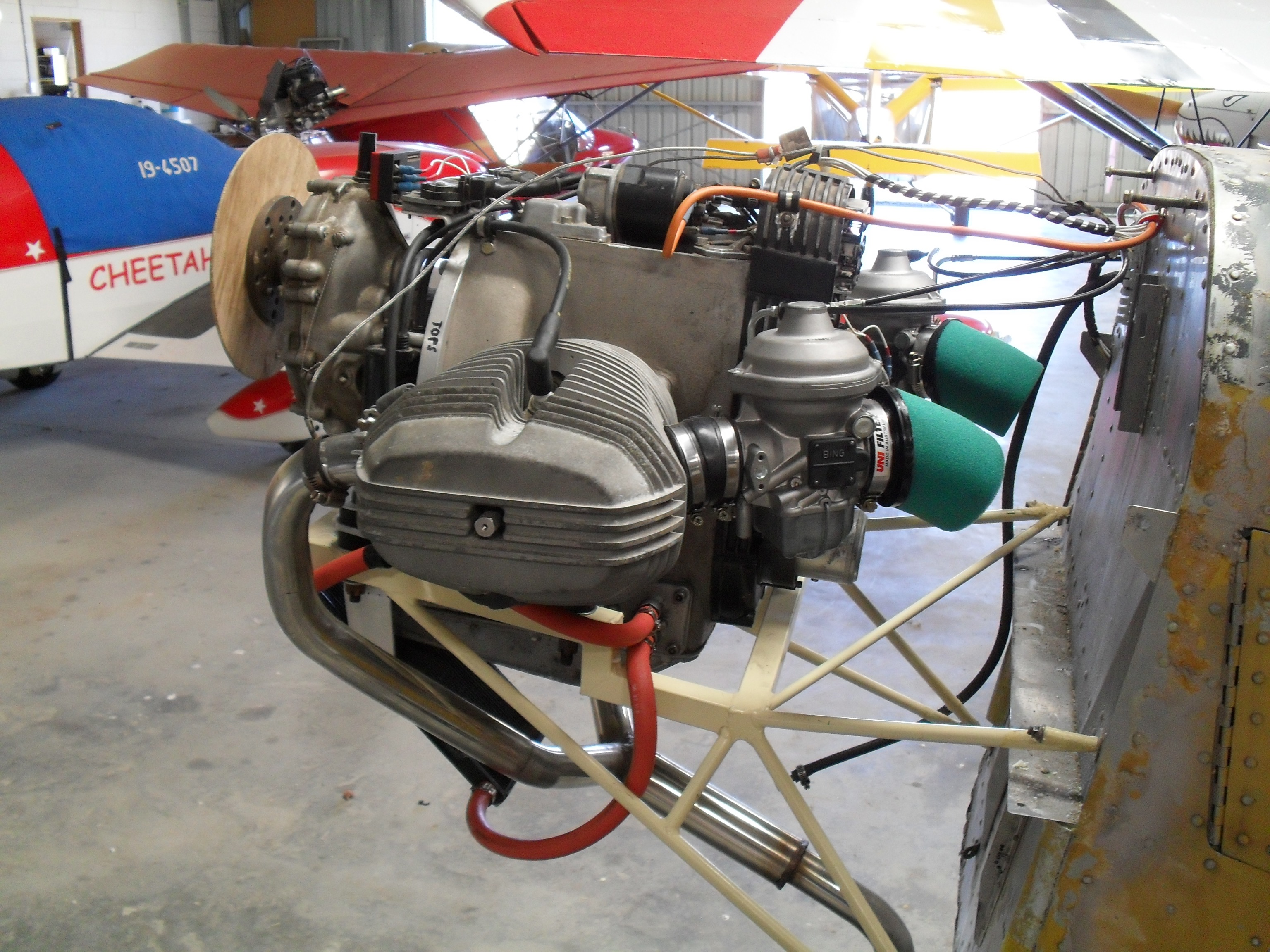

pylon500 Posted May 1, 2020 Author Posted May 1, 2020 OK folks, just reviving this old thread for chatting purposes... Just a quick little history of my 'Stollite'; Using the wings of a previously upgraded ultralight, myself and a then apprentice with me at Bankstown, threw together (over three years) an airframe using very standardised all metal structural concepts ie; Cherrokee styled wing tanks, Cessna styled cabin with all controls under floor, Beaver styled aft fuselage and tail group, and unfortunately a Jabiru/Vampire styled control system (you live and learn). Originally powered by a Rotax 503 as a 95:10, until it failed with the aircraft being lightly damaged. It was then rebuilt as a 19 class, and powered by a Rotax 582, until I blew that up, (long story for later), but fortunately this time the aircraft was unscathed. I happen to have an 80hp Rotax 912 laying around for another project, so I 'borrowed' it and continued flying. The irony here is that, while using the 912, I was always on the lookout for something more akin to the 582, which it flew well with, to replace the 912 so it could go into the other project. Enter the BMW R100 conversion that was sitting in a hangar with no paperwork or exhaust, but a reasonable price. BMW details; This is (to the best that I can determine) about a 1985, 1000cc bike engine that has had a full aero conversion kit, I think it is an English kit? The engine has an adaptor plate on the gearbox end (which is now the front) and has a Rotax 'C' box with a spragg slipping clutch (the prop free wheels). Because the engine is now technically installed backwards, both pots have been swapped across, putting the exhausts on the forward end of the engine, and therefore the carbi's at the back. The heads have been modified to have two plugs, a mod done on the bikes as well, and a dual electronic ignition system fitted. Things I had to do; The inlet ports face upwards, about 20º from horizontal, so I needed to get some angled manifold rubbers to fit the 54mm Bing carbs (x2). Make a catch can for the crankcase breather. Modify the oil filter to adapt to an oil cooler. Fit an oil pressure sender. Get an exhaust system made. Operation; I fitted a larger Stewart Warner tach to the aircraft, and I think I have the switches at the back sorted? When it works, the motor runs out to near 6000rpm and flies the Stollite about the same as the 582 did, using the same prop. The problem I'm having is something fuel related, where when I first ran it, it started easily and idled pretty well. I had been told they don't like to idle too slow, but sits fairly smoothly around 1800~2000rpm (bit like a 912). Problem was when I first opened it up, it got to around 4000rpm and started to run rough and miss until it would stop. This turned out to be fuel starvation. Checked the fuel system, which seemed OK, so added an electric pump. Start the engine, run up to 4000 where it would start to miss, turn on the pump and it would come good, and continue on up to around 5800 with good hearty sound. Throttle back towards 3000 with the pump on, and it would go rough again, and if the pump wasn't turned off, it would flood out and stop. This is not highly conducive to relaxed flying (don't ask), so when I find time to go back and fiddle with it (like now while we're not flying much), I'm playing around with different pumps and float settings. The flight photos are around 2000ft over the airport (always within gliding distance), back in around 2017(!) and I've probably done a total of about an hour in it! Other projects had since crowded the Stollite to the back of the hangar until last month, when I figured out how to adapt a 912 mechanical fuel pump to the 'C' box. Unfortunately it hasn't totally cured the problem and the 4 year old, non maintained battery, is almost stuffed, and now the other projects and some sideline work are pushing for attention. I'll get there eventually. 4 1
