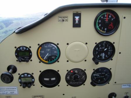

autoprop 2002
photo should be attached - tecnam bravo advert
autoprop 2002
dont know any thing about it though
