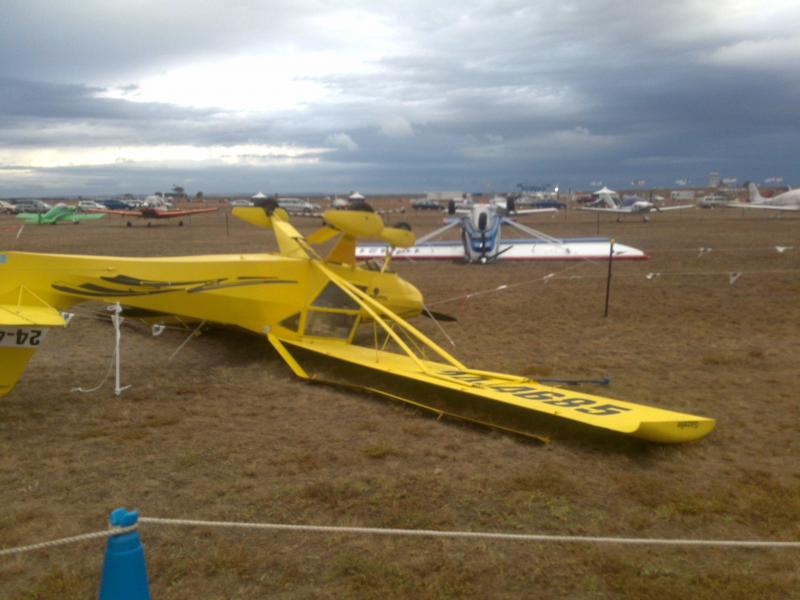

Guest Wigg Posted March 21, 2009 Posted March 21, 2009 Hi we took our Skyfox to Avalon for the Air show where we had it on display and on Saturday at 6.30 a microburst came through and turned it upside down now we have to repair it and I am looking for any one who would have some information on repairing the Aileron hangers as both sides were broken off.  Â
dunlopdangler Posted March 21, 2009 Posted March 21, 2009 Gidday Wigg, Sorry to see your Gazelle looking a little worse for wear and appreciate how you would be feeling right now.. If your aileron hangers are broken chances are some of the ribs may be damaged as well as the hangers are an extension of those ribs and you won't know until you inspect each one accordingly. I am not sure where you are based and who would be able to repair your wings locally for you but I do know that if you contact Gympie Aircraft Maintenance and speak to Tao, He should be able to point you in the right direction..(Tao used to work at the Skyfox factory in Caloundra and has rebuilt many since) It may be the case of chucking your gazelle on a trailer and driving up to the Sunshine Coast for some R & R (remove and repair). Â
pylon500 Posted March 24, 2009 Posted March 24, 2009 There was a standard repair for broken hangers which involved opening the trailing edge fabric and splicing new rear sections onto the ribs, typical repair after a Skyfox groundloop. Please note, if you have bent either of the spar tubes, your wing is basically a writeoff.  Arthur. Â

Guest Wigg Posted March 24, 2009 Posted March 24, 2009 Hi Pylon We opened the wing a little bit yesterday and had a quick look and there is a little bit more damage than we thought, I have to wait until I can get the area that we are going to work on it cleaned up before we can take the wings off and start to work on them at the moment we are trying to get as much information as we can before we start. We will be asking a lot more questions before we finish and we will be very appriciative of any help. Many thanks John  Â
Guest Maj Millard Posted March 25, 2009 Posted March 25, 2009 Looks like you'r in for some major work on those wings, unfortunatly. Suggest you should have an L2 advise you if you'r not one yourself. It appears to be a bit more than a L1 can legally attack. Tony Kerr at Gympie has parts and can carry out the mods. Is that a Lightwing on it's back in the background ?. Â

foxworker Posted March 30, 2009 Posted March 30, 2009 Hi Wigg, There is nothing wrong with the original timber Skyfox factory approved repair. As I read all the comments about the hangers, I sense some people think that the material ie. the timber, birch 11 ply (from memory) is the problem. It's not and in my opinion never has been. I do have the original repair drawing, sorry a photocopy of, and if the repair is carried out by a skilled hand, and also done with a emphassis on attention to detail , then a successful long life repair can be made. It is not a particularly difficult repair, just needs to be done well. The final process in the structural side of the repair of sealing is no less important than the actual repair itself. This is where alot of the earlier wings lacked. Â

Guest Wigg Posted May 4, 2009 Posted May 4, 2009 Hi every one  I would like to let you know how we are going with the job of repairing our Skyfox Gazelle after the accident at the air show. Well we got the wings off with a little bit of difficulty the pivot bolt at the top on the right side was rusted in and we had to drill it out. We took the wing strut off first then I held the wing about half way down and Rod my mate who is helping me with all the repairs drilled the centre of the bolt out but it was still stuck so we encouraged it with a bit of a hit, when it came free the end of the wing dropped and punched a hole in the horizontal stabilizer but it was off. Then we took the other one off as well, it came off with out any trouble then we put them on a bench that we made and took off the wing tips and uncovered the top of the wings to see what damaged had been done to the ribs, and to our surprise apart from the aileron hangers there was only a light timber support that holds the wing shape ribs that broke when the wing came down on a star post, we had to buy a piece of timber 4 meters long and reduce it to get it to fit and it worked great. We have also had the aileron hangers made of aluminium and we are about to fit one to one and get a level 2 engineer to check and make sure if it is all right, if he signs it off we will install the rest of them, we also straitened the tip of the vertical stabilizer a little bit then we have to work on the ailerons and then re-fabric it all back again. Buy a new prop and we are in the air again. I have taken a lot of photos and if anyone is interested I will be glad to send them to you. I also have a Skyfox Gazelle Manual if you are interested. [email protected]  Â
Guest Wigg Posted May 11, 2009 Posted May 11, 2009 Update on repairs to wing. We have replaced the broken timber (support spar) under the ribs on one wing, and have put in the first aluminium hanger (which we lined up with a laser beam). We checked out the beam along the trailing edge of wing to make sure it wasn't twisted. Once the hanger was on we checked with the beam again through the hole of the remaining wooden hanger through the hole in the new one to make sure it was straight. John Â
