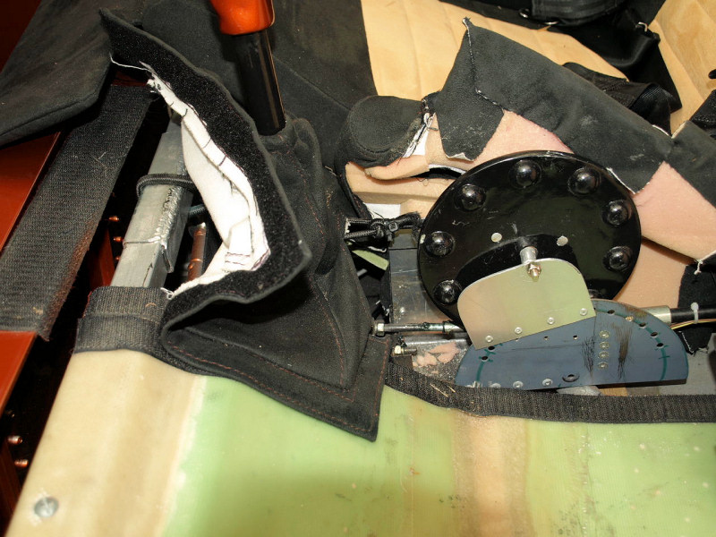

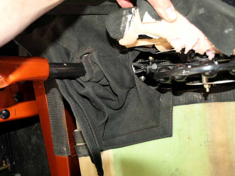

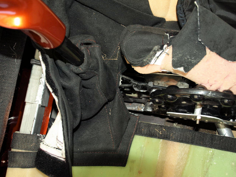

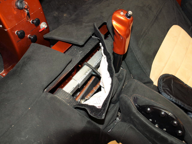

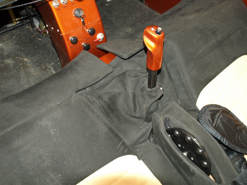

slartibartfast Posted March 18, 2009 Author Posted March 18, 2009 Slarti,Please excuse my lack of knowledge but you mentioned trim with bungies? How does that work Here you go BLA82 and Doug. Snapped a few of the bungie trim arrangement. You've made me notice how dirty my floor is. Time for a vacuum. [ATTACH]7386.vB[/ATTACH] With everything in place. Turn the wheel for elevator trim. [ATTACH]7387.vB[/ATTACH] Just lift the velcro and slide the bungie left or right for aileron trim. [ATTACH]7388.vB[/ATTACH] [ATTACH]7389.vB[/ATTACH] You can see the spool. [ATTACH]7390.vB[/ATTACH] The arc and detentes were for the original lever. The holes were too far apart.
Deskpilot Posted March 18, 2009 Posted March 18, 2009 Thanks for taking the time to photograph your setup Ross. Not real clear as to how it works but. Any good at drawing?
