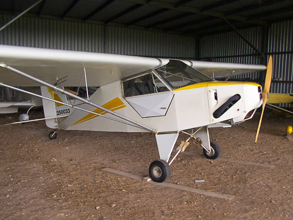

Wow Tony,I logged off after reading the first post to compile photos for my reply, now I'm not sure what to say?I've battled with the emotions of where our 'Ultralight' direction is heading for many years.On one hand wanting to keep 'Ultralights'ultralight, but on the other hand wanting get into really high performance 'Superlights' (to use an old Western Australian clubs name)Having come from flying high performance sailplanes, the idea of flying in scouts didn't really appeal to me.But now, looking at obviously lightweight G-A planes on the market, at the price they are, and the type of people they attract (Yeah, it's the green eyed monster!) I feel myself in a dilema; I'm happy to keep our club operating with it's two LightWings, flying aircraft affordable to the Joe in the street, and not push to upgrade to some mega-buck hot rod, just to attract the well heeled to our club. At the same time I'm busily working in my shed to produce a kit for a 503 powered single seater that will hopefully do in excess of 120 kts and some time in the future spawn a 500cc racing class!Any-way, back to the LightWing Mk II question...First a quick history lesson on 'contemporary' LightWings.(I'm not going to spell out the entire Hughes history)Production started with the LW-1, powered by a Rotax 532 (yes, the hand grenade) and was often reffered to as the 'BOX'

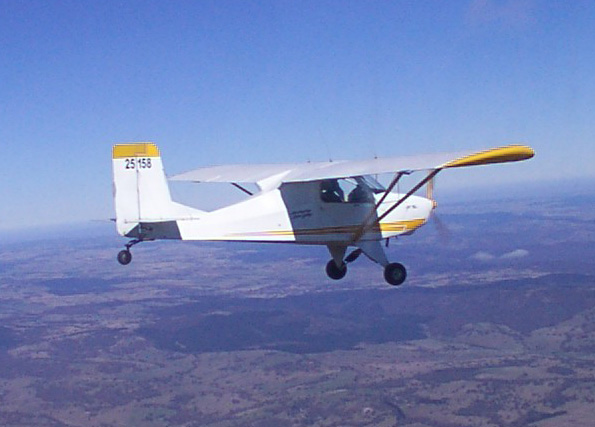

I first thought it was ugly, but after having flown Scouts, Thrusters and Drifters, to fly something that didn't flap and twist all over the place was very assuring. (sorry Tony)Our first LW-1 had rouond tube struts, no doors, a pull start and two small leaking fuel tanks.After about the third 'grenade' went off, we had to send the airframe back to Howie for a rebuild. It came back with the then new Rotax 582, with electric start, doors, carpet, bigger fibreglass wing tanks, a reduced fin, stronger tail wheel and the all new lowered turtle deck. :-}It's new designation was a GR-582.

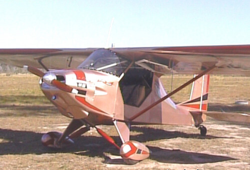

We liker this so much, we bought another one!Eventually though, $4!t happens and our new plane had it's front end written off. :-%When it came back from Howie, it was now an all new(ly referbished) GR-912 with an 80hp four stroke Rotax, long range alloy tanks, a stronger (still) tailwheel and a redesigned undercarriage?!

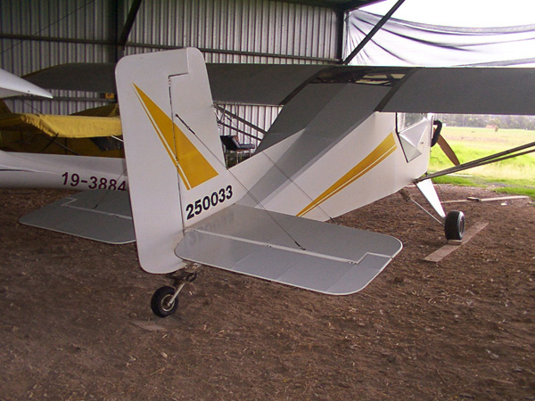

I was never happy with the new U/C, but in the last two years it's all I've instructed in, so I've gotten used to it. While our club stayed with these two LightWings, Howie moved on and had a crack at the low G-A end of the market,and produced the GA-55.

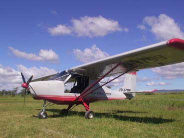

This actually happened before the Rotax 912's were affordable, so Howie, wanting to use a four stroke and keep the G-A types happy, used the Aeropower VW.The GA-55 also featured a totally new wing with less span, a faster wing section, a single strut and flaps!Unfortunately the combination of less wing and not a great deal of thrust changed the LightWing from something that would be airbourne almost by the time you reached full power (if you knew how to treat your two stroke propperly) to a plane that actually needed to build up speed along a runway.I don't think the GA series was ever certified as a factory built (most being kits) and it just sort of died off.I'm sure some GA-55's ended up with 912's, and would be interested to know how they perform?Finally, in the 'GR' line, howie would succomb to pressure and produce the GR-912'T' for trike geared version.
