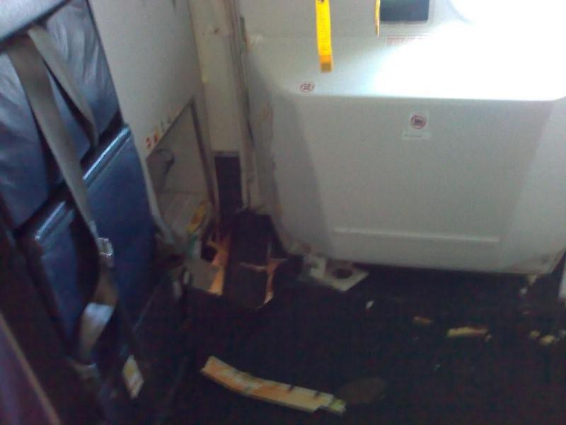

The whole report made sense until the last page...... so having made a hole in the floor, which the picture shows to be not much bigger than the diameter of the cylinder, the cylinder bashes the door, breaks, inverts biffs the roof, inverts again, falls down and neatly goes through the same hole that it made coming up...... If onlY i could be so lucky at lining up my lotto numbers........ Does this seem to be seriously stretching the co-incidences to anyone else.... Especially when you consider that in the sequence explained you have at least 3, possibly more pieces of cylinder, 2 of which were above the floor and none can be found......(well, actually the last drawing suggests that teh cylinder valve head was in the main cabin)

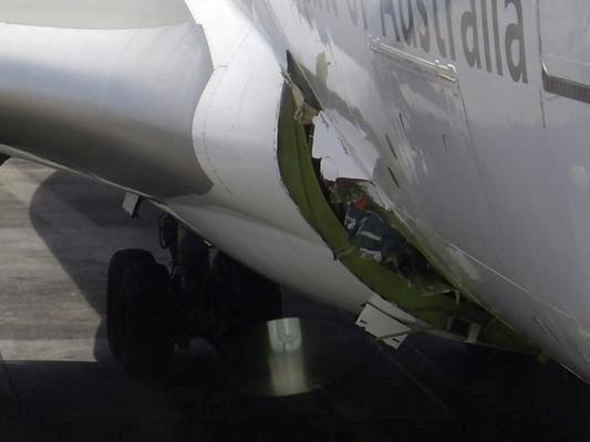

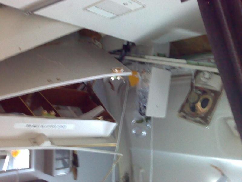

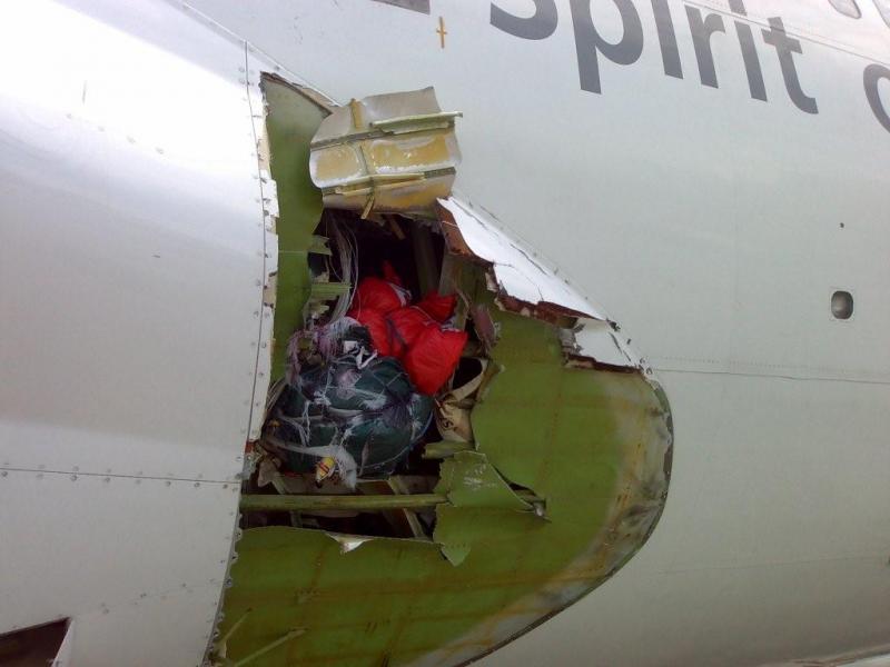

Hi all,
For your viewing:thumb_up:
Taken on the tarmac after the pax had disembarked
