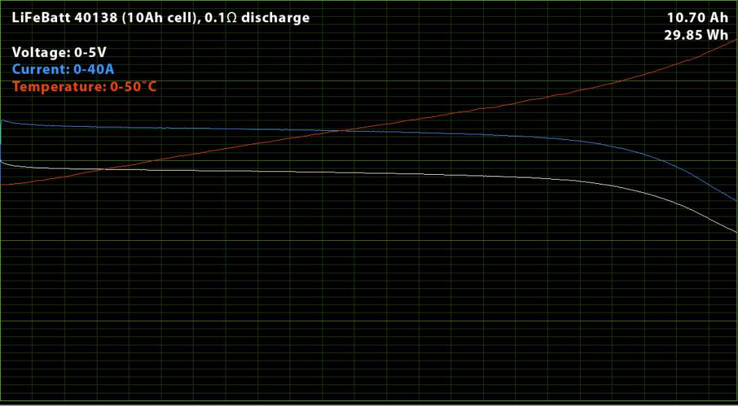

Guest lithbattboss Posted August 12, 2008 Posted August 12, 2008 Andy, I don't have a cell discharge curve for 25amps but I do have one at 40amps. This test was done in Perth a few months ago. You are absolutely correct about the different discharge characteristics of the two battery types. The lead acid battery voltage will gradually but steadily decrease as the battery discharges. As you rightly mentioned you might notice the battery slowly becoming flat by factors such as distortion in the audio etc. As you can see in the attached lithium discharge curve by the blue current and white voltage curves both are close to linear for approximately 90% of the cells capacity. During the last 10% of capacity is when the voltage and current decay quite rapidly. This means that the battery will appear to be providing close to full power even when it is almost fully dicharged and then the battery will go flat and lose power very suddenly. This is why in the u-tube video of the guy starting the motorbike engine, the engine cranks over without slowing down at all, right to the point of the battery becoming flat and then all of a sudden it dies. This is in stark contrast to what most people are familiar with a lead acid battery whereby as the voltage slowly drops during discharge, the cranking becomes more and more sluggish until the battery doesn't have enough power to turn the engine over anymore.
