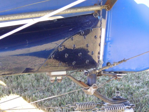

M61A1 Posted October 22, 2012 Posted October 22, 2012 I have these from a fly in... don't know whose aircraft, maybe of use. I would recommend (although the factory didn't do it) using a good quality epoxy primer on both the doubler and fuselage, and maybe some sealant in between for good measure. I am in the process of rebuilding a drifter, and everywhere there is stainless or steel against aluminium, there was dissimilar metal corrosion.
facthunter Posted October 22, 2012 Posted October 22, 2012 All the ones I used to fly had the mod. I understood that it was mandatory. It was also recommended to preflight check the area for cracking. Nev
USADrifter Posted October 22, 2012 Author Posted October 22, 2012 Thanks for posting the close up photo, that is a help!
