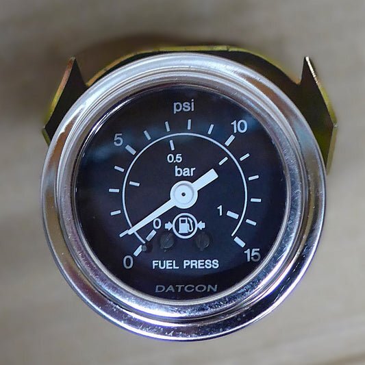

For the most part fuel pressure is between 4-5+psi.
The anomaly;
In Cruise, my Dynon will occasionally (it seems to be quite random) give me a low fuel pressure warning - Pressure may be indicating a low as 1 psi.
If I am high, I will just monitor the situaton and pressure will slowly recover, without any intervention on my part.
If low, I will turn on my Boost pump for an immediate increase to 5 psi - Turn off the pump, pressure remans between 4-5psi.
At no time has the engine ever hesitated.
