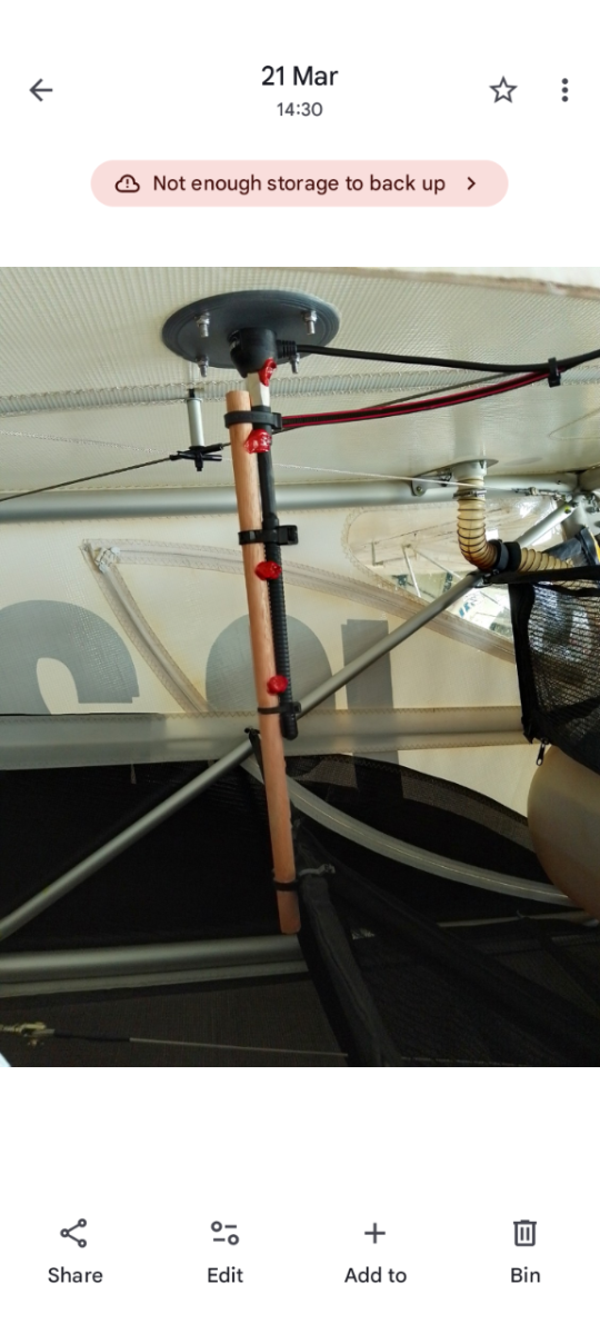

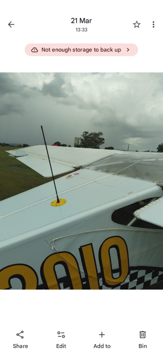

Arron25 Posted 4 hours ago Posted 4 hours ago (edited) The short loaded stub inside acts as the "ground plane" I have a MobileOne version. Edited 4 hours ago by Arron25
