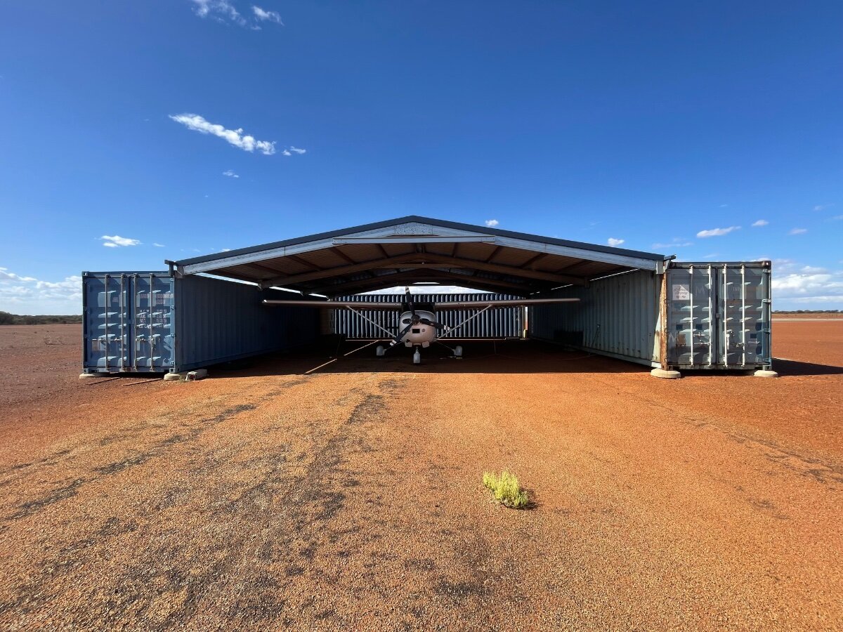

Moneybox Posted October 24, 2025 Posted October 24, 2025 A hanger at the Cue airport has to be a CASA approved structure and the dome shelter doesn’t meet the standard. The one hanger out there consists of the same two 40’ containers with a colour bond roof on a couple of trusses. It does look a lot better and will surely still be there long after the plastic shelter has degraded. 1

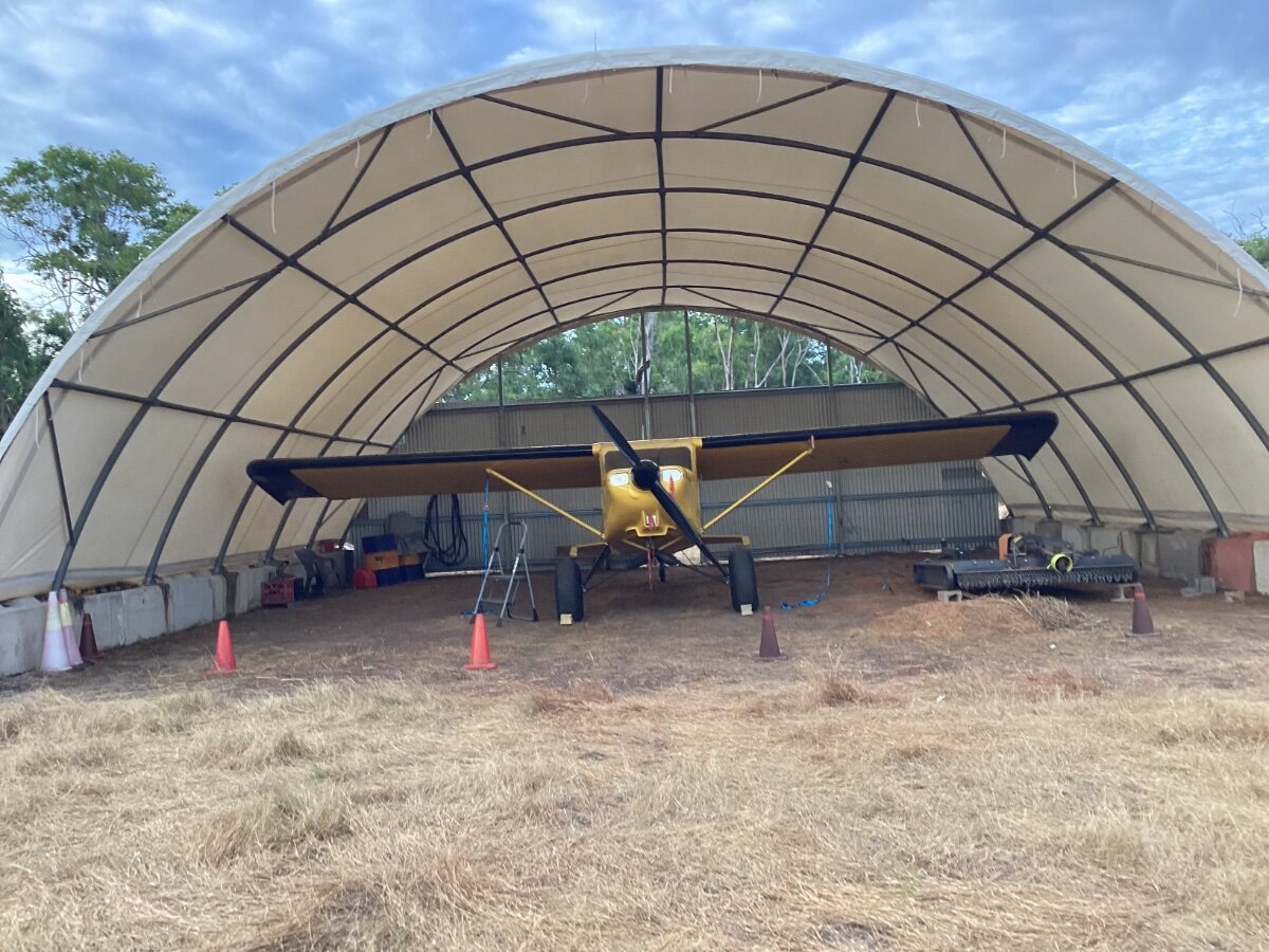

NT5224 Posted January 23 Posted January 23 (edited) Here’s mine Dome shelter. Total construction cost including concrete blocks and delivery 300km about $7000. It took my wife and I (two people) about a week to construct. Had it five years now. Went through two cyclones. It won’t last forever but when the tension membrane goes I’ll replace it for $2000. Alan Edited January 23 by NT5224 3 2

T510 Posted January 23 Posted January 23 9 hours ago, NT5224 said: Here’s mine Dome shelter. Total construction cost including concrete blocks and delivery 300km about $7000. It took my wife and I (two people) about a week to construct. Had it five years now. Went through two cyclones. It won’t last forever but when the tension membrane goes I’ll replace it for $2000. Alan That's a bargain. Mine is an All Shelter brand and they quoted me $14k for a replacement cover with tension kit ($8k without the tension kit) and $14k for a rear wall. 2
NT5224 Posted January 24 Posted January 24 1 hour ago, T510 said: That's a bargain. Mine is an All Shelter brand and they quoted me $14k for a replacement cover with tension kit ($8k without the tension kit) and $14k for a rear wall. Indeed. It’s a cheap Chinese brand Dome shelter. I picked it up from Pickles Auctions five years ago new after a mining project fell through. I recall it was $3000. It’s 12x12m, a standard size. A replacement tension membrane was advertised at $2000 online, generic brand. My tensioners all still work fine so no need to replace. I built the back wall using uprights and steel sourced from my local dump shop. It’s not pretty but working alone took me four days and estimated $1000 materials. Akan 2 1

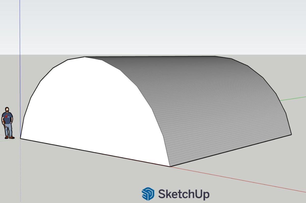

Moneybox Posted January 24 Posted January 24 (edited) 9 hours ago, T510 said: Allshelter know how to charge, they claim a superior Australian made product to the Chinese ones and offer a 10 year warrantee. Don't know the accuracy of their claims, I think the Chinese would definitely offer the better value, even if you have to replace them more often. I am reskinning mine in corrugated iron sheets. I'll add a rear wall and front doors too. Mine is ground mounted, not on containers Please excuse my crude drawing, I can't photograph it because I'm in Perth but this is the direction he laid the iron sheeting. Edited January 24 by Moneybox 2 1
