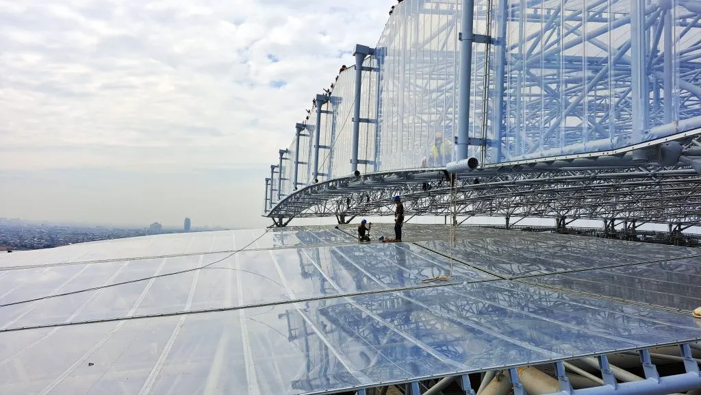

sfGnome Posted August 20, 2025 Posted August 20, 2025 As an amateur carpenter, I love laminated timber construction. You walk into a building with exposed laminated beams and it just feels warm. So much nicer than lumps of steel. I’m intrigued by the ETFE pillows for the roof. I wonder how they’d go with large hail? Would the springiness absorb the energy and cause the hail to just bounce off it like a trampoline? Impressive. 1
onetrack Posted August 20, 2025 Author Posted August 20, 2025 Yes, the durability of the ETFE pillows under a major hail attack has been tested, and found wanting. The Zurich Zoo has a large structure called the Masoala Rainforest building, which was built in 2002 with an ETFE pillow roof. Within a week of being completed, the MR building was hit with a massive hailstorm, comprising odd knobby hailstones up to 70mm in diameter! The roof was destroyed, and had to be replaced. When it was replaced, a redesign was introduced, with another separate ETFE membrane (also inflated) positioned above the main roof. A second major hailstorm hit the MR building again in 2004, and the protection membrane worked, and no damage was done to the main roof pillows - although the protective membrane was perforated in some places. It was not replaced, so I guess it was simply patched (they use adhesive tape to seal holes). It appears both the original roof, and the protective membrane of the MR building, are still in place. https://iibec.org/wp-content/uploads/2024/04/2007-Flueler.pdf
