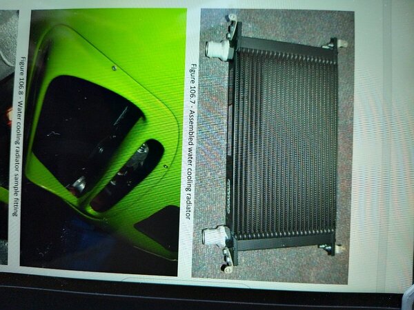

danny_galaga Posted July 1, 2025 Posted July 1, 2025 (edited) Thats good news. That price seems quite reasonable, similar in price to Setrab. Mayb Rotax radiators are made by Setrab 😄 Ha. Setrab cost MORE! Mind you, i think its a bigger radiator. This is what goes in the Bushcat: https://www.efisolutions.com.au/setrab-proline-std-oil-fluid-cooler-series-9-405mm~143016?srsltid=AfmBOoqZPRFVrt9dpFfaFCFrdlBTnnYo5pnc6ENs5a8rG0fEtEJMOTWS Edited July 1, 2025 by danny_galaga 1
skippydiesel Posted July 2, 2025 Posted July 2, 2025 There seems to be a small confusion in this thread between Radiators & Oil Coolers. Radiator - Name commonly use for coolant heat exchanger Oil Cooler - Name commonly used for - you guessed it, oil heat exchanger. In both cases they are air/liquid heat exchangers (there are liquid/liquid heat exchangers). Many similarities however, their design differences tend to reflect liquid viscosity and expected temperature & pressure ranges. Not saying that the one heat exchanger design, could not be used for oil or coolant, however I have never seen this and I would suggest that the targeted liquid is more likly to be efficiently cooled eg Danny-G's Setrab example looks to me to be an Oil Cooler., while Rodgerc's is a Coolant Radiator😈
danny_galaga Posted July 2, 2025 Posted July 2, 2025 53 minutes ago, skippydiesel said: There seems to be a small confusion in this thread between Radiators & Oil Coolers. Radiator - Name commonly use for coolant heat exchanger Oil Cooler - Name commonly used for - you guessed it, oil heat exchanger. In both cases they are air/liquid heat exchangers (there are liquid/liquid heat exchangers). Many similarities however, their design differences tend to reflect liquid viscosity and expected temperature & pressure ranges. Not saying that the one heat exchanger design, could not be used for oil or coolant, however I have never seen this and I would suggest that the targeted liquid is more likly to be efficiently cooled eg Danny-G's Setrab example looks to me to be an Oil Cooler., while Rodgerc's is a Coolant Radiator😈 In the case of my Setrab, it can be used for either. No confusion from me 😇 1
skippydiesel Posted July 2, 2025 Posted July 2, 2025 6 minutes ago, danny_galaga said: In the case of my Setrab, it can be used for either. No confusion from me 😇 Yes - as I acknowledged BUT how effective is the Setrab in BOTH roles??? Seems to me that if an oil cooler can be used as a coolant radiator, then this would be common practise - last time I looked its not. I would like to know the technical reasons why not.????? I am sure there are Forum members who would be fare more qualified to debate this than me😈
onetrack Posted July 2, 2025 Posted July 2, 2025 (edited) Oil coolers are constructed to withstand much higher internal pressures than radiators. Oil pressure can reach 90 - 100psi (620-690kPa), but cooling systems rarely develop more than 16psi (110kPa). Accordingly, cooling system rubber hoses are relatively light construction, whereas any rubber hose components in lube systems, are very robustly constructed. In fact, it pays to eliminate rubber hose components in lube systems, if at all possible, as they're a major source of failure and resultant emergencies and often, serious engine damage. There's also the viscosity and heat-transfer properties of oil and coolant to be considered. Oil is very viscous and flows a lot slower than coolant, and coolant has an improved film transfer coefficient when it comes to heat transfer. Simply put, coolant disperses heat much faster than oil. Oil coolers contain fluid passageways that are larger in dimensions than radiators, thus if they're used for coolant, the coolant is in contact with a reduced surface area for heat dissipation, and therefore your cooling rate for coolant is lower than for a radiator. Edited July 2, 2025 by onetrack addendum... 1
danny_galaga Posted July 2, 2025 Posted July 2, 2025 1 hour ago, skippydiesel said: Yes - as I acknowledged BUT how effective is the Setrab in BOTH roles??? Seems to me that if an oil cooler can be used as a coolant radiator, then this would be common practise - last time I looked its not. I would like to know the technical reasons why not.????? I am sure there are Forum members who would be fare more qualified to debate this than me😈 Right now I have to put tape on it to keep the temperature up. So I guess it's not too bad at its job 😇 1

skippydiesel Posted July 2, 2025 Posted July 2, 2025 2 hours ago, danny_galaga said: Right now I have to put tape on it to keep the temperature up. So I guess it's not too bad at its job 😇 I didnt not suggest using an oil cooler, for a coolant radiator, would not work, only that it may not be the best design for the job. Oil coolers usually ; Are of heavier construction, than needed for coolant - in aircraft all unnecessary weight is usually avoided Have smaller ID inlet/outlet pipes - this may result in the need for pipe reducers, more weight & complexity When perfectly satisfactory dedicated Radiators & Oil Coolers are available, I wonder why you or is it the kit supplier, would choose to do this??😈

danny_galaga Posted July 2, 2025 Posted July 2, 2025 (edited) 1 hour ago, skippydiesel said: I didnt not suggest using an oil cooler, for a coolant radiator, would not work, only that it may not be the best design for the job. Oil coolers usually ; Are of heavier construction, than needed for coolant - in aircraft all unnecessary weight is usually avoided Have smaller ID inlet/outlet pipes - this may result in the need for pipe reducers, more weight & complexity When perfectly satisfactory dedicated Radiators & Oil Coolers are available, I wonder why you or is it the kit supplier, would choose to do this??😈 I didn't randomly choose that radiator.. people much smarter than me, aeronautical engineers, chose that part number. Now I look at it, it seems bigger than the standard Rotax jobby. Considering that it's a low n slow plane from a hot country, and the particular location of the radiator, I'm guessing they crunched some numbers on a variety of options and this one did the job for a reasonable price 😇 Edited July 2, 2025 by danny_galaga 2 1

skippydiesel Posted July 3, 2025 Posted July 3, 2025 23 hours ago, danny_galaga said: I didn't randomly choose that radiator.. people much smarter than me, aeronautical engineers, chose that part number. Now I look at it, it seems bigger than the standard Rotax jobby. Considering that it's a low n slow plane from a hot country, and the particular location of the radiator, I'm guessing they crunched some numbers on a variety of options and this one did the job for a reasonable price 😇 Oh well there you go - I wonder why Rotax have stuck with the more conventional (PN 997083) ???😈 1

danny_galaga Posted July 3, 2025 Posted July 3, 2025 42 minutes ago, skippydiesel said: Oh well there you go - I wonder why Rotax have stuck with the more conventional (PN 997083) ???😈 I reckon maybe that one is for general low wing plane use, and slow draggy planes like mine are best off with something a bit different 2
skippydiesel Posted July 3, 2025 Posted July 3, 2025 15 hours ago, danny_galaga said: I reckon maybe that one is for general low wing plane use, and slow draggy planes like mine are best off with something a bit different Speculation: For Rotax 9 powered aircraft, high / low / rotating, the Rotax radiator is the norm - Your dual purpose oil/coolant, the exception. Nothing wrong with that of course😈 1
danny_galaga Posted July 4, 2025 Posted July 4, 2025 (edited) 1 hour ago, skippydiesel said: Speculation: For Rotax 9 powered aircraft, high / low / rotating, the Rotax radiator is the norm - Your dual purpose oil/coolant, the exception. Nothing wrong with that of course😈 It's much the same size in the similarly performing zenith and savannah 701. What's your theory then, since the radiators are roughly the same price? Seems to me a slow aircraft could do with a larger radiator. Maybe you ought to write to the bush plane manufacturers and tell them they've been doing it all wrong 😇 Edited July 4, 2025 by danny_galaga 1
skippydiesel Posted July 4, 2025 Posted July 4, 2025 2 minutes ago, danny_galaga said: It's much the same size in the similarly performing zenith and savannah 701. What's your theory then, since the radiators are roughly the same price? Seems to me a slow aircraft could do with a larger radiator. Maybe you ought to write to the bush plane manufacturers and tell them they've been doing it all wrong 😇 I have never suggested you (Zenith et al) are wrong, only that the approach is somewhat unconventional. I like unconventional, especially when it works. Despite this I am not a fan of "reinventing the wheel" for no apparent gain. I still wonder at the choice, given the diffrent viscosities of oil & coolant (water) and I assume the Setrab heat exchanger has been optimised for oil (it looks like an oil cooler). In addition, the Rotax 9 coolant system will have 25 mm OD hose connections , so at some point reducers will have to be fitted to get down to the Setrab inlet/outlet dimensions - added weight, more joins ????😈 1

danny_galaga Posted July 4, 2025 Posted July 4, 2025 1 hour ago, skippydiesel said: I have never suggested you (Zenith et al) are wrong, only that the approach is somewhat unconventional. I like unconventional, especially when it works. Despite this I am not a fan of "reinventing the wheel" for no apparent gain. I still wonder at the choice, given the diffrent viscosities of oil & coolant (water) and I assume the Setrab heat exchanger has been optimised for oil (it looks like an oil cooler). In addition, the Rotax 9 coolant system will have 25 mm OD hose connections , so at some point reducers will have to be fitted to get down to the Setrab inlet/outlet dimensions - added weight, more joins ????😈 The port size is 22mm, not as small as you are probably imagining 1 1
