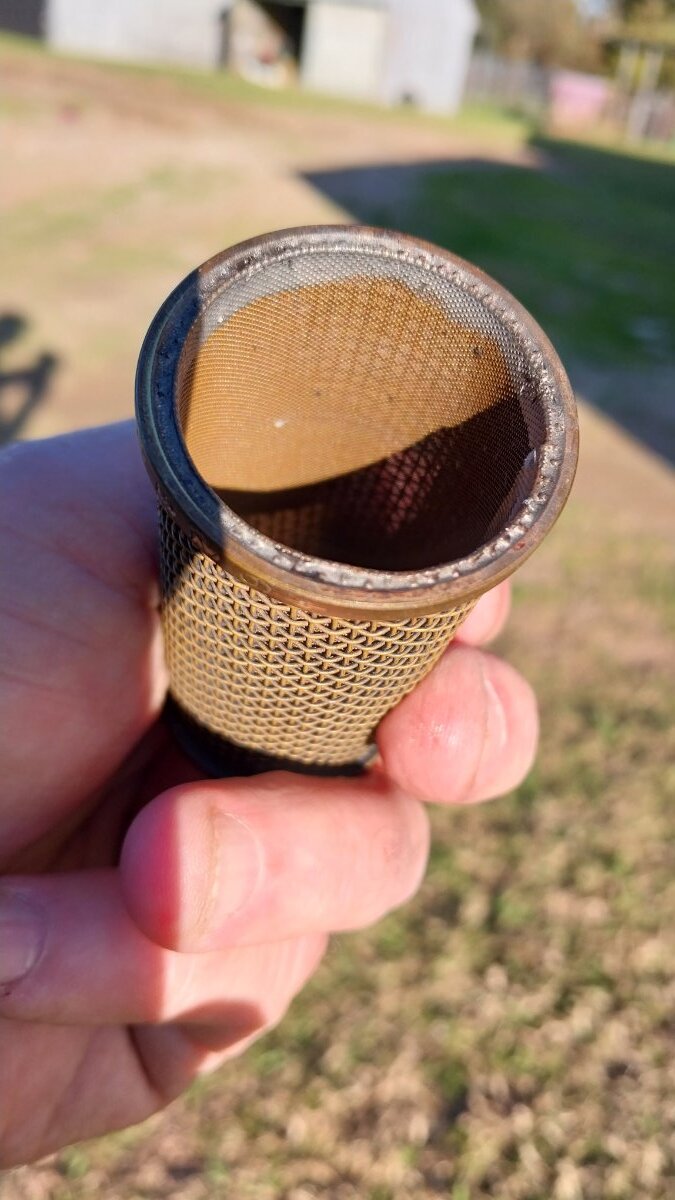

facthunter Posted September 6, 2023 Posted September 6, 2023 Anti drain back is fairly recent. It's only a rubber like diaphragm which could easily have a slow leak. The bypass arrangement by passes all oil including any gunk that's in the oil. Better dirty oil than no oil is the logic.. My Cont 16 F had a fine brass gauze mesh that you just remove and clean now and again. Sams as the Peugeot 203 had in principle. Nev. 1 1
