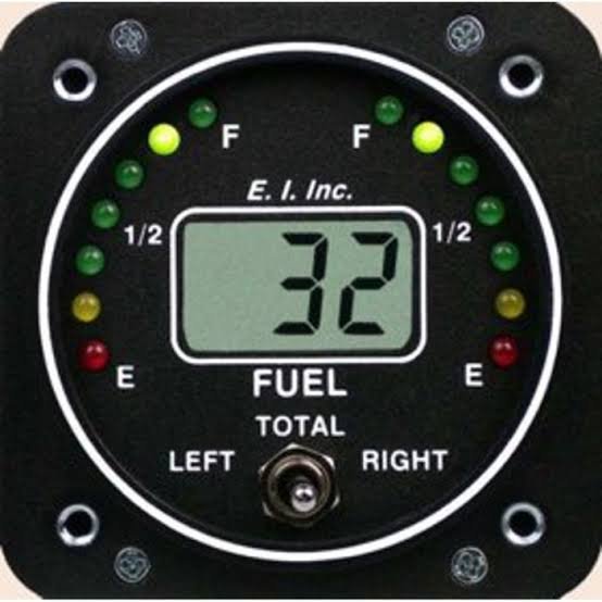

Thruster88 Posted July 19, 2023 Posted July 19, 2023 I did not install the old school float and variable resistance senders in my RV. They work very well. Due to the shape of wing tanks they only show 45L per side of the 70l tank when full, once 25l is burned off they show litres remaining very accurately. They are connected to one of these gauges.
