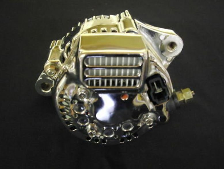

waraton Posted April 21, 2023 Posted April 21, 2023 During routine maintenance I have misplaced the 3 backplate fastening bolts from the CAMit 40a alternator. Hopefully someone has an idea about what bolts I need.

440032 Posted April 22, 2023 Posted April 22, 2023 Looks exactly like a generic 40A Kubota alternator cover. 6mm metric, with 10mm hex & phillips head. 6mm bolts are everywhere on a car and associated items like this. If they are just to hold the cover on, they are probably short - 10mm long thread or so. Get some at the hardware store, install, reinstall to motor, cleanup tools and pack them away, then find three screws left over. 3

onetrack Posted April 23, 2023 Posted April 23, 2023 (edited) The alternator looks suspiciously like this one (below) on eBay - a generic "mini" 70 amp alternator. The cover plate is held on with standard 6mm flanged-head automotive screws, usually supplied with a Phillips screwdriver recess in the head, as well as a 10mm hex head - as 440032 says. You can usually find these screws in the "Champion", "handy packs" rotating stands, at your local automotive parts supplier. https://www.ebay.com.au/itm/284451375074 The bolt is actually a standard SEMS panel fastener, I buy them in lots of 25 to 50 at a time from JNS Fasteners, you always seem to need them. https://www.jnsfasteners.com.au/collections/bolts-and-fasteners Edited April 23, 2023 by onetrack 1
waraton Posted April 23, 2023 Author Posted April 23, 2023 11 hours ago, 440032 said: cleanup tools and pack them away, then find three screws left over. That's exactly what will happen, they will be with the exhaust springs which are also missing! 7 hours ago, facthunter said: might hold more than the cover Definitely only securing the cover but thanks for the heads up 7 hours ago, onetrack said: You can usually find these screws in the "Champion", "handy packs" rotating stand Thats where Ill be when they open in the morning ...thanks 2

waraton Posted April 27, 2023 Author Posted April 27, 2023 Just an update...the bolts were 4mm hex head...rodknee was all over this and picked it, phoned me the other night ...Thanks. So for the record CAMit 40a alternator backplate cover screws are automotive 4mm hex head 20mm. 1 1
