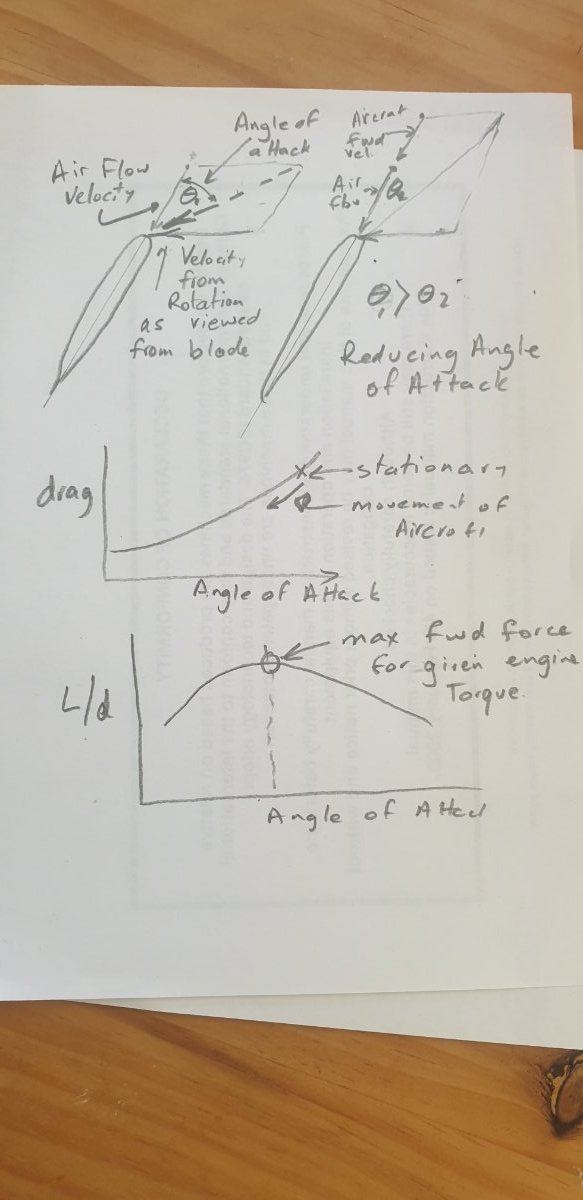

Geoff_H Posted December 5, 2022 Posted December 5, 2022 I have roughly sketched the mathematical reason for engine speeding up as aircraft moves forward. Sorry it is so rough but somewhat busy at present. In summary, as the aircraft moves forward angle of incidence of prop blade to air gets smaller, thus the drag on the prop gets smaller so the engine speed will increase 2
facthunter Posted December 5, 2022 Posted December 5, 2022 Same as overspeeding the engine in a dive. Airspeed affects a fixed Pitch prop always. AT higher speeds the air will be driving the engine. The energy for that is from height loss. Nev 1
