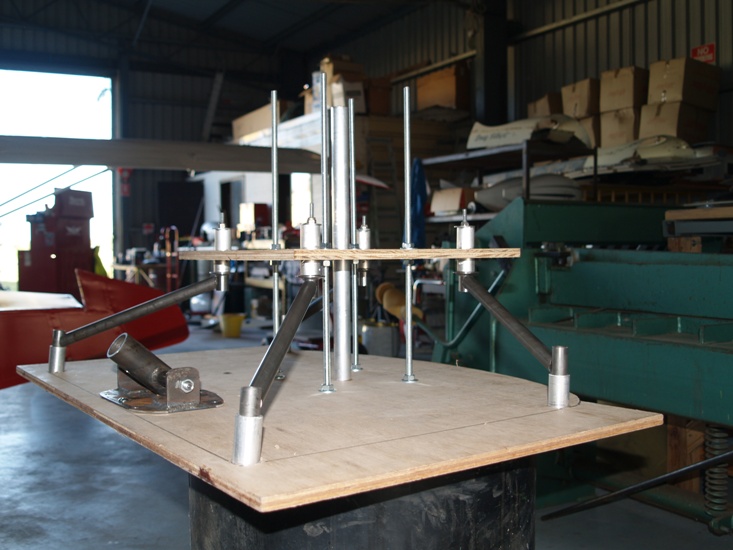

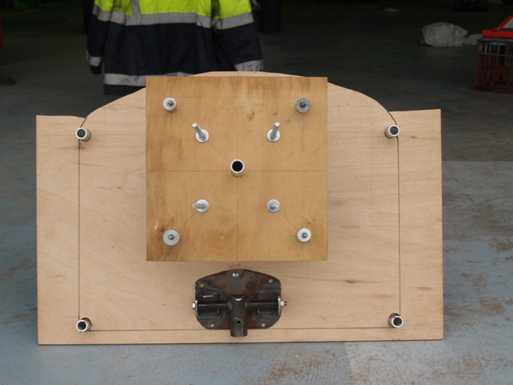

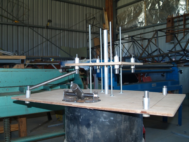

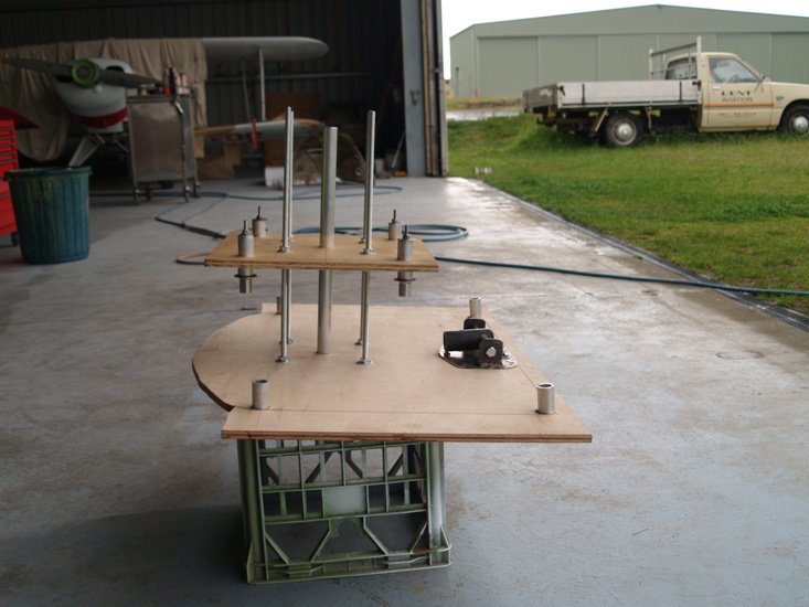

The first step in making the engine mount was to make a jig so that the spatial arrangment of the components was set before any cutting and fitting was done.
The jig consisted of a base board which represented the firewall of the aircraft. Short lengths of tubing were inserted into the back board to replicate the fuselage longerons. Note how the lower pieces of tubing emerge at an angle from the firewall.
Engine mounts were fitted to another piece of board, and threaded rod was used to set the distance between the firewall and the engine mount board. Use of threaded road allowed the engine mount locations to be varied to allow for displacement of the engine's thrust line to the left or right, and up and down.
In this instance, the nose wheel attachment bracket was attached to the firewall board so that struts could be fitted between the bracket and the engine mount.
After all distances and angles were checked for accuracy, construction of the engine mount began.
Short pieces of tubing, all of equal length, were cut and fitted into the longeron positions. Then further lengths of tubing were fitted to reach from the longeron tubing to their adjacent engine mounts. The ends of these lengths were 'bird mouthed' to enable them to be welded to the short longeron inserts and the engine mounts.
