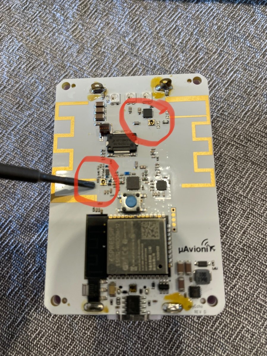

Brianc Posted July 4, 2022 Posted July 4, 2022 Just found two antenna ports on the sky echo. Can any one tell me which one is the gps and which one is the ADSB.
RFguy Posted July 4, 2022 Posted July 4, 2022 actually from memory one of those ports is the unused other transponder in it (unused in australia). turn the unit over the GPS should be visible. in fact I think it is at the bottom of your pic.
Brianc Posted July 4, 2022 Posted July 4, 2022 I am only looking for an adsb one to plug an antenna external antenna into.
RFguy Posted July 4, 2022 Posted July 4, 2022 Mark Kyle figured that out already, he'll chime in I am sure.
