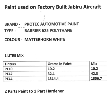

Thanks very much to the folks at Jabiru for this information :
below in the picture, is the paint mix, a 2 pack.
and, also
"The paint code which is attached also another customer let me know of a spray can that he said was very close from Autobarn which is Matterhorn White KK47 but I have not seen this only information from a customer that tried it."
