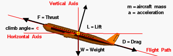

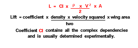

old man emu Posted January 22, 2021 Posted January 22, 2021 I hope I've read into the question correctly and we are back into the Lift equation, albeit this time in purely practical terms We want to calculate what conditions are need for a wing to generate sufficient Lift to balance, or exceed the weight of the aircraft. So let's look at what can and cannot change in that formula. Total Lift - This is the result of the calculation. Coefficient of Lift - unchangeable as it is part of the aerofoil design Density - We know that is a variable thing. Velocity - That's in True Airspeed, and since density and temperature are involved, it is a variable Wing Area - That is part of the aircraft design so in unchangeable. If we acknowledge the involvement of Coefficient of Lift and wing area in lift creation, but know that they are not variables, we can assign them the value of one (1) for calculation purposes. Therefore the Lift equation becomes Lift = {1 x (density x TAS)^2 x 1} /2 If you know the air density and the TAS you can calculate Lift. If, on the other hand , you know what Lift you need, then you have to fiddle with density and TAS. In this case, because you are operating from a certain altitude and at a certain known density, then by pluging in the known density and fiddling with the TAS you can calculate how much faster your takeoff speed will be above the speed for MYOW.

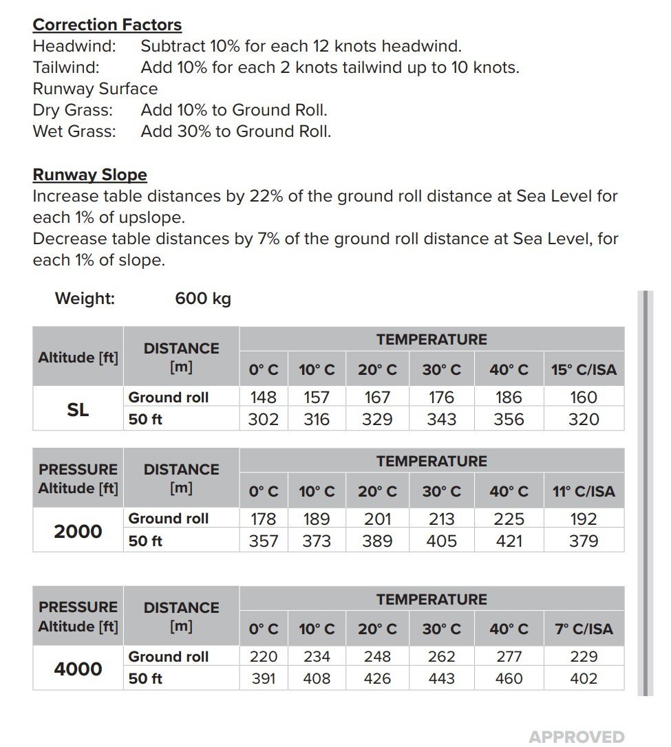

FlyBoy1960 Posted January 22, 2021 Posted January 22, 2021 all of this should be in the manual for every aircraft. They are easy formulas to calculate but some manufacturers include simple tables like this for people that don't have a calculator 2 1
old man emu Posted January 22, 2021 Posted January 22, 2021 2 hours ago, FlyBoy1960 said: They are easy formulas to calculate but some manufacturers include simple tables like this for people that don't have a calculator That table is not good for answering the OP's original question. If the published MTOW is exceeded, can you calculate how much above it the wings can lift. Clearly the question relates to going beyond manufacturer's advice. Remember that the in one famous operation in DC-3 (or C-47) aircraft, they overloaded the planes like a Tokyo commuter train and they still flew. I'm hoping for some discussion on the assumptions I made. This is an interesting topic. There is one factor that the Lift formula cannot account for, and that is the location of the Centre of Gravity. I suspect that an aircraft's wing is capable of generating very much more lift that would be required, but getting the Balance within the envelope might be the idea's killer.

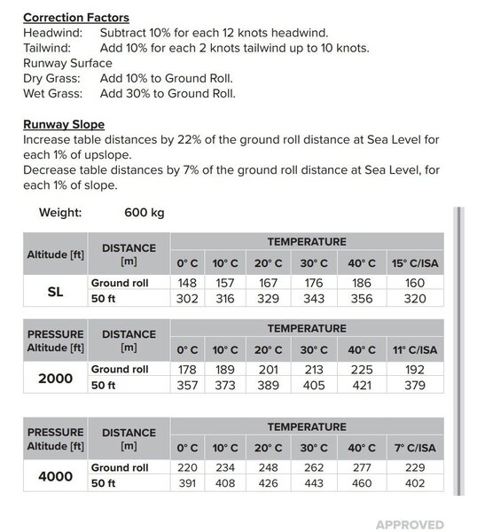

old man emu Posted January 22, 2021 Posted January 22, 2021 Apennameandthat has one of these, A-22LS which is the Light-sport version for the American market with a higher gross weight of 600 kg (1,323 lb) for the landplane and 650 kg (1,433 lb) for the seaplane. So, if you add a really drag-inducing undercarriage you can increase the MTOW by 50 kg. It seems logical that the same plane, with a much less drag-inducing u/c can easily take off with an all-up weight of 650 kg. Using this data from Camden airport at 4:00pm 22/1/21 Airfield elevation: 230' Temperature : 36C Air pressure: 1005.9 mb Humidity 13% you get a density altitude of 3100' 11 hours ago, skippydiesel said: a Forum member could be thought to be confession/advocating the deliberate breaking of the rules covering the operation of an RAA registered aircraft. If you take note of the title to this thread, it contains the word "VIRTUAL". To me that implies that the question calls for an exploration of the effects of putting a variety of numbers into the Lift formula, Lift = {1 x (density x TAS)^2 x 1} /2 turning the handle and seeing what comes out the other end. There's no inference that anyone has, or plans to, use the results of that exploration to exceed the MTOW of their aircraft. If anything, the results of the exploration would show that 1. Lift is dependant on air density for a given TAS 2. Lift is dependant on TAS for a given air density 3. Lift is dependant on the combined effects of air density and TAS. For those who don't like working with algebra and mathematics, the exploration would show that for a given air density different from 1013 mb you have to go faster to get the same lift as at 1013 mb. This translates to: 1. Faster speed on the ground before you can rotate, and the other way, faster speed on the ground at the flare. 2. Longer ground roll on take off because it takes longer to accelerate to rotation speed, and the other way because touchdown ground speed is higher. 3. Longer ground roll on take off because air density affects power output of normally aspirated IC engines. I'm not going to list the further effects of temperature and density on aircraft performance once in the air as that's worth its own thread. 1
