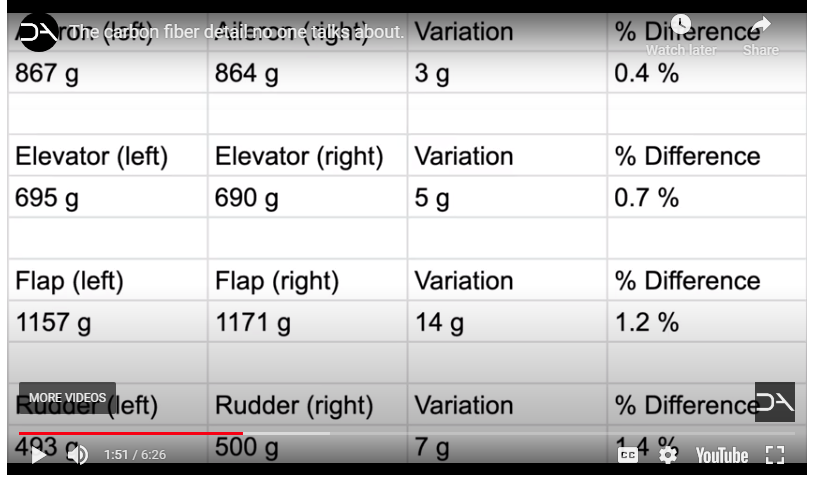

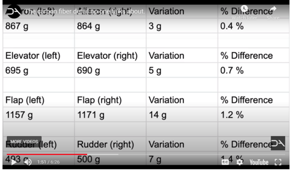

These are the variations in weight he is talking about
What common thing can you use to get an idea of these differences? A spoonful of sugar, not only helps the medicine go down, it weighs 4.8 grams.
He raises an interesting point for discussion. In theory one would think that making parts they way these people did would produce identical products, but when practice sticks its grubby finger into the pie perfect repeatability goes out the door. Unfortunately there are only two of each component, which makes useful statistical analysis impossible. If there were twenty or more of each component to add to the data then some practical use could be made of the analysis.
These people are being influenced by the accuracy they are getting from CNC and 3D-printing. If I could make several different components and come as close to identical as they have, I'd be happy.
