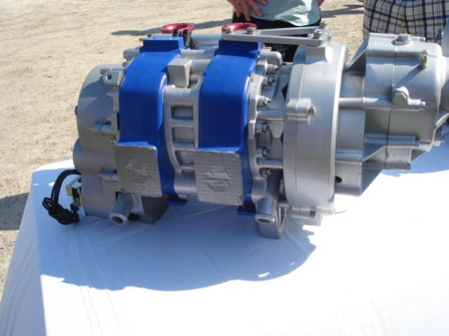

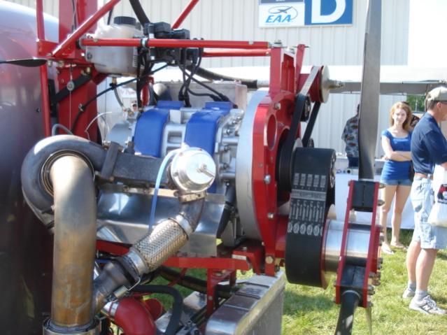

Guest ozzie Posted August 11, 2008 Posted August 11, 2008 Rotary at airventure I have some info on this coming in the mail that i will add when it arrives till then here are some photos of it on the stand and fitted to a gyro ozzie
