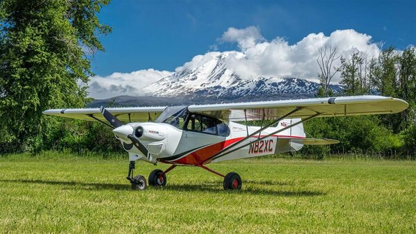

Sam the Swiss Posted February 9, 2020 Author Posted February 9, 2020 CubCrafters' newest move: a trike. The front wheel is extraordinarily close to the front end. This probably reduces the weight on it and allows for the drag design of it which makes it less vulnerable to stones and the like. As in snow flying there is no breaking (the landing strip normally runs uphill), this setup should work great if the ski on the front wheel is big enough. Now this is an expensive plane. But the Savannahs and the Foxbats should also be able to do that, as they go bush flying often. Any comments of the Savannah and Foxbat pilots?

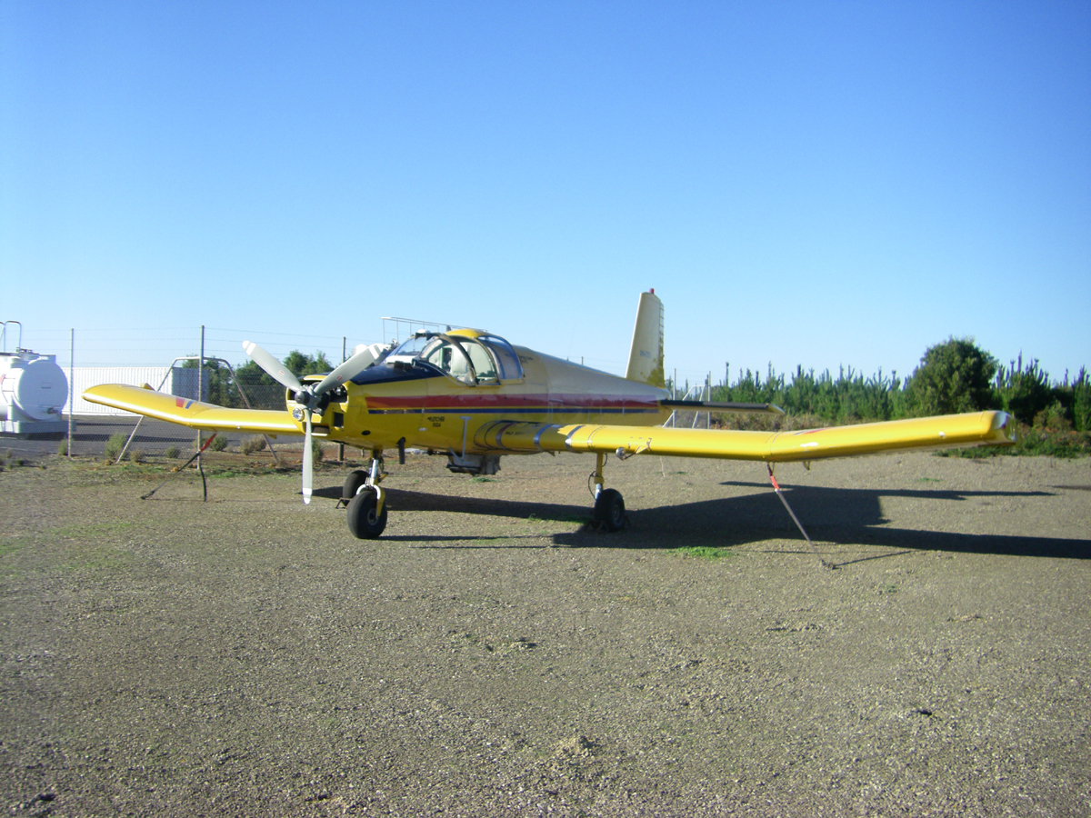

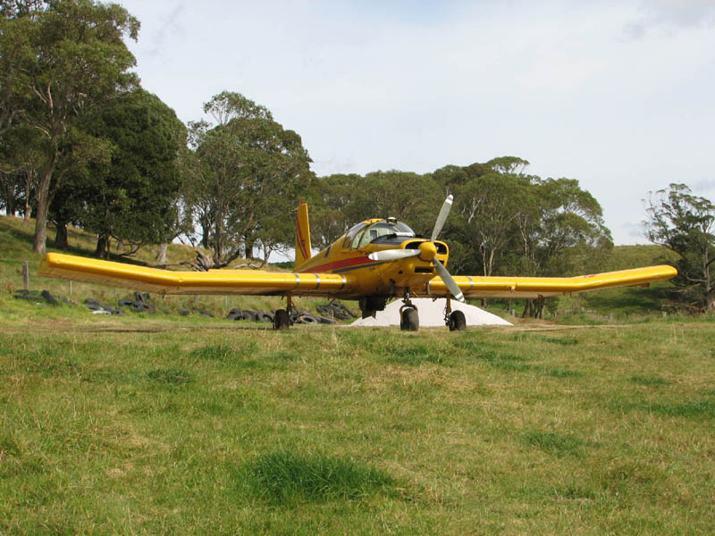

Student Pilot Posted February 10, 2020 Posted February 10, 2020 Lyc 720 so plenty of power, lift ton off a 250 metre airstrip at sea level. Can buy them now for around 60K Euro, with fuel flow of around 75 litres an hour in cruise at 115 knots. Just the machine for a Sunday fly for the $200 burger 2
ClintonB Posted February 10, 2020 Posted February 10, 2020 If you have too many burgers( like 100) it should still lift you off, without the fertaliser in the hold
