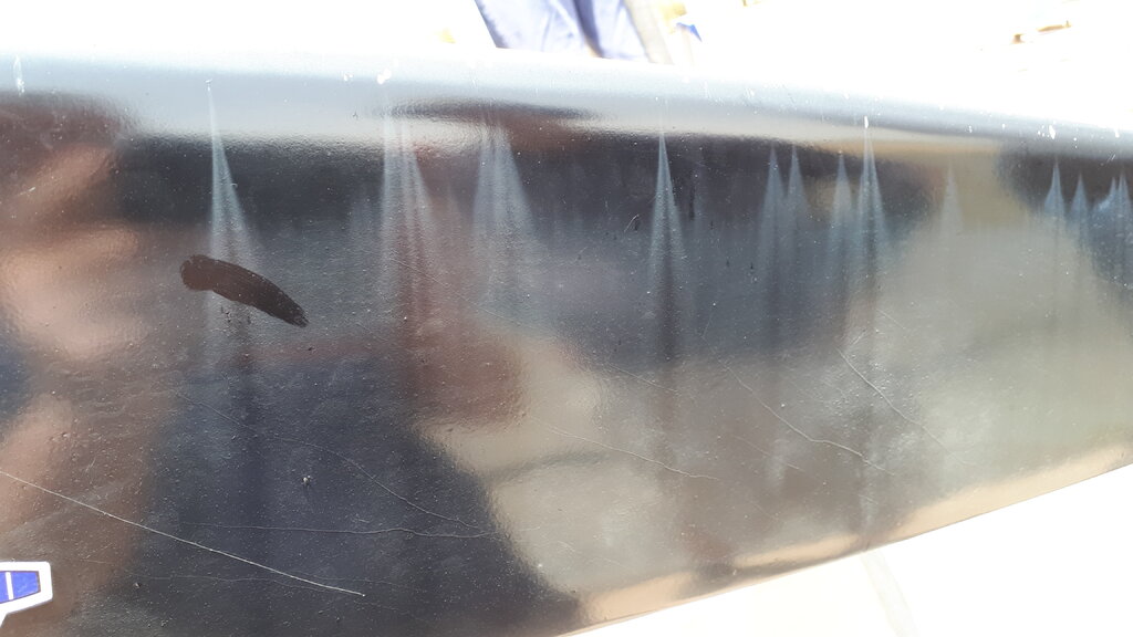

We flew to a job today in the bosses beautiful cessna 180, about two hours in light smoke. Picture shows the prop blade out near the tip, even a tiny nick in the paint caused these trails to form. It is interesting to me how the turbulence or whatever is happening fanned out so much. Anyone got an explanation?

The "nicks" affect the boundary layer airflow. The separation gets greater as the flow gets further from the leading edge. Probably tar in the smoke leaves the trails. It will come off with a bit of eucalyptus oil. Nev

The boundary layer at the leading edge is very thin and a tiny protrusion can trip the laminar flow into turbulent flow. The turbulent flow spreads and it makes those tracks.
There is quite an effect on performance, since turbulent flow is about ten times the drag of laminar flow.

All wings ( and a propeller is a rotating wing) are laminar flow at the start. The so-called laminar flow airfoils are designed to have more laminar flow than the others. As Facthunter alludes to, laminar flow has the bad characteristic of separating from the surface and making the drag worse than ever.  So some airfoils work with turbulators which deliberately trip the laminar flow into turbulent flow. If you put on the turbulator too far forward, you give away a bit of low-drag area and if you put it too far back, into the separated flow part, then it does nothing.
