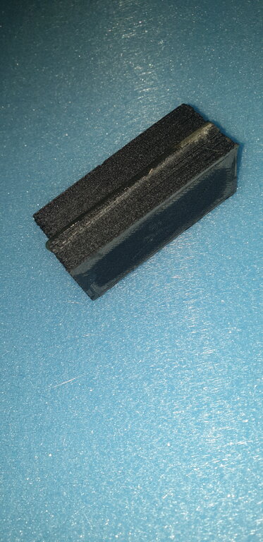

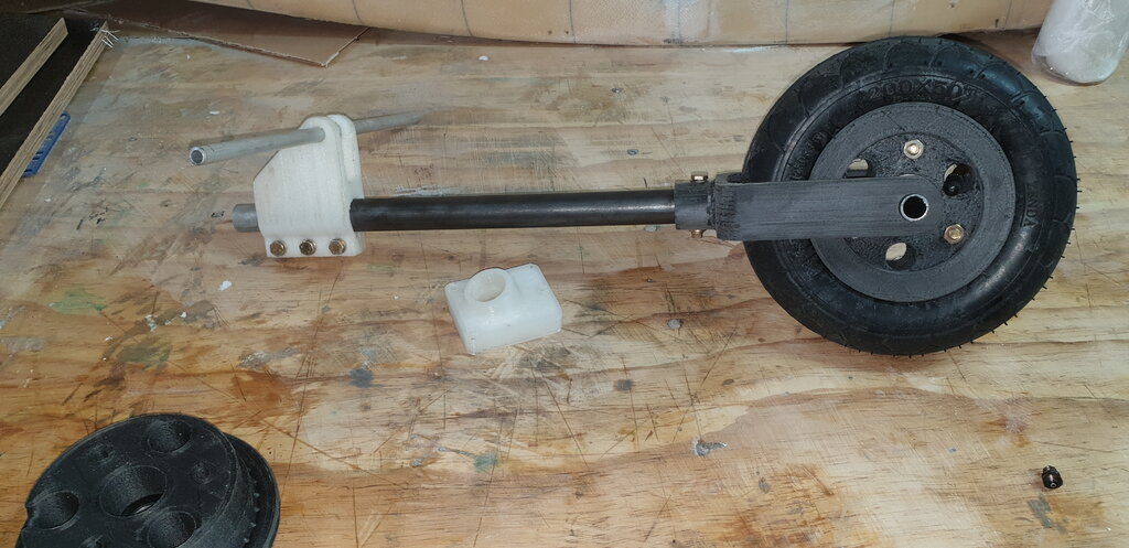

Hey the bond between layers is welding in a most controlled manner.  I have.made wheels amd forks etc.  Interlayer strength is ALWAYS tested.  You wouldn't believe the testing method, crude to say the least.  The layers are hit with a 10 pound hammer in a manner that puts shear stress on the bond.  However one must know how to print to get the best results.  I will send a picture soon.  I am so impressed with printed parts that the engine frame will be 3d printed.
Only steel part is the rod, all else either nylon or carbon Nylon.Tyre has 50 psi in it, held ok for a month

Two of my test pieces.  Glued together with 5minute epoxy, and clamped for 24 hours.  I couldn't separate them with a hammer.  I was surprised at the strength.  I will make the flaperons in nylon carbon and epoxy, 12 inch  a piece and glue them together.
