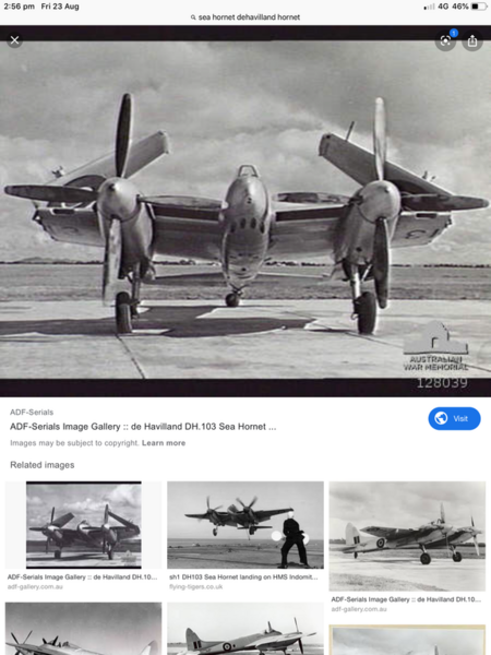

skippydiesel Posted August 23, 2019 Posted August 23, 2019 I thought Merlines did come in CR variants - did not the DH Hornet have "handed" engines for carrier ops ??
derekliston Posted August 23, 2019 Posted August 23, 2019 I thought Merlines did come in CR variants - did not the DH Hornet have "handed" engines for carrier ops ?? Don’t know, I will check, thus far I haven’t been able to find other than ‘American’ clockwise viewed from the cockpit. I think the British ones going ACW was a left over from the days of hand swinging props.
derekliston Posted August 23, 2019 Posted August 23, 2019 Don’t know, I will check, thus far I haven’t been able to find other than ‘American’ clockwise viewed from the cockpit. I think the British ones going ACW was a left over from the days of hand swinging props. Checked such photographs as I could find and you are correct. They must have been in the minority!
facthunter Posted August 23, 2019 Author Posted August 23, 2019 It is more efficient and you don't have a "critical" engine. Both engines have the same VMC(a). For "normal" operators it means more spares must be available for two engines and props where they vary, so many don't do the option. Nev
skippydiesel Posted August 23, 2019 Posted August 23, 2019 To add to Nev's observation - From my reading, it would appear that having CR engines for carrier opps makes the pilot workload less. I only have a single engine rating, so with no experience, speculation and low tech understanding, I understand this to mean that the aircraft will not swing on take off as the DH Hornets predecessor (DH Mosquito with out handed engines) was supposed to do.
derekliston Posted August 23, 2019 Posted August 23, 2019 To add to Nev's observation - From my reading, it would appear that having CR engines for carrier opps makes the pilot workload less. I only have a single engine rating, so with no experience, speculation and low tech understanding, I understand this to mean that the aircraft will not swing on take off as the DH Hornets predecessor (DH Mosquito with out handed engines) was supposed to do. Not just the Mosquito. A pilot I knew and flew with used to start the take-off roll in a Dragon Rapide at the extreme left of the runway so that it was still on the runway by the time the rudder became effective.
facthunter Posted August 23, 2019 Author Posted August 23, 2019 The mosquito had a very small (typically DH shaped)rudder as many speed planes have and also has much more powerful motors about six times the Dragonfly's engines power. A mosquito would usually get airborne before VMC (a) but the "forces" even did that with the DC3 on shorter strips. The directional problem is at lower speeds and you feed the power on cautiously and evenly till the rudder is effective then you have the lot on..but have to recognise that an engine failure before VMC(a) means you cannot keep it straight without reducing power on the good engine. CR props could be designed to make a twin engined plane very easy to manage with assy(metric) power if combined with inclined thrust (looking from above). It doesn't have much bearing on ultralight flying otherwise , except in a general concept mind exercise when we see planes crashing due to not managing assy power (and energy) well. Nev
