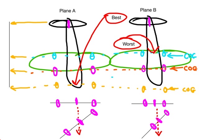

The particular aircraft matters a lot.
In choosing the main wheels location the designer has the following dilemma: If the wheels are too far back, the plane is easily put on its nose or overturned by braking forces. Old free-flight models often had the wheels well forward of the nose for this reason.
BUT this resistance to overturning comes at the price of groundlooping: The groundlooping moment is the product of the braking force and the distance between the c of g and the wheels.
If the wheels are real close to the c of g, the groundlooping tendancy is small.
Different designers have chosen different compromises.

No matter how you land a tailwheel plane it's going to end up on it's tailwheel at some stage during the landing roll. That places the wheels at their most directionally unstable forward position in relation to the C of G and often not much airflow over the tailfeathers. A 3 point landing has the plane at minimum forward speed which helps if you lose it. It's a good short (or rough surface) field method.
You can also lose it taking off, IF you wrap on the power and raise the tail at the same time. IF you are smarter you will roll forward a definite distance before giving it the gun gradually and you lift the tail to avoid unsticking too slow which will happen if you leave it in the 3 point attitude for long enough and thereby allow lift off prematurely. You can also see where you are going better in some planes. ( C-180 types) You don't have to groundloop if you are cautious and good with your feet and READY to correct swings early rather than wait till full rudder won't do it. Crosswinds reduce rudder effectiveness ONE way. Gusty conditions make a wheeler mandatory and you must pin it on with forward stick (prop clearance limiting). IF it bounces first you will have a bad day as will be the case if you brake hard as you slow right up.. That's when you do like the wheels well forward. There IS a difference.... with Tailwheel. Not when you are flying. It's only when you are at the bottom of the sky and still moving.. Nev
I’m definitely not an aeronautical engineer. You can tell by the sketch above. Engineers call it “design by crayon”
However, this is how I design. I am a reasonably successful designer. Exaggerate the problems and look at them. Not saying you’d want to be flying plane A Best. Can’t imagine you could get it into a flying attitude until about 100 knots. Maybe it’d stay stalled the whole time. You’d take off by flying an over the hill runway. Plane B has a prop that is digging into the ground. It’s not going anywhere. Now, keeping in mind I’ve yet to pilot a tail wheel I think I’d land plane A best with bugger all chance of ground looping.
Mike it's not so much the track that matters, it's the turning couple between the side load on the mains and the C of G when the plane deviates from a straight line and does a turn. Centripetal? Force. Nev

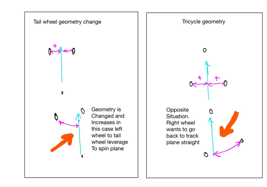

Well, I’m starting to understand C of G and elevator induced load on that tail wheel plays a part. Looking at the whole dance going on as the aircraft puts weight on that rear wheel then starts to influence and potentially command the tail ends track. We have the fact that removing the tail wheel from the ground will remove its influence.
Returned to rudder directed rear swing.
Put the tail wheel back on the ground very lightly and it isn’t going to do much. Add back elevator and it’s more able to influence the aircrafts track. In a straight line and continuing straight all is well. Now, we add a rudder or one side brake induced influence on the tail wheel. The heavier the elevator pressure the less likely the rear wheel can move off track.
So, because I want to ground loop I’ll need to remove elevator pressure. As the body of the aircraft is swinging around I’ll have a small amount of time during which the elevator will remain useful to regain tail wheel purchase on the runway if I suddenly lose interest in ground looping as a new experience.
However, it won’t be long before the plane is so side on to the airflow that the elevator is useless.
At some point along the way the front wheel track has the inside wheel of the beginning loop also gaining much more command over the planes former interest in proceeding straight ahead. It’s at this point my example of a wide front wheel track comes into play and the aircraft could possibly be brought back to its former course.
In the process of writing this I also see my former expectation the wider wheel track is more stable remains true. It’s however far more important to have the tail wheel firmly in touch with the ground. Particularly as the aircraft slows and it would seem logical that it is when the planes lower inertia and less airflow command combine the narrower ground track could swing the back end around no matter how much elevator is applied as it’s becoming useless.
I don’t even want to think about brakes. Maybe my summer USA plan to learn tail wheel isn’t a good one or it’s a really exciting challenging one?
