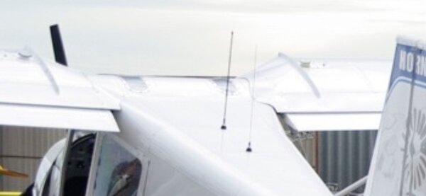

Old Koreelah Posted July 22, 2019 Posted July 22, 2019 That could be a problem, especially as the wings slope down to the root which slopes straight on to the top window. Any overflow or splash would trickle straight on to it. The only good thing is that the top window is not stressed at all, it's basically flat. Guess I'll just have to take a lot of care with fuelling. Have a look at Ollie Hartman's Hornets. Their "wing fences" don't have an aeronautical function- they're there to divert spilled fuel away from the plolycarb screen. 4
