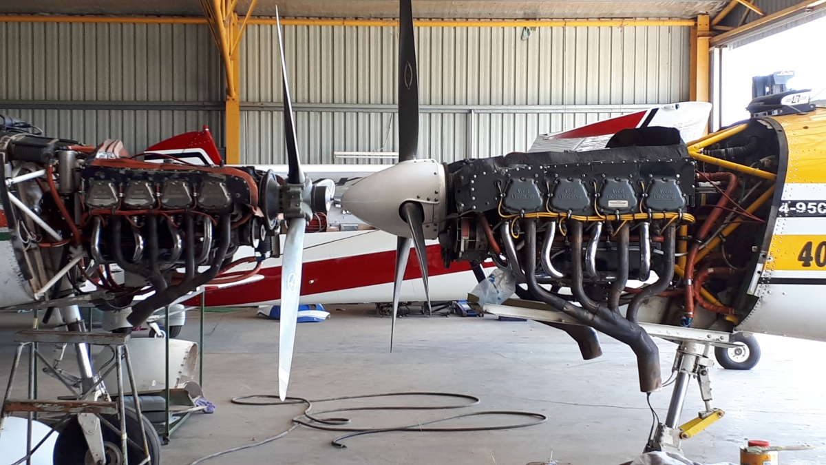

Thruster88 Posted February 20, 2019 Posted February 20, 2019 Lycoming io-720's at 400hp a bit big for recreational flying but they do sound great. 1
facthunter Posted February 20, 2019 Posted February 20, 2019 They do sound good but I don't know how reliable they are. They probably have a few RPMs that are "don't use". Most motors do but not much is said about it. Nev

Student Pilot Posted February 22, 2019 Posted February 22, 2019 They do sound good but I don't know how reliable they are. They probably have a few RPMs that are "don't use". Most motors do but not much is said about it. Nev 720's are very reliable. They will run all day at max continuous. Usual fitment for Fletcher, you wouldn't get a much harder engine life with a take off every 5 or 6 minutes. These engines run to their TBO on AG ops no problem. Trouble is cost of overhauls, very expensive. They do use a lot of fuel but if you want power you have to pay for it. Those in the picture Freddie's? 1
facthunter Posted February 22, 2019 Posted February 22, 2019 They are just the 540 with two more cylinders added, but longer cranks always bring extra problems of torsional vibration damping. Nev
