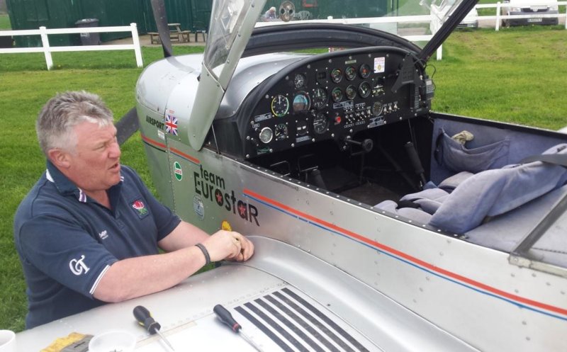

Uncle Bob, attacking one of the school aircraft. . .with yours truly assistingting the operation. ( I've done this before, it helps to know where the feed is ) I bet him 5 Pints of best bitter that the problem was a leak in the pitot feed. ASI was sluggish and under-reading by 20 plus Kt in the cruise ( checked against GPS in nil wind condx. ) rough guide anyway. . .
Found a 50mm split in the feed tube. . . .Just removing the fairing to get at it.
Looks like a good FREE session at the pub next weekend. . all the other experts said that it was partially blocked by dust or an insect. . . ( lucky guess really ! ) All good banter though.

[ATTACH=full]54847[/ATTACH]Uncle Bob, attacking one of the school aircraft. . .with yours truly assistingting the operation. ( I've done this before, it helps to know where the feed is ) I bet him 5 Pints of best bitter that the problem was a leak in the pitot feed. ASI was sluggish and under-reading by 20 plus Kt in the cruise ( checked against GPS in nil wind condx. ) rough guide anyway. . .
I had a split in a nylon tee piece that fed air from the pitot to the ASI and airswitch. Same symtoms under reading , slow to move of the zero. Tecnam sierra easy to get at though.
It can be annoying ! . . That particular Evektor Eurostar is getting on a bit now, a few more hours and it will be a knacker's yard job ! The poor things take a heck of a beating when used for nothing but training don't they, especially ab initio circuits and 'BUMPS'. !. . The wings have been off that one a few times, changing faulty wing root castings due to a Mandatory Mod, and other reasons, so the Pitot tube could have been accidentally bruised earlier. That PVC tubing Does degrade with age of course.
