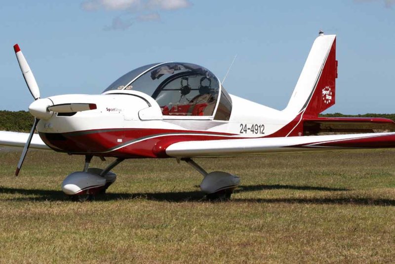

And what is a sporty ? What does it look like? I would like to know what difference it would make to my j230. Spending up to $13000 to find out it’s ,not as good as the sales puff would hurt
They fly amazingly well. Very stable and very predictable. Comfy enough, although I would love some higher backed seats. But that would restrict access to the storage behind the pilots.
