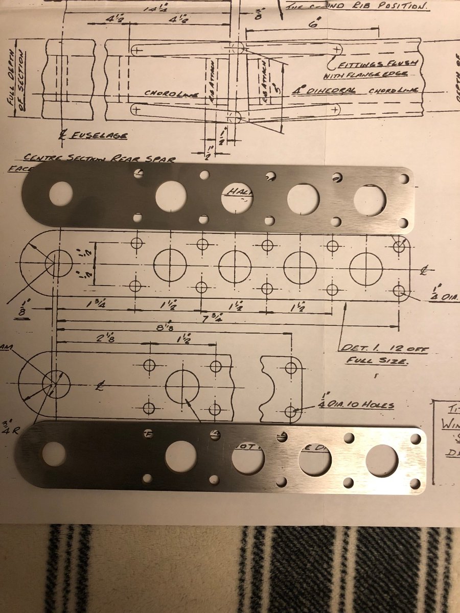

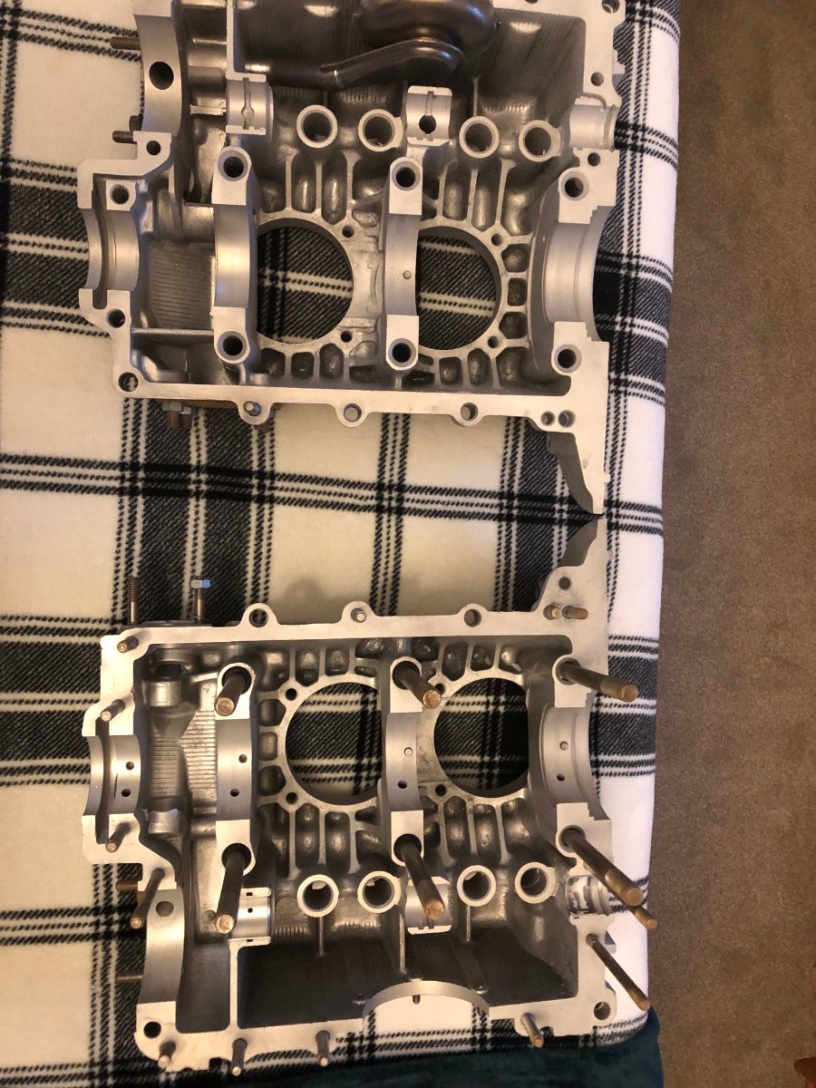

Teggles Posted December 19, 2024 Posted December 19, 2024 Hi Don, Its too cold in my workshop to glue at this time of year so I am getting on with the metalwork. I have got the wing fittings water jet cut. Much better than laser as the laser heat treats the metal as it cuts. Undercarriage and associated fittings are progressing. Engine? After much angst I am going for a VW 1776cc with a 110 or scat 25 cam. Single port heads with 1:1:1 rockers. This should give enough power but the torque will be lower in the rev range. The case has been vapour blasted, now to get a line bore. 1
facthunter Posted December 19, 2024 Posted December 19, 2024 You want to make sure that is done very accurately. Are you decking the block or using oversize OD bearings? Nev
Teggles Posted December 19, 2024 Posted December 19, 2024 It’s with a specialist VW company. I’m not that good! 2
