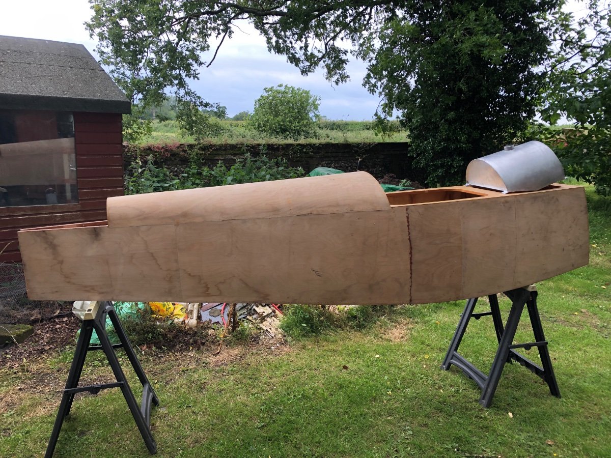

My Taylor Mono is a project started in 1978, so now it is part restoration and part build. Here is the fuselage with my new fuel tank. Yes the sides are on and no controls or anything fitted inside, which will be a challenge! There is some water staining but it is just a stain, no problem with the ply. I also have a rudder, which is OK, elevator - ok, tailplane which needs some work. Spars, 2 of which need some restoration, wing ribs which seem ok and a few  odd bits and pieces.
In the U.K. we are quite strict with materials and the design. Any changes needs to be submitted to our regulator for approval, so we don’t have the flexibility you have in the U.S.

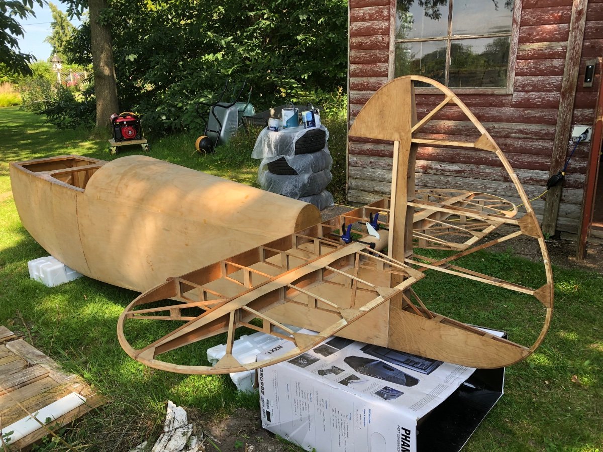

A bit of an update. For some context my workshop is a large (dry) shed at the end of my garden. It’s large by shed standards but small for aircraft building. I normally put the fuselage out side and then I have plenty of room to work away. But, the weather in the UK has been awful this year, constant rain. We have a weather warning for heavy rain as I write; so progress has been slow due to cramped working conditions.
Damage to a spar has been cut away and I will laminate a  new piece on. Vacuum bagging seems the way to go and I have found a kit for only $100! Ouch, but it should work well.
Metal parts are slowly being fabricated and I have this fantasy that soon I will have all the required parts and it will just need bolting together. Dreams I have dreams.

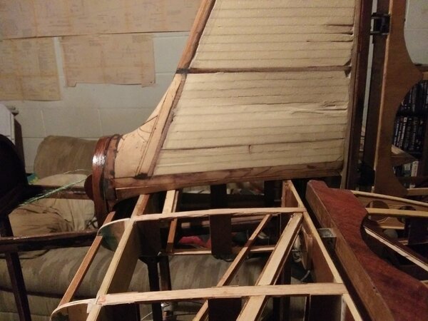

Teggles I can relate to a small work area as you can see in my post. I was able to do all fuselage work in the basement but could not secure the root spars because of limited space to remove from basement. What metal parts are you in need of? I do have an extra set of wing attach fittings from a KR-2 and they are the same as a Taylor monoplane per prints. Let me know if I can assist in any way. Don

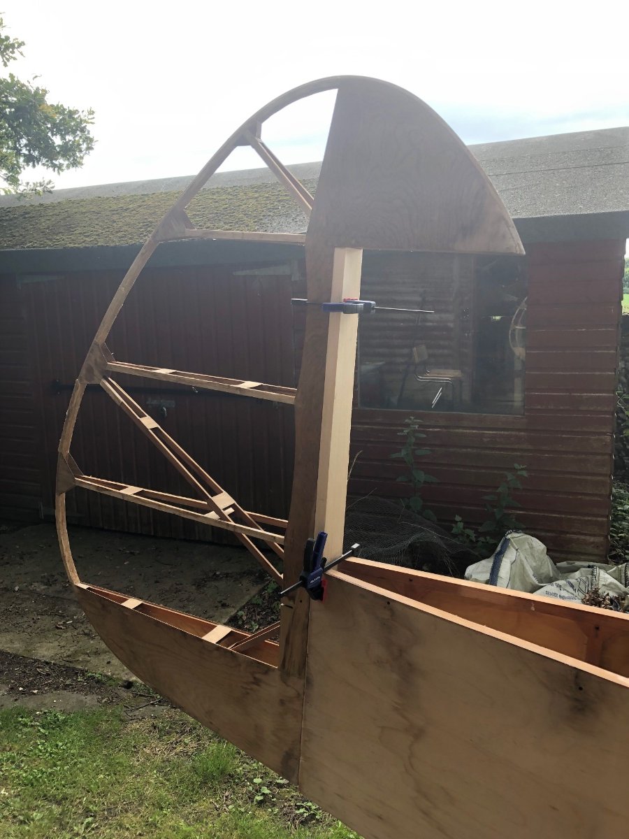

As this is a partially completed project, I have undo some of what has been damaged or built wrong. Today is the rudder post, cracked with 2 big wood screws holding it together! Just 4 mortice  joints, no problem except they are coming together at several different angles, nothing square 😩 but it is done, not glued yet and it’s vertical!

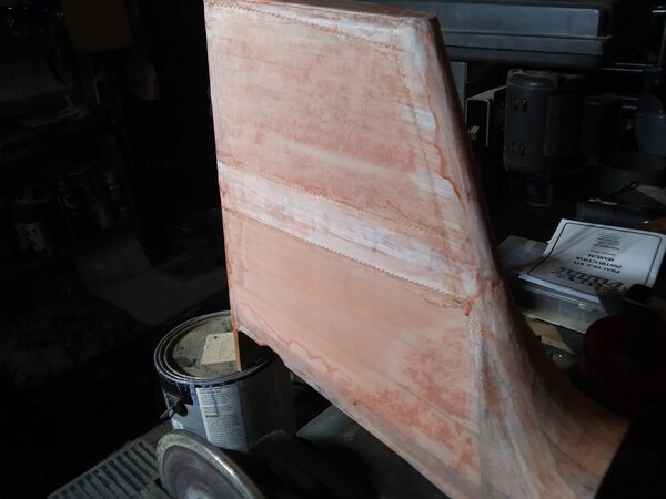

As you can see in the photo, I took high density foam and stacked glued it into the inside of fin with the hopes it will help keep the cockpit accessible if plane is on its back. I believe a roll bar just behind the head mounted in the hard point of seat belt will be incorporated in my build also. With these two added safety features in a nose over in dirt or mud your chances are 2-x better to get out of the plane. Plus, no need for ply covering the fin if made solid with foam and med fabric.
