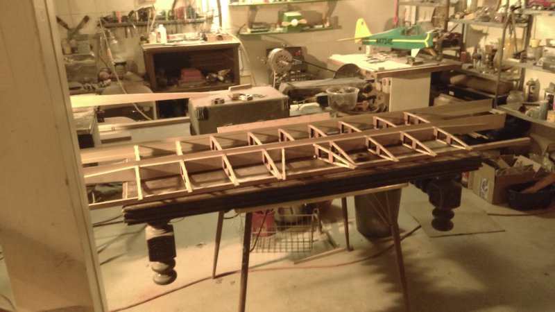

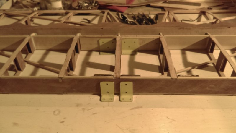

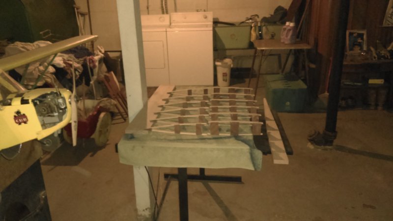

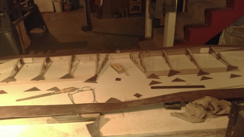

Just want every one to know I'am building a Taylor in the upper midwest of USA and I think the only one being built at this time in the states. Here is a few pictures. If any one has built one and want to share ideas please contact me. Don 101_thank_you.gif.0bf9113ab8c9fe9c7ebb42709fda3359.gif1367840680_taylorfus.jpg.712e0f7f6f00a668cda9b51109d035c0.jpg

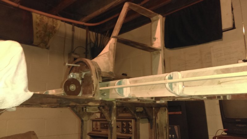

I hate to use up Forum space but thought it would be nice to show some build pictures of my Taylor- Mono for future builders can see. I will start with some of my first Pictures. 950827537_rudder4.jpg.f1f05f1e718be66216cff35bf912e084.jpg

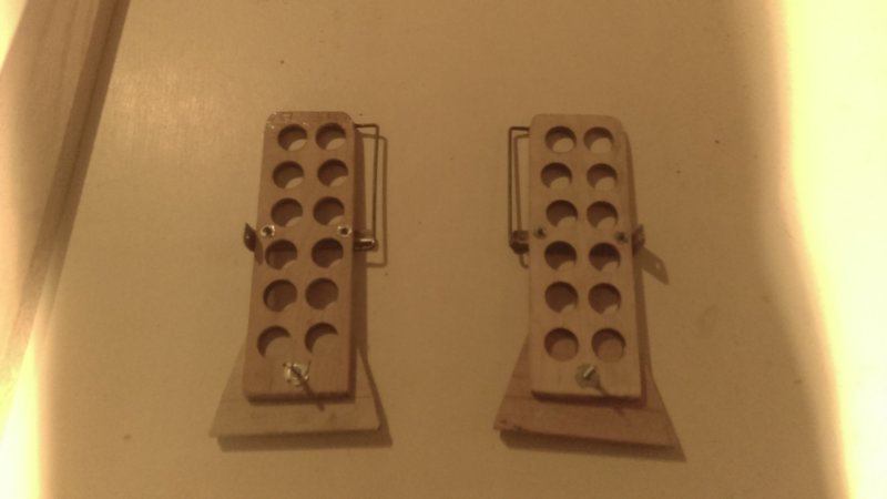

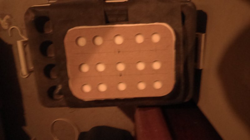

tried my luck at some seat and back rest. Drilled lightening holes to save weight I used the floor out of a child day pen and man what strong stuff. not touch it my hans 1005267488_seatbase.jpg.85db33cb7ed8b1f2db8588f9a02b0b54.jpg

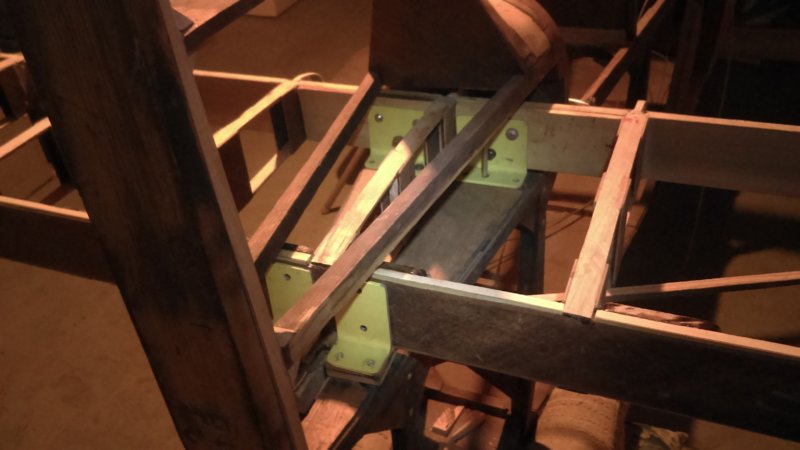

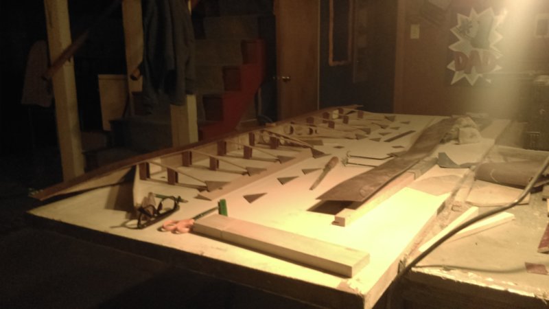

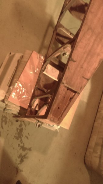

I got my Horz,Stab mounts bolted on and I must say what a pain in the a$$. I immediately changed to a way that I fill is much stronger and of near the same weight. I inverted my fuselage and glued in Maple hardwood blocks under the ply that is bellow the Horz. stab. I added 45 degree strips to strengthen and put 3 each side on each blocks 2 inch Stainless steel screws horizontally into the upper longeron and up right. I then made Alum angle mounts with the option to set incidence +/- if desired. 106578159_blockHorz..jpg.20c49e0d8b6f5faf8b12b05257bb5c52.jpgAlso gets the tail wheel in a good work position.

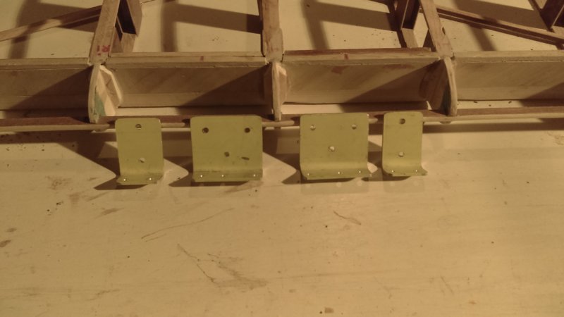

In my last post I spoke of changing mounts for the Horz. Stab and I made up 4- 6061 T-6 Alum brackets from a wrecked Ag Cat near my home. Also while the Fuselage was inverted I wanted to get a picture of those pretty lines the T-mono has on its under side. 012_thumb_up.gif.cb3bc51429685855e5e23c55d661406e.gif 1207735567_newstabfittings1.jpg.58cc8422c00ade253493f57ed856eff6.jpg

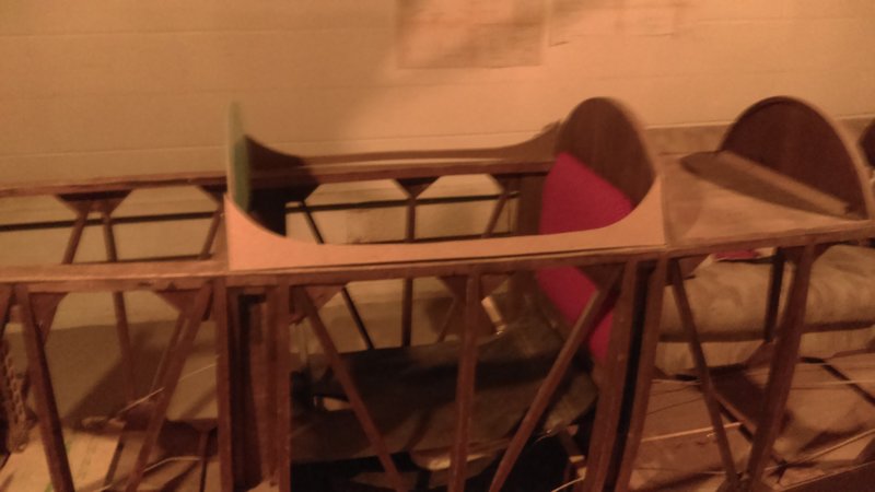

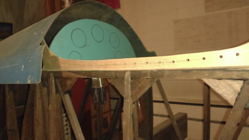

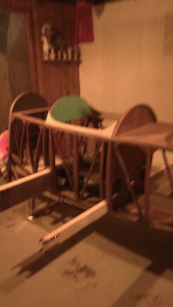

Getting a bit closer every day. I started to form in the cockpit skirting and got the Horz,Stab bolted on. Soon I'll sheet the Horz with ply and focus on elevator hinges327660433_cockpitside1.jpg.b1a01aa81707bb29a42308bf180c14d4.jpg

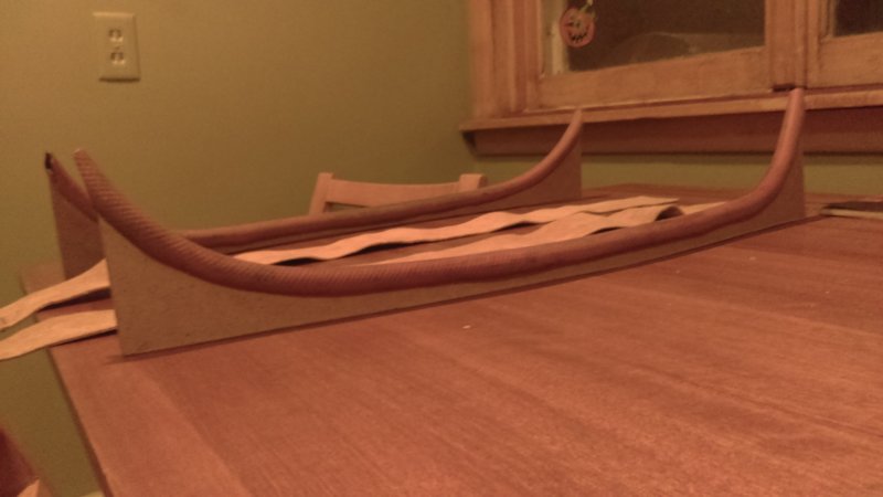

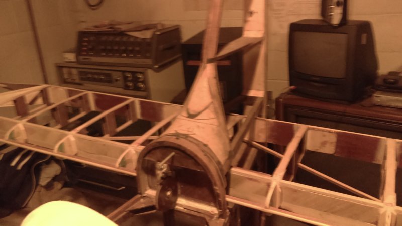

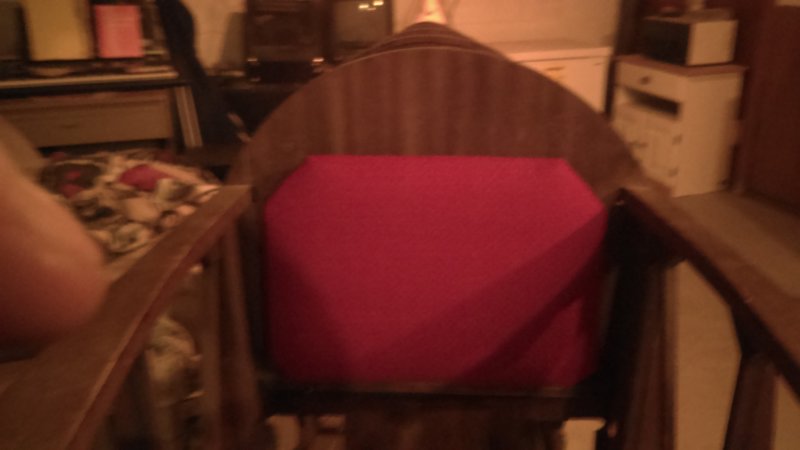

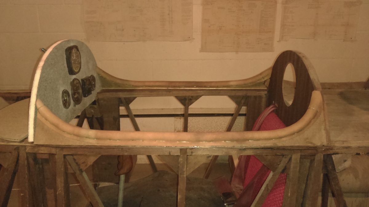

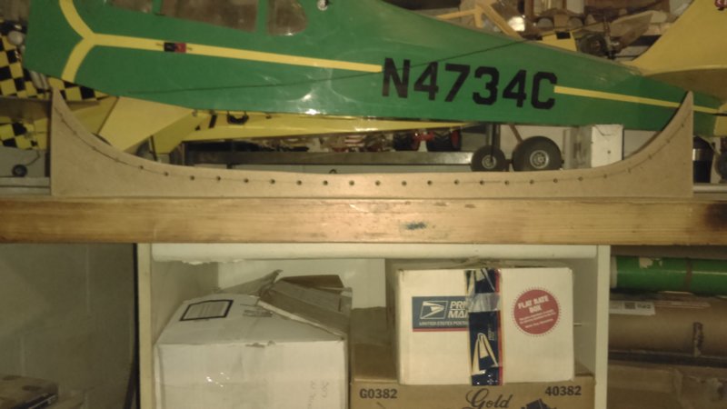

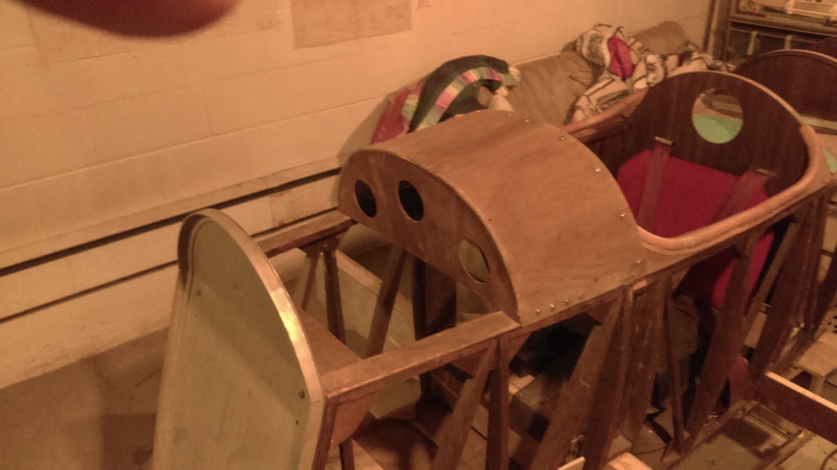

Been working slowly on the trim of the cockpit I made these what I call cockpit side skirts and will sew on with leather foam inner and leather capped. Also a shot of tail area.IMAG0625.jpg.0b8013584599d913599cac21cc4c3675.jpg

got a little closer to the cockpit opening. I found 1/2" air hose worked well for the filler pad and a soft leather to cap off with once the skirts are glued in place. I think this tan color leather will go good with the aircraft.1770680452_cpskirt2.jpg.24c993fd30208660e2cd04af20dda2fa.jpg

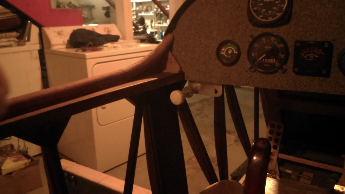

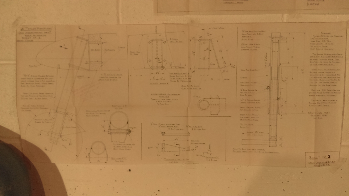

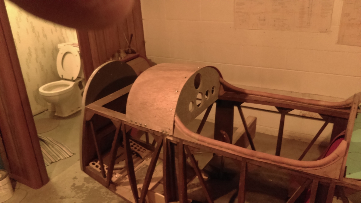

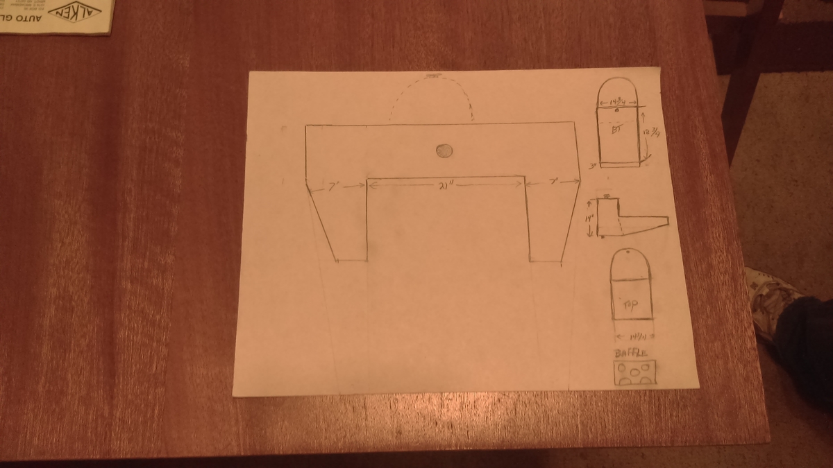

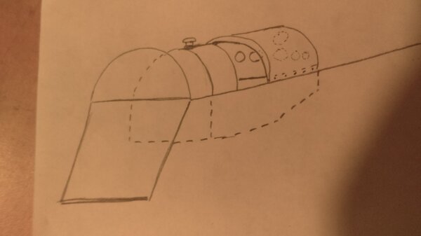

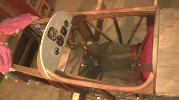

I have been working on fuel tank position along with making my instrument panel removable after top cowling is removed this is a bad sketch of what I have in mind.  Top Cowling will end just in front of wind screen. Appears I will need to remove 2 inches off the width of upper and lower cowling and I believe a piano hinge down the center at top with cam locks along the cheeks will do a good job. Plenty of room for a 1835 VW engine under the cowling with exhaust running out under firewall. A little every day. 012_thumb_up.gif.83e1b5422694a022eec36e1e8343f687.gif

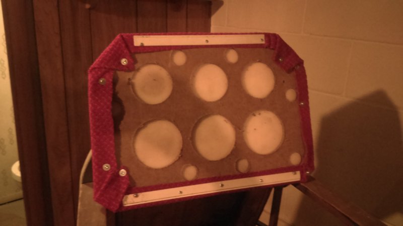

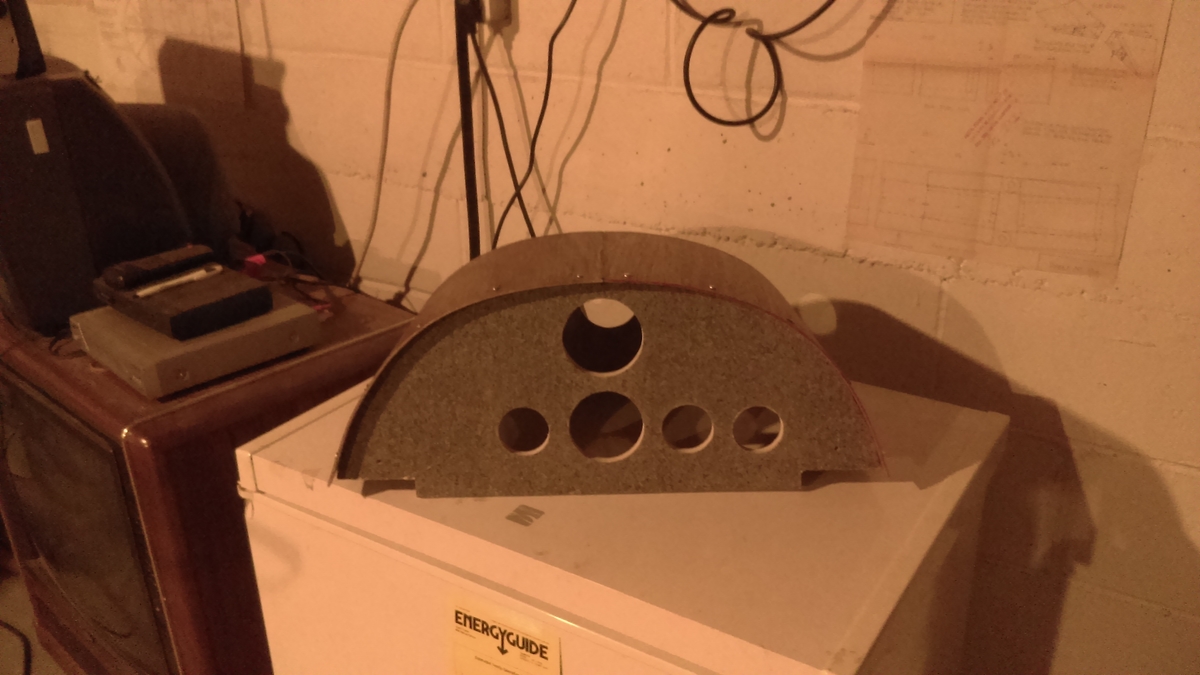

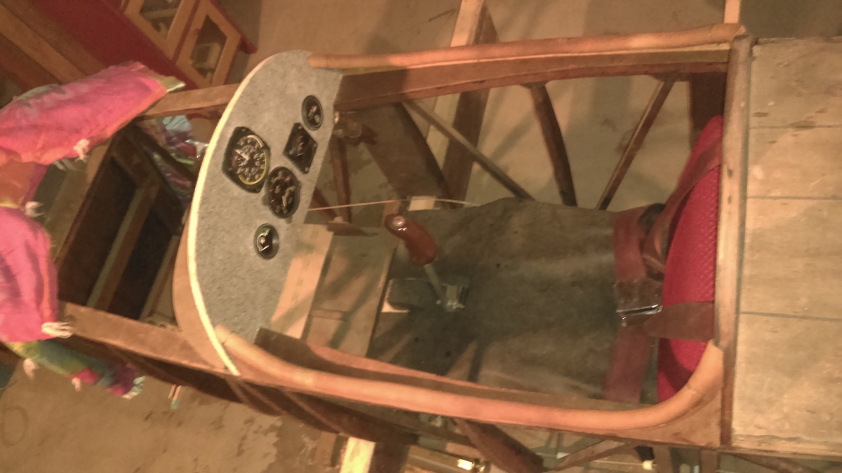

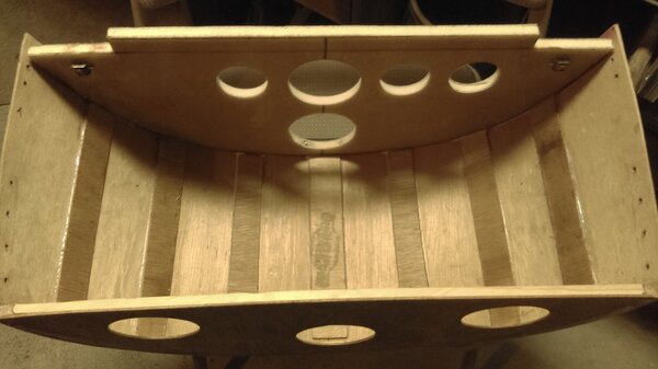

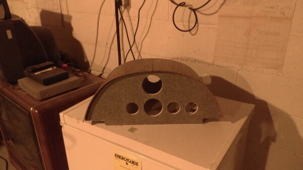

185204063_dashbox1.thumb.jpg.b0abef63290e1097743ac3e407bf174d.jpg Instrument Dash box  finished. Man what a job to get that ply to form curves in such a short distance. Will be nice to pull Dash out and service and replace instruments. It's very light and strong. will be adding padded leather to top of panel for safety so I left 5/8" overhang above instruments. 14 SS screws required to remove and top cowling. Fuel tank and wind screen is next. When taking a straight edge laying on top of the box to the firewall I landed within a 1/16 of an inch.  A bit closer every day
Thanks planedriver. I almost forgot to add a picture of the underside of my dash box. I ran strips of ply 90* to the other and epoxied. This gives me 7 hard points to mount wind screen and the whole box weighs about the same as a beer.☺️ A pounder that is

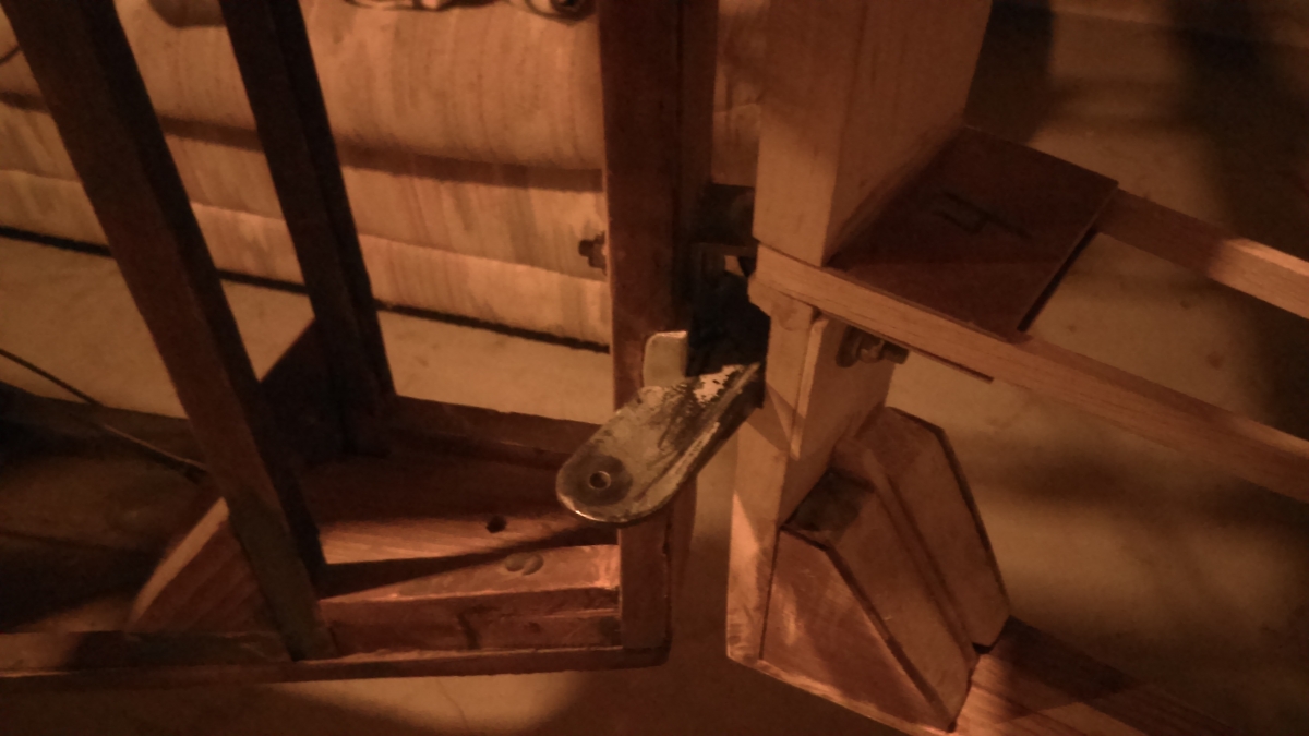

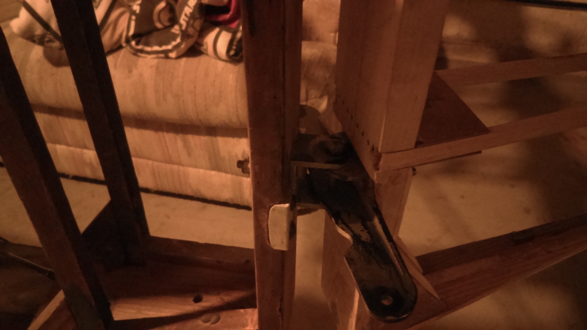

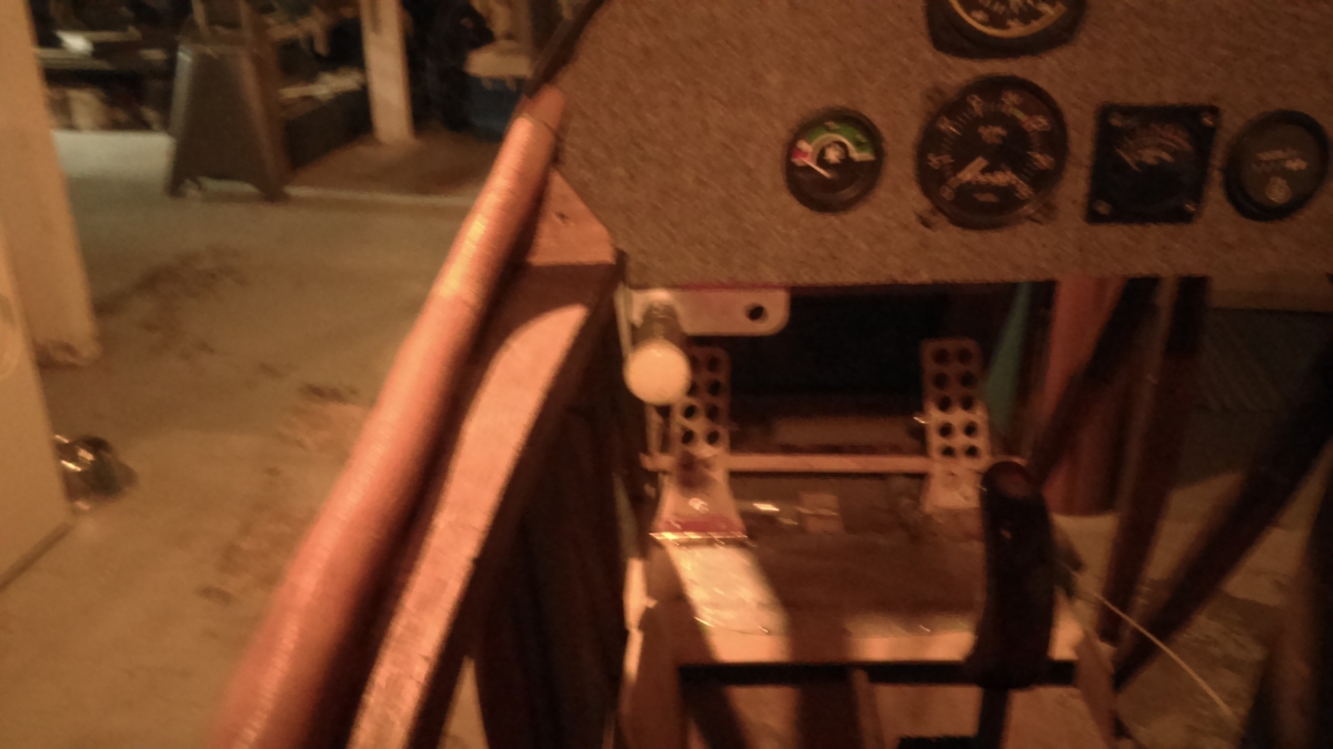

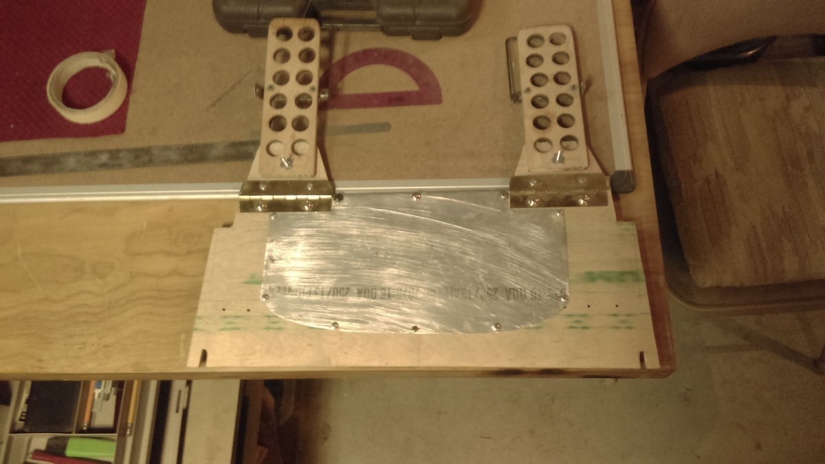

worked on rudder horn and rudder pedal stops. and working on getting the full throw stop timed were there will be no stress on pedals at either end of the system. Also added a T-6 Alum plate on my rudder base plate to help with wear from heel movement from brakes. I'm just plugging along and making a lot of plane noises in my head. 012_thumb_up.gif.83e1b5422694a022eec36e1e8343f687.gif

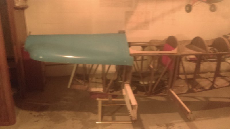

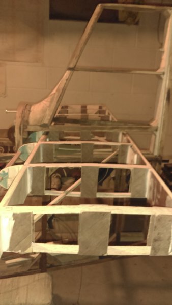

got the throttle bolted in place. Soon will start the final covering of ply on Fuselage

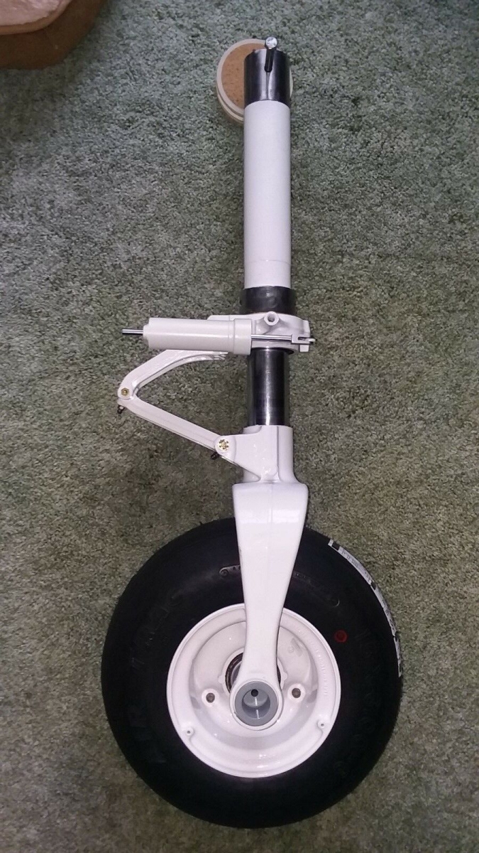

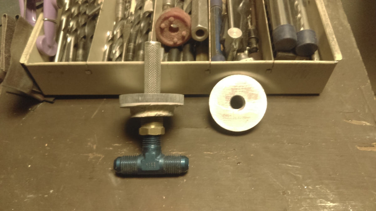

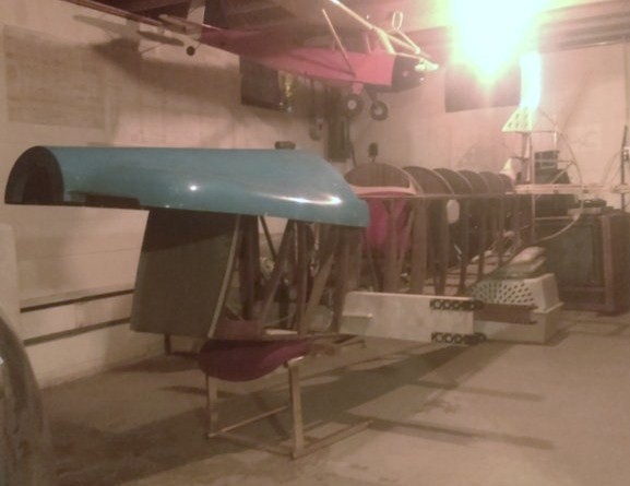

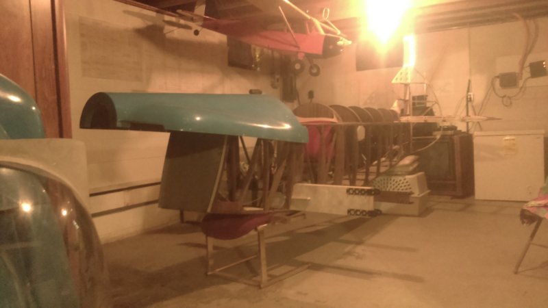

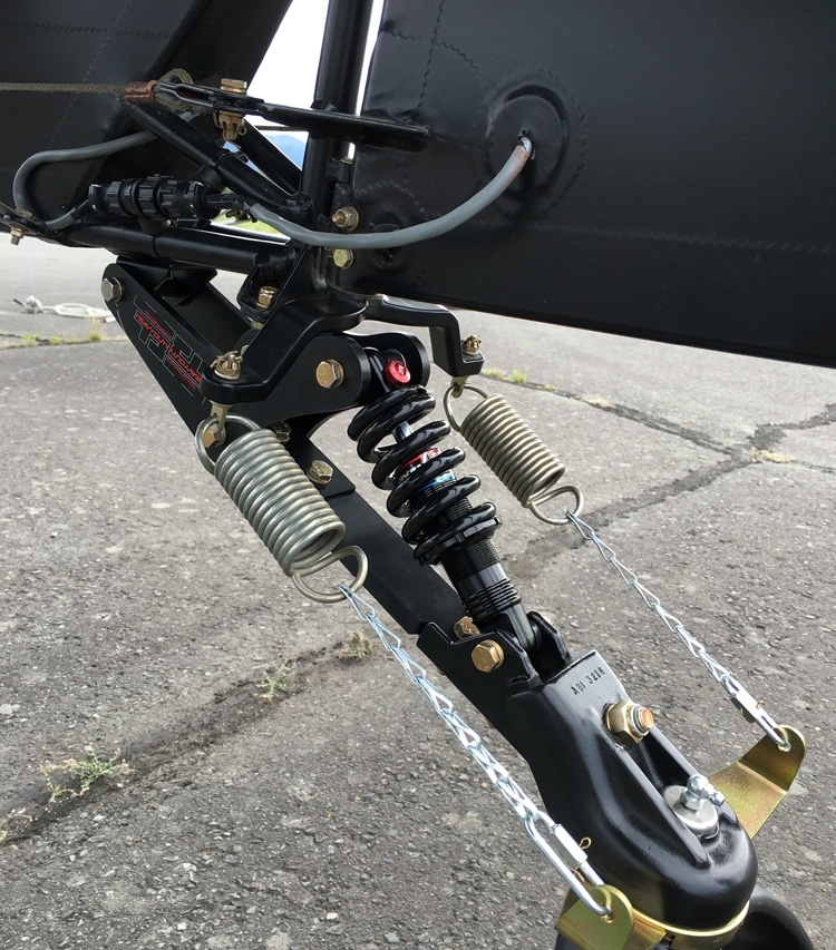

A fello builder donated a Maule tail wheel to me and with luck I can find a 4"- 5"1192557268_cessna2.thumb.jpg.feede6541d70ee46523fac9db685043a.jpg wheel to fit axle and if my drill bits hold up I can get a couple holes drilled into the KR-2 spring and have a Tail wheel on the Taylor-m. I'm contemplating on how a couple of nose wheel main strut off a Cessna 150 would work with the right spar plate welded to them for main gear??

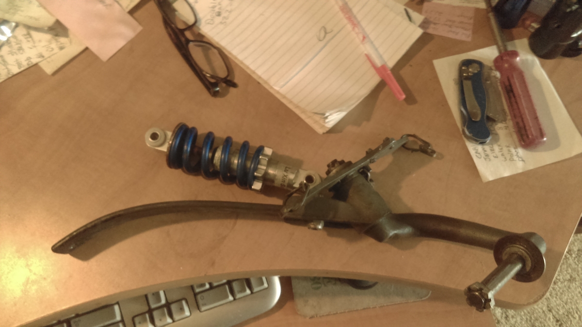

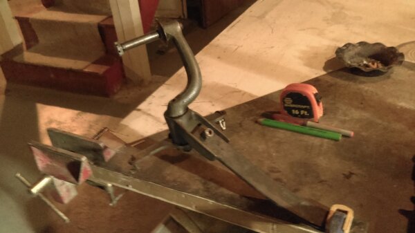

Been working on the tail wheel and have found this to be an interesting set up. So I gathered up some parts that I may be able to get to work and have some dampening adjustment on the tail spring
