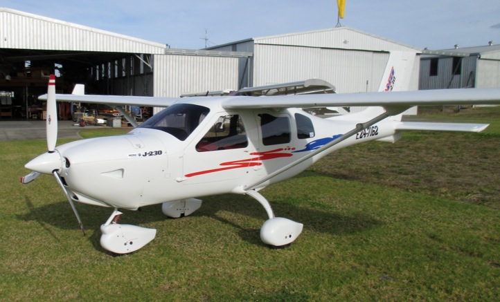

pylon500 Posted November 18, 2017 Posted November 18, 2017 I don't want a jabiru engine anymore Both 55- and 24- are certified level, and if certified with a Jabiru, that's what you're stuck with. If you change the engine in a 55-, it would end up as a 19-. If you change the engine in a 24, you could end up with an E24- or 19-, neither can be used for training. There may be some Jabiru airframes with Rotax engines going or gone through the certification process, but you would have to talk to RAAus tech. JR-230, note E24- rego

pylon500 Posted November 18, 2017 Posted November 18, 2017 Pylon (I prefer to be called Tripod, but different strokes and all that!) : Am I correct in thinking that a JR-230 is a Rotax powered Jab? I always thought that the Jab airframes were pretty good. Coupled with a Rotax engine and you'd have a really noice plane.BTW, I just tried to go to your Picasa page, but got the dreaded 404 Yeah, I did the test flying of this install. Being a 230 it flew pretty well, the 100hp ULS give basically all the same numbers,although climb one up was nearly 1500fpm. You could also climb at 60~70 kts and not overheat, but the main improvement was (scratching my memory now) 115kt cruise at 16~17 litres per hour @ 5000rpm. As for the picasa page, google changed things a few years ago and I didn't keep up. Try this link to the archive https://get.google.com/albumarchive/113292981019876413104?source=pwa but not sure if it will work? 1
