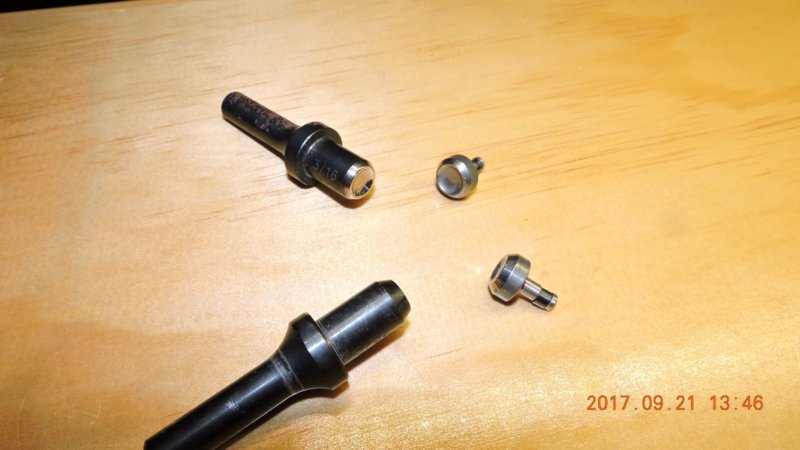

Head in the clouds Posted September 21, 2017 Posted September 21, 2017 Are they counter sunk flat head rivets? If they are you could back rivet them. You will need a bit of heavy steel plate or flat. Or even a bit of steel RHS or SHS. With the panels sitting flat, drop some rivets in, run a strip of tape along over the rivets to hold them in (paper type tape like masking tape). Then turn the panel over and carfully place the new rivets on top of the heavy steel plate, the plate now becomes the bucking bar on the head side and this allows you to carefully use the rivet gun to squeeze (hammer) the other sideBob Universal head unfortunately (rounded). So the gun has to go in front. Hi Marty, actually the gun doesn't have to go on the rivet head, even with universal head rivets. I saw your plea for help previously and was going to send you my rivet tools but don't have them as small as 1/8", mine start from 5/32". Anyway, see the image below - and what you need for the rounded rivet heads, if you want to hammer the stem, or press it in a shop press, is the small tool shown to the right. I'm not sure what they're called but you drill a 3/16" hole in a piece of heavy steel plate and sit the stem of the tool in the hole and the rivet head in the dimple then hammer or press the stem of the rivet.

Marty_d Posted September 21, 2017 Author Posted September 21, 2017 Hi all, Thanks for the advice. If you are getting sore shoulders I would think you are too tense. Yes I think you're right... M61 also said I didn't have to push the dolly so hard, so I backed off a bit and it's gone a lot better. I'm about to put up a couple of photos on my 701 build log so won't repeat them here, but have finished one side (106 rivets). One to go! I saw your plea for help previously and was going to send you my rivet tools but don't have them as small as 1/8", mine start from 5/32". Thanks HITC, I think the main problem was I didn't know the Australian suppliers. Someone put me on to Henchman and I got my tool within a few days, and it didn't break the bank. Would've been about the same cost to return post your tools back, and this way I get to keep it.

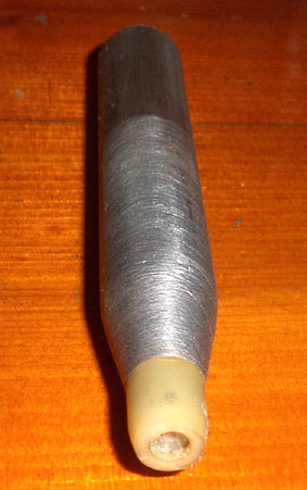

Oscar Posted September 22, 2017 Posted September 22, 2017 For what it may be worth.. I flush-riveted my plenum chambers, many of which were in tight areas, using 1/8" . I ended up, after considerable frustration, making up the small bucking-bar tool in the piccy: A bit of 1/2" decent steel rod ( very quickly turned down, no fancy polishing!) with a 'tit' on the end of 1/4" diameter. A small length of 4mm or so diameter pvc tube projects just enough past the end 'tit' to locate over the rivet shank, and I have a couple of bits of short steel bar with a 3/4" drill indent so I can grip the 'bar' itself and the extra weight in one hand. The pvc tube deflects enough to set the rivet very firmly and you don't have to watch out for it slipping off the rivet shank, as it (obviously) self-centres. So you can concentrate on the tool position against the head, which I found a great assistance for flush rivet work. 1
Marty_d Posted September 22, 2017 Author Posted September 22, 2017 For what it may be worth..I flush-riveted my plenum chambers, many of which were in tight areas, using 1/8" . I ended up, after considerable frustration, making up the small bucking-bar tool in the piccy: [ATTACH=full]51941[/ATTACH] A bit of 1/2" decent steel rod ( very quickly turned down, no fancy polishing!) with a 'tit' on the end of 1/4" diameter. A small length of 4mm or so diameter pvc tube projects just enough past the end 'tit' to locate over the rivet shank, and I have a couple of bits of short steel bar with a 3/4" drill indent so I can grip the 'bar' itself and the extra weight in one hand. The pvc tube deflects enough to set the rivet very firmly and you don't have to watch out for it slipping off the rivet shank, as it (obviously) self-centres. So you can concentrate on the tool position against the head, which I found a great assistance for flush rivet work. I like that idea of the PVC holding the rivet shank in place. Nice work. Unfortunately I don't have any machining capability but I might try it with a length of reo.
